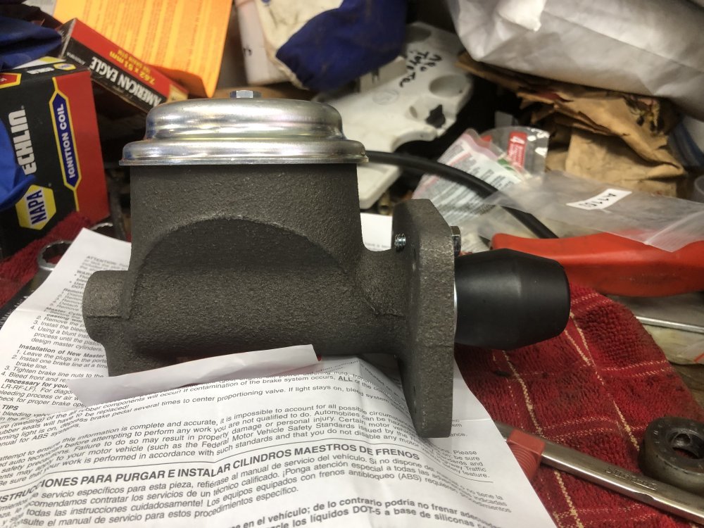

Heading to the vice with my old fashioned plastic bench bleeding fittings and hoses.
I do not see anything special about this new master cylinder that would make it any different than any other master cylinder that I have purchased new, or rebuilt myself.
Single piston master cylinder for the 59 Power Wagon.

No different than what I have always done except I always used the provided bench bleeder fitting/hose kit.
And the instructions is mentioning a stepped master cylinder. This one is just a straight bore unit, so, here goes.

I bench bleeded it with the old fashioned hose kit.
I plunged the piston just enough to emit bubbles out the piston feed ports. When no more bubbles appeared in the reservoir then plunged slightly deeper, repeat until the piston was near bottom and no air emitted from the bleeder hose or the on the reservoir piston feed ports.

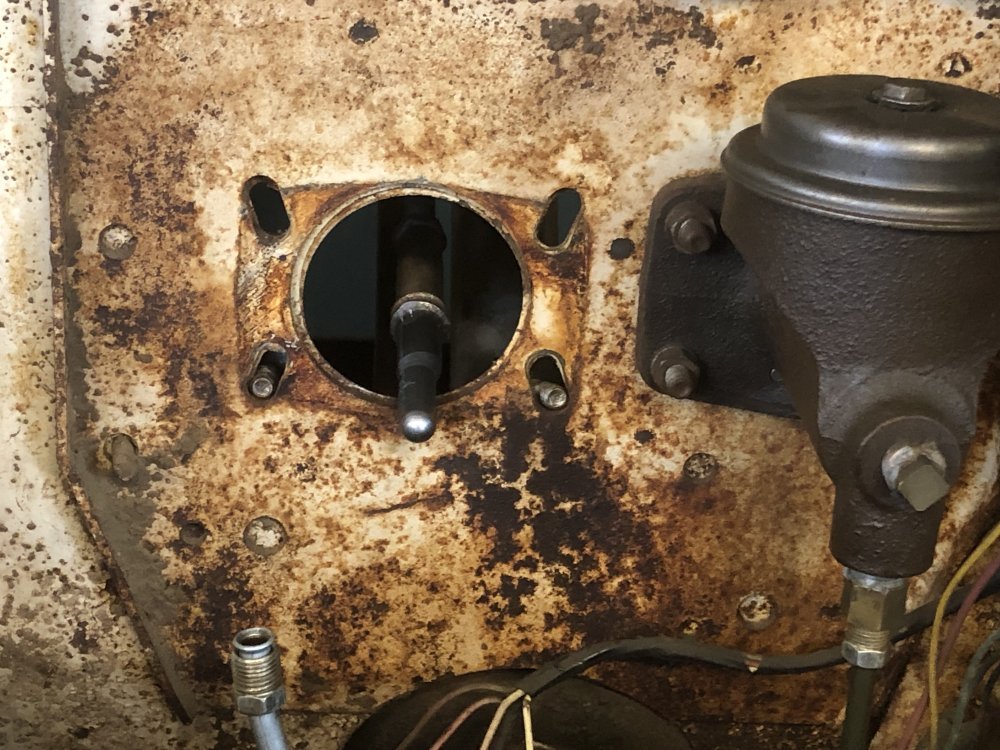

I tried installing it lone wolf style.
Nothing doing. Could not get the master close enough to the bolts to get a nut started.
Now waiting for the son to come over.
