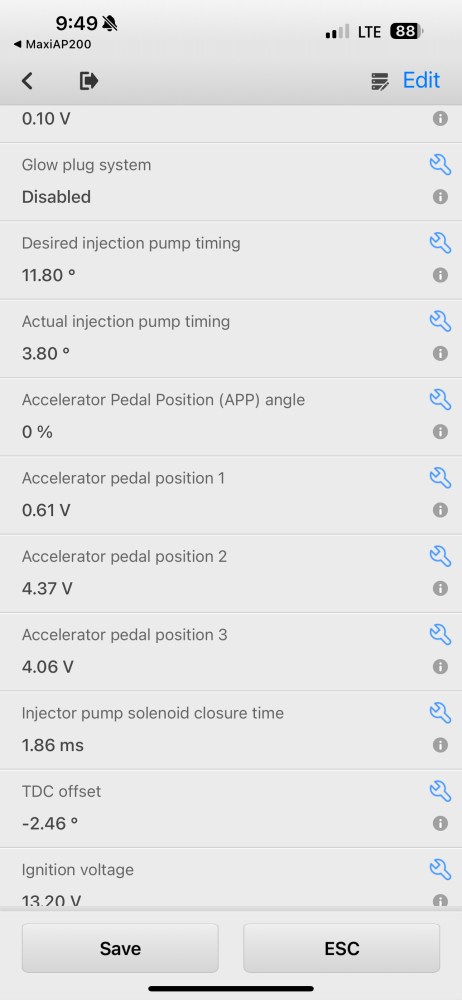

Your actual timing of 3.8 is getting you default TDCO of -2.46. You won’t get a TDCO less than -2.46 until you get actual timing at 3.5 or less.New numbers after relearn.
Guess I’ll back it down just a little.
If about -1.90 is the sweet number then I’ll shoot for that or slightly lower.
No. Rock steady.I would think the offset is a little high, mine being a obd1 won't go over -1.99 before setting a code. I have it set iirc at -0.7 and it seems happy.

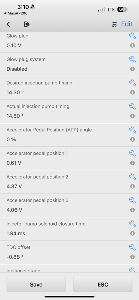

Yes, still on the -0.88.so long as you connected the same wires to the wire on the connector that shouldn't make a difference on how it runs. are there any codes now with it running rough? might try to get it back to the -0.88 that is a good medium setting. from reading on the innerwebs folks are saying anything over -1.94 is too much.
