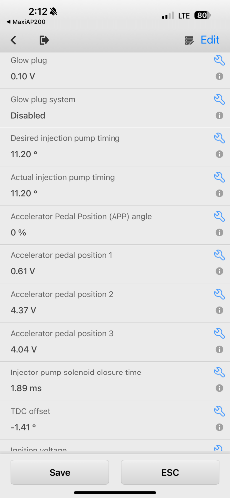

If the injector timing is suppose to be about 30*, how does a person acquire that without changing the timing off set ?
I dont remember what actual injector timing was previous to removing the IP from the old engine.
Have you ran the offset learn now that the new engine is installed? the general rule of thumb is to do the time set first and see where the actual injection timing is at. adjust (with engine off) till you get as close to 3.5 as possible, then run the learn function. if your already done the learn and it settled at -1.41 then your golden if that is were you want the off set to be. The PCM adjusts the actual timing with the stepper motor on the optic sensor. in essence that is your auto timing advance under the various loads. all PCM controlled.
On OBD2 you don't need to do the 3.5. You can go straight to the TDCO learn and then adjust the pump if you need to. Also you can get a range of readings from each pump adjustment so just because you don't see the number you are looking for doesn't mean the IP needs to be moved. There's like 4-5 numbers that can be had. Just keep doing the relearn until you see the range of numbers available

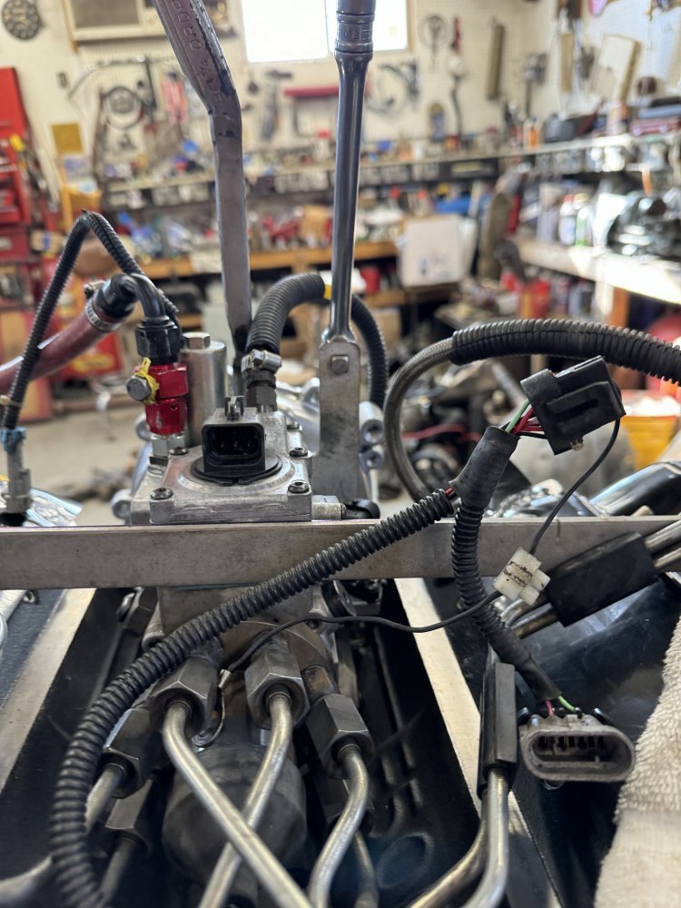

@Big T suggested that I turn the pump more to the passenger side. I now have it setting slightly canted to the drivers side, thinking a little advanced is where I like to run them.
That -1.44 seemed to be pretty good, although a little more pre ignition knock.

I have the Autel MaxiAP200 reader, that covers all the live DATA and clears codes, etc, and a bunch of other operations that I’m not comfortable messing with. I think. 😹
After I get the drive pressure gauges installed I will get back in and do the relearn with the old ECM to verify where it now is set at.
Maybe first I should rotate the IP CCW facing front of engine, as suggested by Big T.
