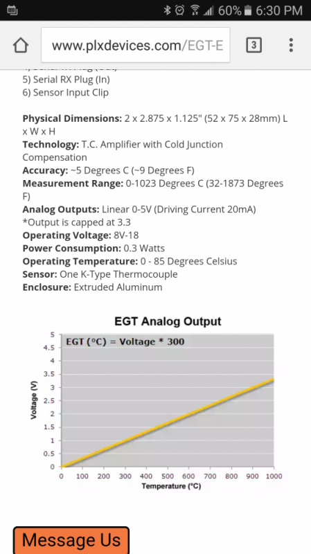

I just got my multi tester with millivolt output. I tested my pyro gauges and figured out where they read at what voltage. Do all thermocouples read accurately as to output at temperatures?

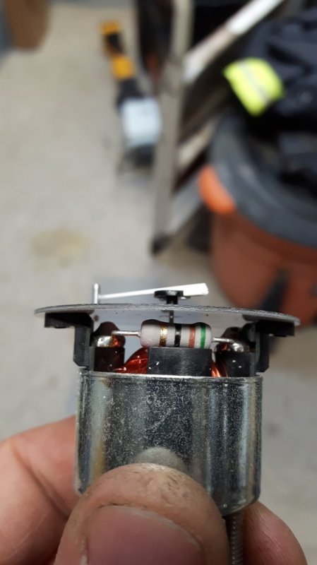

As a beside, I opened up my old Isspro TurboMax gauge I thought was bad. Found a nut and a screw in the egt half, stuck to a magnetic damper. Now I have two of the Isspro, old style and new.
The banks gauge was wacky at first, but then after a run up and down the scale, it's good too. I'm the owner of three egt gauges. The numbers were further apart at the bottom of the scale and close at the top.
Maybe isspro will take the new one back?
As follows,
MilliVolts- Banks temp- Isspro temp
.001-225-
.005-400-
.010-625-400
.015-825-725
.020-1050-1000
.025-1300-1300
.030-1500-1550
As follows,
.001-225-
.005-400-
.010-625-400
.015-825-725
.020-1050-1000
.025-1300-1300
.030-1500-1550
