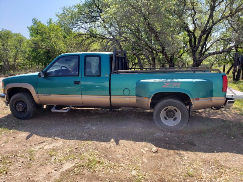

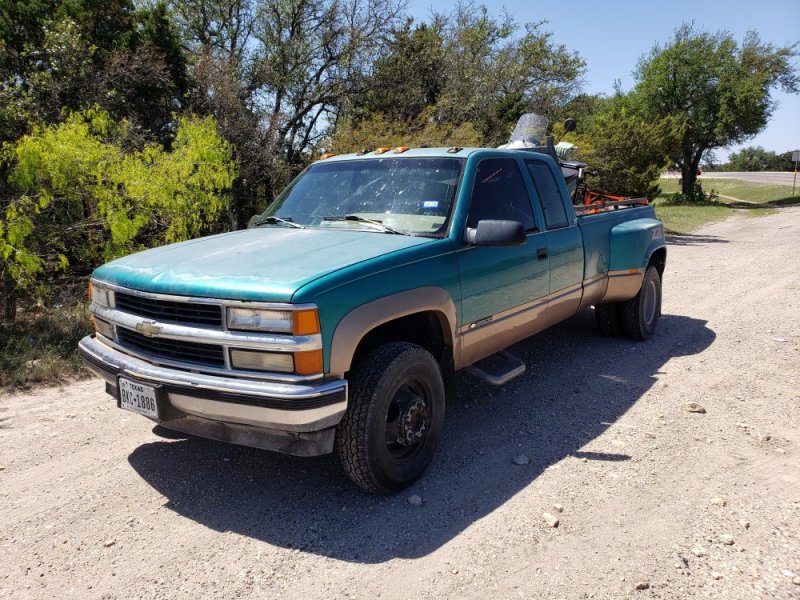

Nice truck red, if it wasn't so far I have a paint matching box that could be had for reasonable, fairly new tailgate as well. Looking again the color may be different, mines Teal Green, blue and green can be hard to discern with lighting.

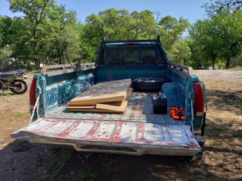

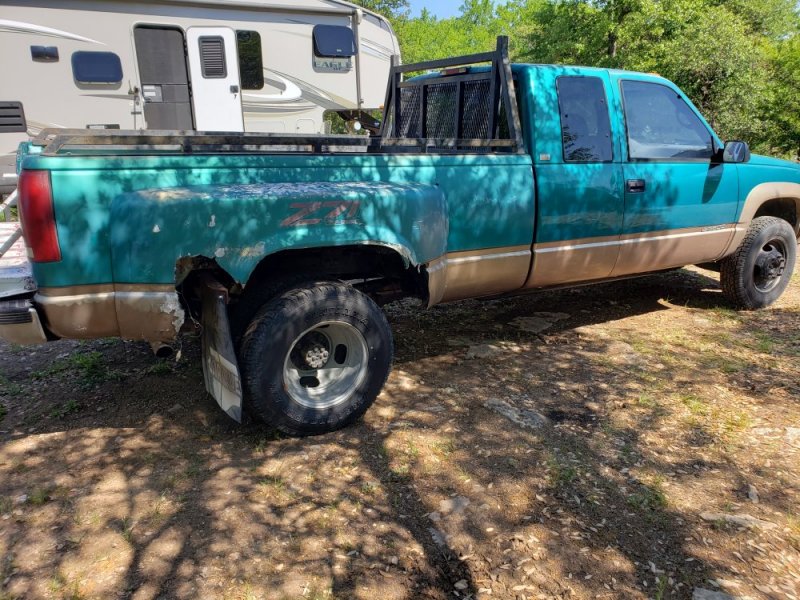

Agreed color can be off in pictures. It's the teal green color up top. Still undecided on bed plans but I have a feeling that a flatbed or utility bed of some type will be the better option for me. Truck will be used offroad and being a dually the bed rails will make contact with rocks/trees from time to time.

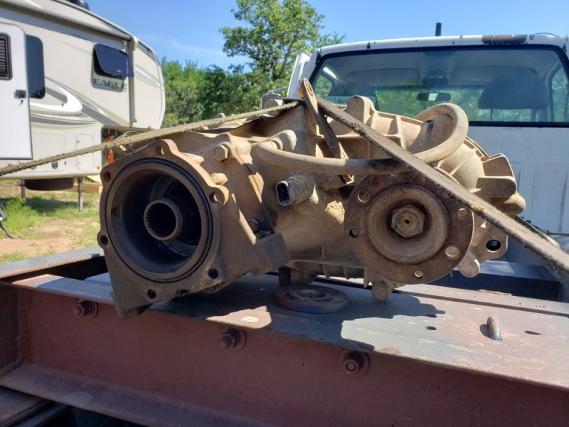

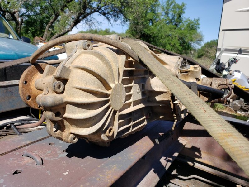

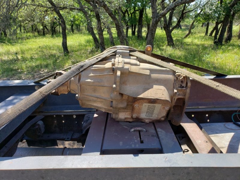

Been taking my time removing the tcase due to weather and just not being in a rush to do the job haha. Only thing left to drop it is remove the transmission mount, unbolt the tcase, and lower it down. Oil in the tcase looked like the right level or maybe a little low but nothing crazy.
