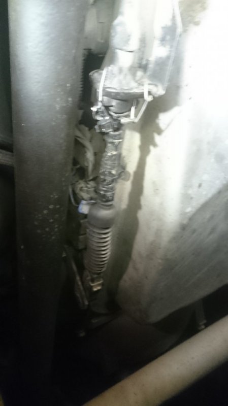

i managed to break the guide thing on the trans end of the shift cable when doing a fluid and filter change, don't ask how, i probably stared at it too hard ;)
is there a writeup on this somewhere? if not, any tips for doing this.
is there any adjustment needed after replacing the cable
is it more work than it seems or is it just a PITA because it looks like i'll have to pull the driver seat and lift the carpet some to get access to the cable.
any tips on this is greatly appreciated as this is my daily driver and it's really sticky to shift through PRND because of my quickfix that consists of electricians tape, zipties and steel wire :p
It's just a PITA job. No need to pull the seat, but you do have to pull out the kick panel and door sill, then you can lift up the carpet to get it out. And yes, you will have to adjust it after replacing the cable.
