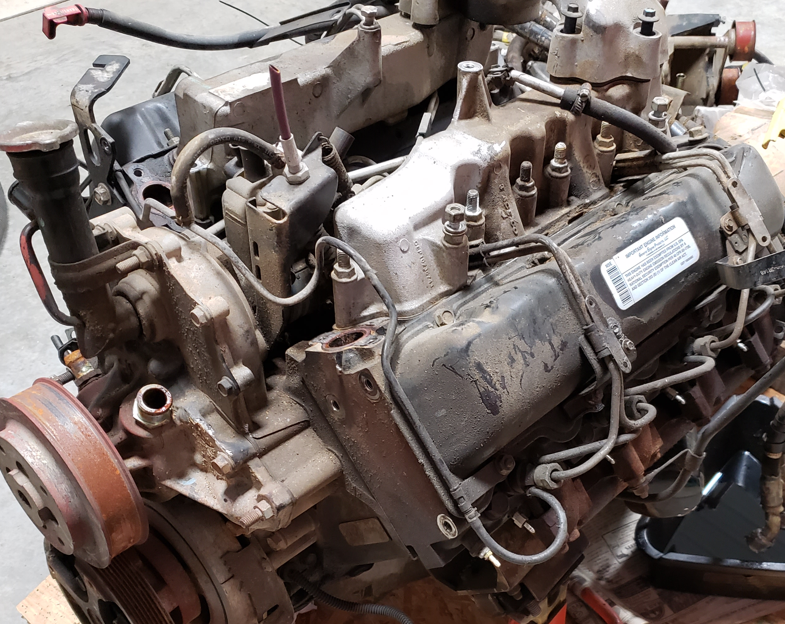

@SnowDrift can't recall if you use facebook or not but here's a guy parting out a '93 6.5 so it should have the throttle cable and throttle cable bracket for the DB2. If you're serious about going mechanical it wouldn't hurt to see if he has the necessary parts and would be willing to ship them to ya
That bracket looks like it was a non cruise option. there would be a second slot for another cable off to the side.
