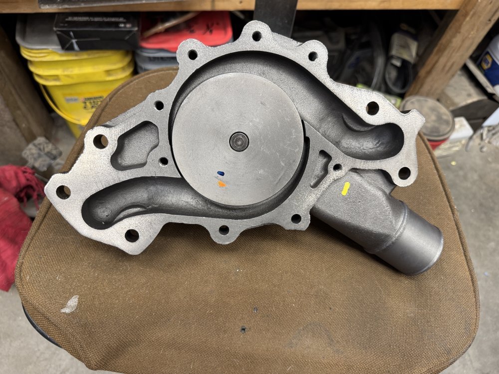

A new coolant/water pump will be here today, ordered a new AC Delco, by part number once again.
And so I will look that pump over and if any thing about that pump looks amiss it will go right back. I will pull the pump from the old engine and install that on this new engine for testing purposes.

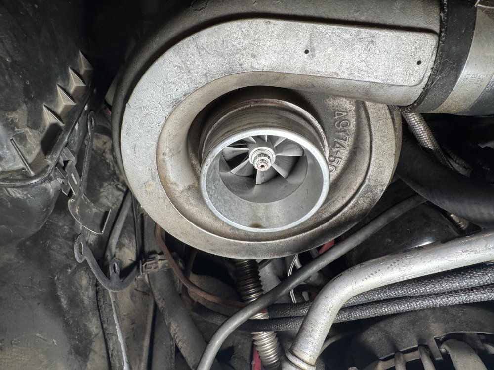

Pulled the upper intake manifold and the air filter to turbo hose/plumbing.
It appears that there is no oil emanating from the turbo seals and such.
One little spot of oil possibly from the CDR.

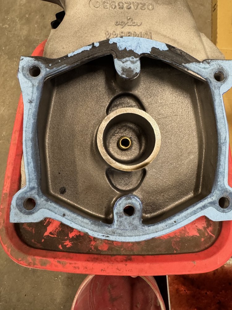

I had had the upper intake manifold off when I installed the 190 thermostats. The upper manifold had been thoroughly washed using brake&parts cleaner.
Appears to have been a slight mist of oil and there is no puddling within the lower intake manifold.

Agree that the new water pump is suspect of counterfeit. In realty though, maybe it is legit, maybe not.

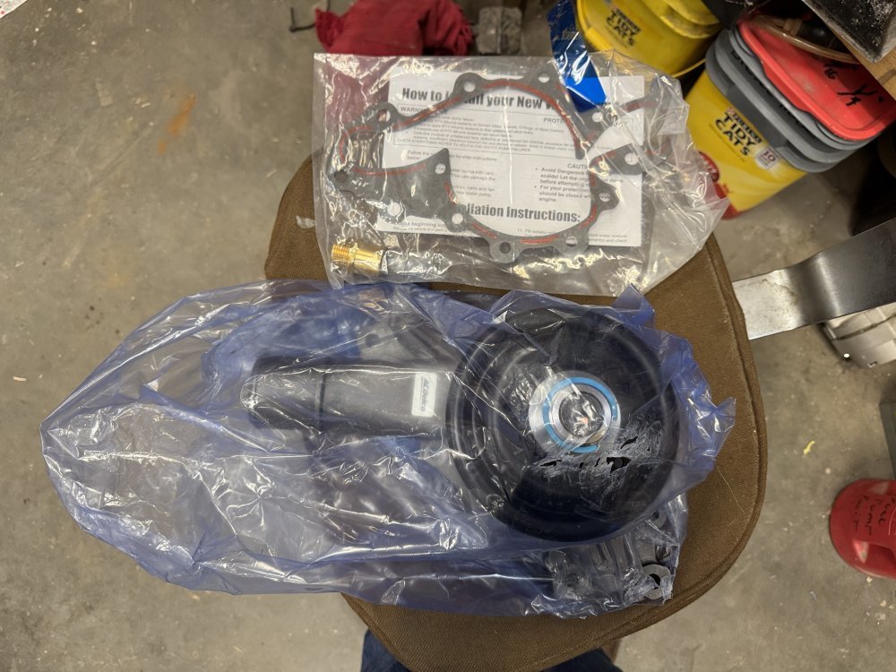

This is the water/coolant pump I ordered through Amazon.
I have read that Amazon has AC Delco distributors within their site. I hope I did right.
If not then please give me the word so I can send it back. Immediately.
ACDelco Water Pump Kit
https://a.co/d/2klYwzZ
Call the Delco tech support line and ask them if that is the right source from amazon.

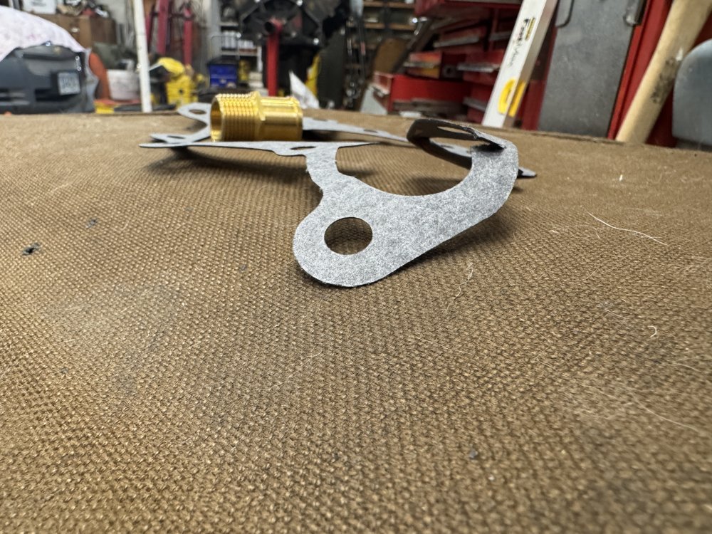

I think I struck gold.

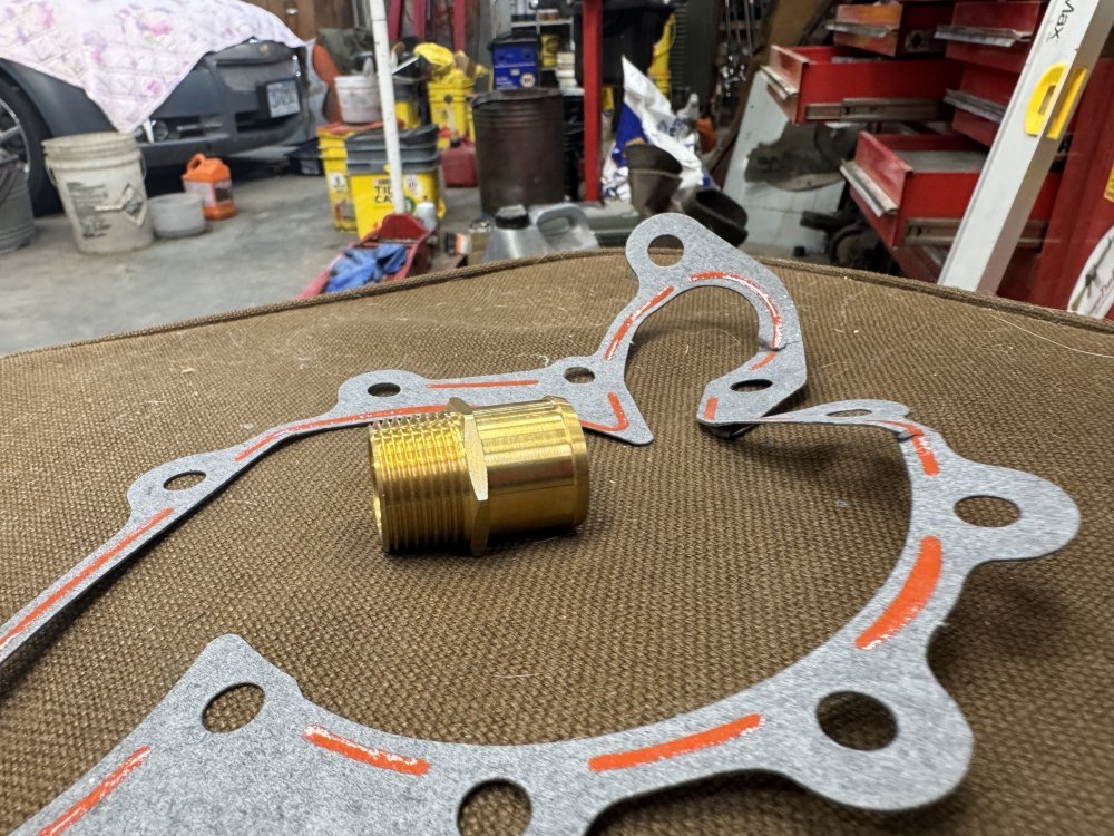

It does have a couple of small tears in it.
I do have a couple of the blue gaskets that I’ll use some No2 permatex on.
And a new backing plate gasket too.
