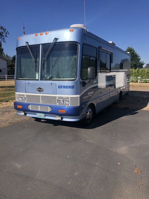

That motorhome of @Leekeeler's looks very similar to Jody's. His was DS4, side mount turbo (I know, we had to pull the doghouse in the dark, at night, in a gas station parking lot right off an exit on I-80 somewhere in the middle of freaking nowhere Nevada, so Jody could unplug the harness from the failing PMD, plug in an extension harness from Heath, snake that out the doghouse, replace the cover, then plug the extension into one of Bill's new style PMD's mounted on his skid plate heatsink, which we laid down in front of the copilot floor heater outlet so that it would have some air flowing over it). Jody's is a P3x series chassis and I assume so is Lee's.
If you remember from Jody's broken rocker leading to a new motor thread, Peninsular built a custom set of headers/up pipe assembly to center mount the Peninsular turbo and a custom down pipe. There was also a TON of room (like two feet) between the front of the radiator to the grille to put an intercooler on Jody's.

I completed doing a thorough cable inspection today a found nothing needing replaced, all good lead spacers, I think they were replaced a while back. Pulled the starter and took it down to local rebuild shop and found the solenoid was shot. Decided to let him rebuild mine versus getting a new one no knowing where it may have come from. He is an old timer, and has been rebuilding for years. Decided that the Power Master was a little overkill for me. I am near 80 so I am sure this rebuild of my original starter will be a lifetime warranty for me. I am not a gear head and was not aware that there were options for a better turbo and have not heard of any of our club members talking about. This coach was made here in Oregon so there are many around here, more gas than diesel. I have had 20 of them parked in my pasture for a rally several different times over the years.
Also, @3bals (Jody) his is a Trek, also. It was originally from Oregon, was owned by CruiseAmerica as a rental motorhome before being sold to somebody in California, who then later had it listed by some broker. I know when Jody found it, it was at a dealership in Reno, NV. Very nice, clean unit. I liked how a queen bed lowered down over the pilot/copilot seats from the ceiling, made for a very roomy motorhome for its size with a lot of social space in the livingroom/kitchen.
