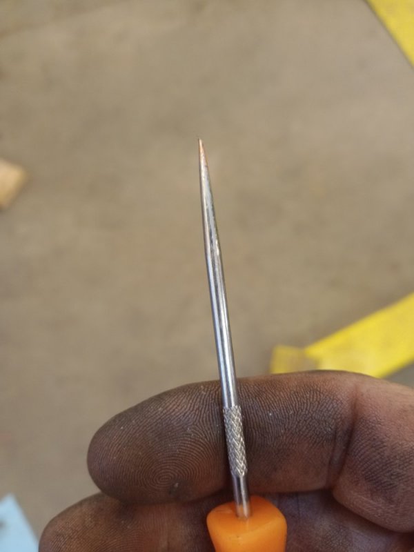

Just barely got done doing this on my mock up block
Mine was broken off about 1/2" deep in the block, I'm assuming where the threads started. Anyways I used a transfer punch to get a center mark then drilled and used an easy out. Came right out. If you're careful you might be able to use the bolt hole in the starter as a guide to get started and then pull the starter and finish drilling
