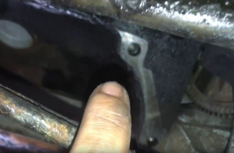

At the moment it's still holding up fine after installing new bolts and the missing rear bracket. As for pics, I didn't take any nor do I want to remove the starter again since it's working. The repair I saw was made on the outer ear where someone did some welding and used a heli-coil thread insert. the inner bolt hole threads look fine but you can clearly see a small crack across the open bolt hole. I did try to get a good look at that crack and it looks to not go very deep where it's not causing any issue with the threads in the block, but that is still an unknown. when I reinstalled the starter, I didn't try over tightening the bolts at all! I used a long handle ratchet and tightened them by feel as many people do, so if anything they are under-tightened but secure. Figured I would slide under the truck and re-check them from time to time. the worst thing would be to reach ether the specified torque or over tighten and the thread insert or welded area pull and break. I did take note that the inner bolt hole has about a 1/4" of extra threads that the bolt doesn't reach and have thought about getting a slightly longer bolt there but I am hesitant because the starter bolts have a machined fit through the starter not to allow any misalignment and a standard bolt could possibly allow the starter to shift slightly.

I know that when I had the starter off, there was only two bolt holes like the photo here. if I could get my hands on a nose cone or an old school starter with the third bolt, I would defiantly try to attempt drilling and tapping that extra hole in the block help prolong the inevitable!
(photo is of a 6.5l I found online, not mine of course! but if you look at the bolt hole thats being pointed to, mine has a through the hole in the ear, the outer was broken off and re-welded.)
