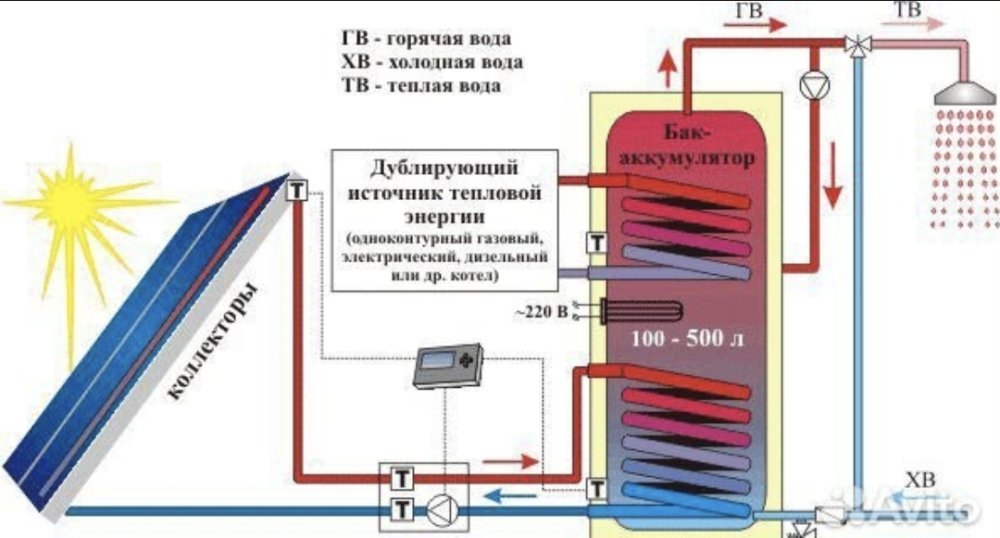

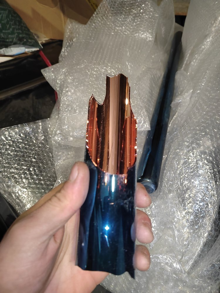

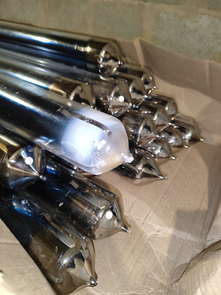

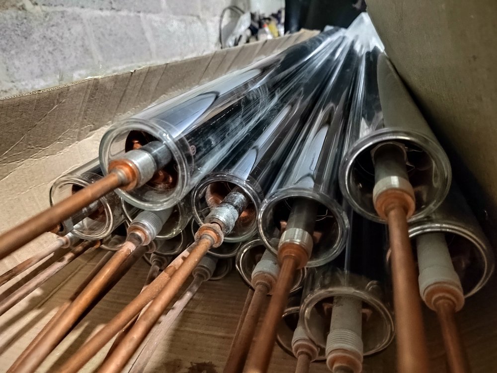

Vacuum tubes of the solar collector, outside -32°C, the copper tube heated up in the sun about +100°C. the snow melts and boils. Next, these tubes are inserted into the collector where the coolant takes this heat and transfers it inside the house/garage. each tube produces approximately 100 watts of heat.
