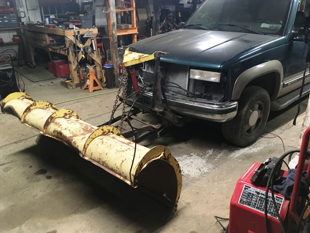

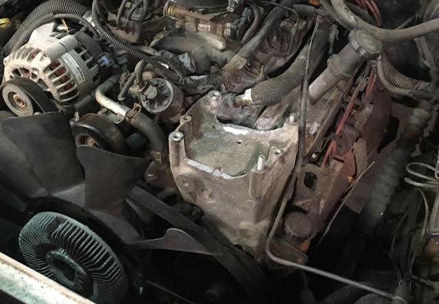

So before I can get the 6.5 in the shop, I had started this project a while back: mounting a hydraulic snow plow pump in place of the A/C compressor on an old 5.7 Suburban.

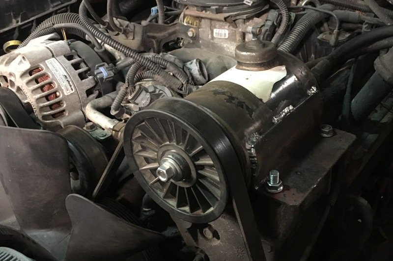

Hollowed out the A/C Bracket to make the hydraulic "fit"

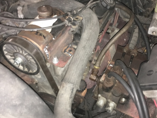

Now the pump fits nice and snug.
Welded piece of angle to the side of the pump, pulley is custom fabricated from an old A/C deleted pulley bracket assembly.

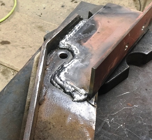

The Plow setup came off and old square body project that I abandoned. So the mounting plates were completely different.

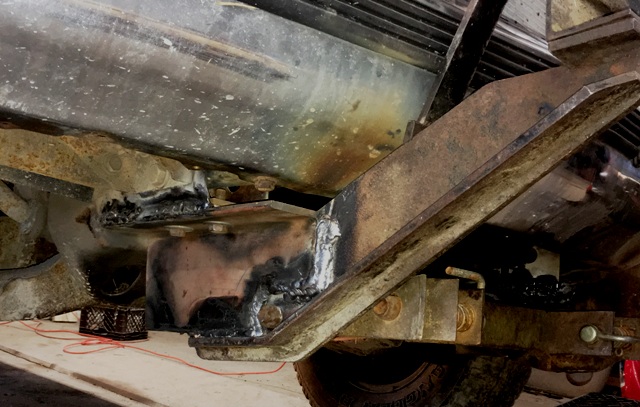

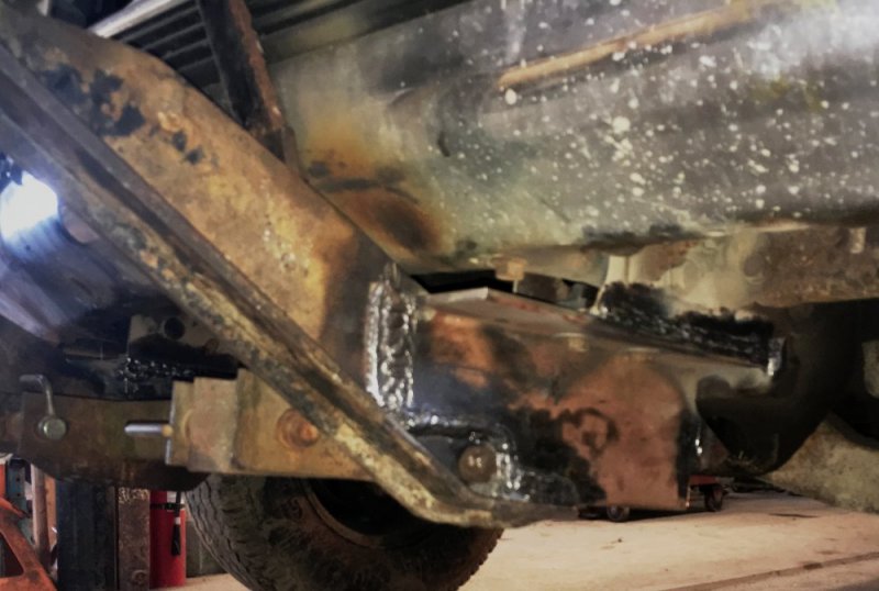

I solved that issue by cutting them back and welding to a piece of 3" x 5" angle, that I mounted to the front frame in place of the tow hooks.
I needed 27" between the plow frame plates for the frame crossmember to fit, with the angle steel in place of the tow hooks I was able to get the crossmember to fit and have enough steel available to weld to the front frame on both sides of the top of the angle.
To make the valve spool assembly fit I had to cut off the cable bracket and reweld the cable support to the valve maount on a side 90 degrees from original position, then heated the bracket to bend same angle as inner fender and bolted / tack welded under the ABS valving unit.
So everything is together, it raises, lowers, moves left and right. So when we get another snow storm I'll find out how good it really works!

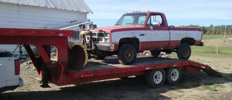

This was the abondoned project, had too many frame issues to salvage. I did get a nice rebuilt 350 and this old plow setup out of the deal.
