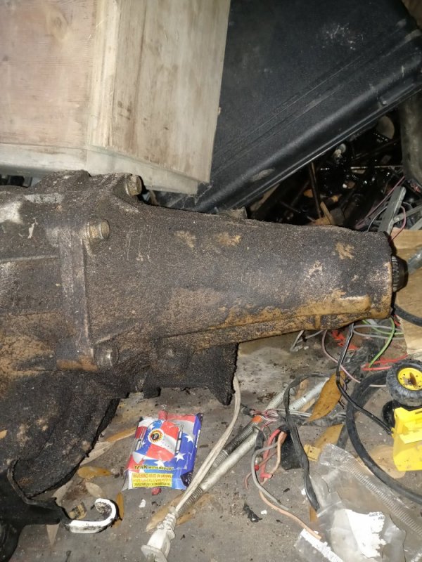

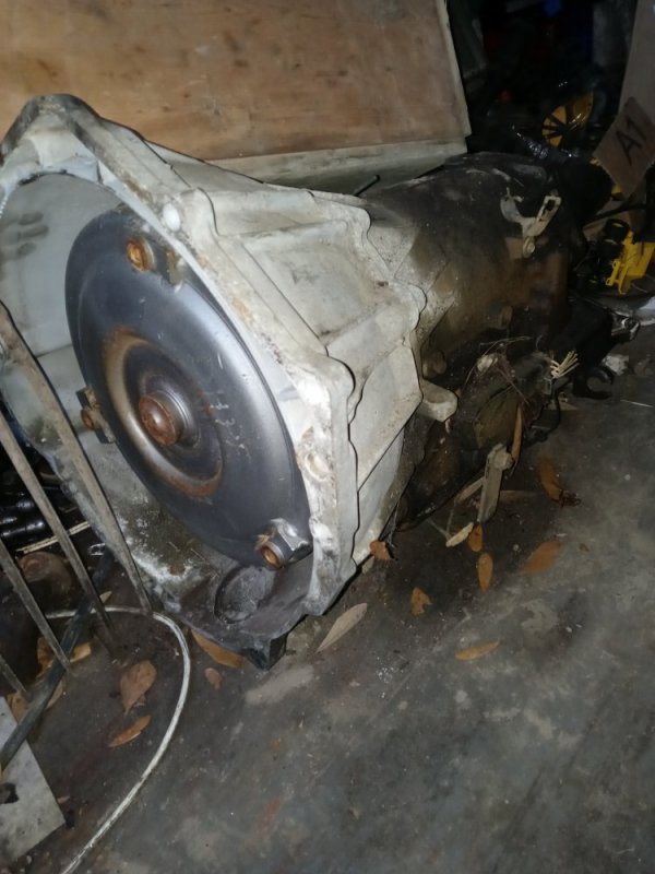

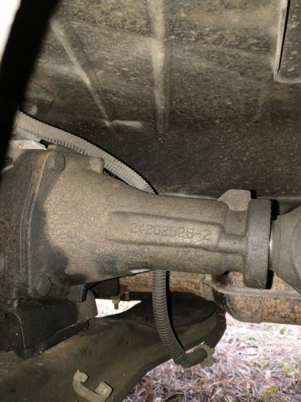

Top pic is the replacement bottom is one in truck and measurement from tail shaft housing flange to end of shaft is 1 3/4 difference 3rd pic shows its a newer 4l60e as the other is a older and has a metal dust cover for torque convertor/flexplate and also the tail shaft housing have different bolt patterns the bad has 4 bolts the replacement has 620211129_164606.jpg20211129_164753.jpg20211129_164618.jpg
In 96 V6's went to the 2 piece case, and by mid year 97 they all had went to the 2 piece case. The 4 vs 6 bolt extension housing was simply a change when they changed cases. ALL 4l60e's from 93+ list the same exact output shaft for 2 wheel drive trucks. You cannot go by the length of the extension housing, you have to check overall length. Guys all the time go from 700r4's, 4l60's, & early 4l60e's to the late 99+ 4l60e doing LS swaps and re-use there stock driveshafts. GM put 1&2 piece case 4l60e's in 96/97 trucks and used the same shafts for both.
If you look at the 96(4 bolt housing), you'll see the trans mount is not on the housing, but on the case, on the 97(6 bolt), you'll see it is on the housing. The newer cases bolt the extension housing on further up, that is why it is longer.
And looking at your picture, the driveshaft is bottomed out in that pic, so I hope it's a 2 piece shaft with it in that deep.
