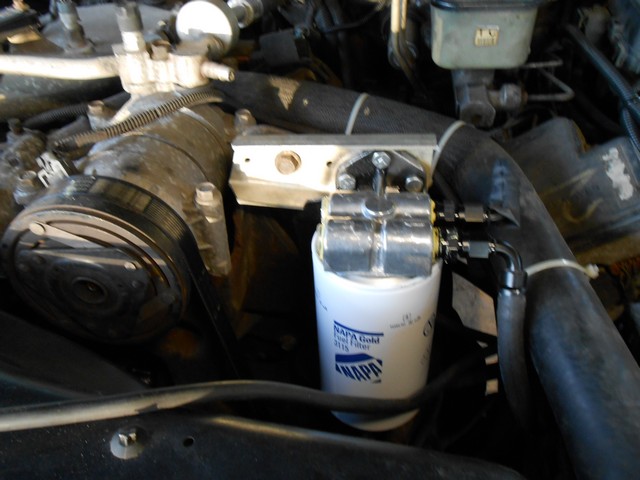

Time constraints forced me into a quick workaround on my FTB upgrade.

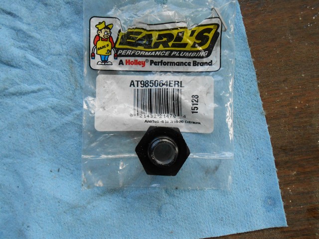

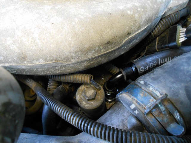

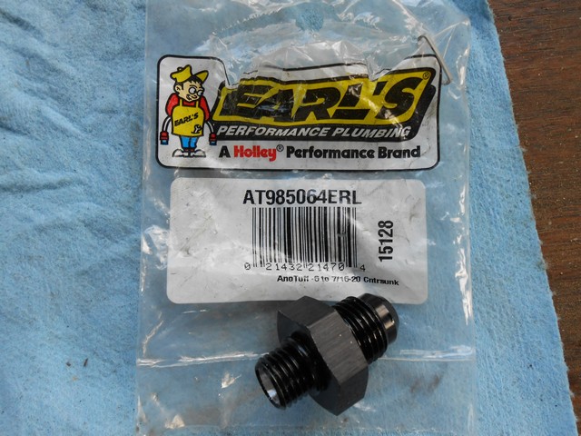

A rusty fuel return line at the tank sending unit was causing me grief with a leak and the sending unit replacement showed up some iffy steel lines and flexible lines that needed attention, with no time to wait on ordering them. So I just gathered up my fuel filter parts box of goodies that were going to go under the truck and fabbed a mounting bracket on the PS bracket and relocated them up top. I came directly off the Walbro fuel pump with a 3/8" line up to the Wix fuel filter base using Vibrant Performance -6 90 press-on swivel fittings and over to the injection pump with 3/8" line to a Vibrant Performance -6 90 press on swivel fitting on an Earls -6 to 7/16-20 o-ring base fitting drilled out to 5/16". The injection pump inlet fitting was drilled out to 3/16" holes with a carbide end mill by my machine shop in about 15 minutes. Rusty fuel line bypassed. FFM bypassed for now. (Will be modified when time permits).
