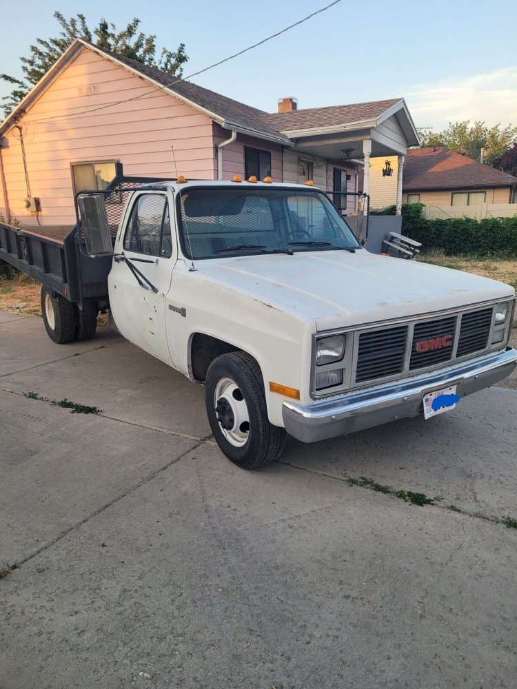

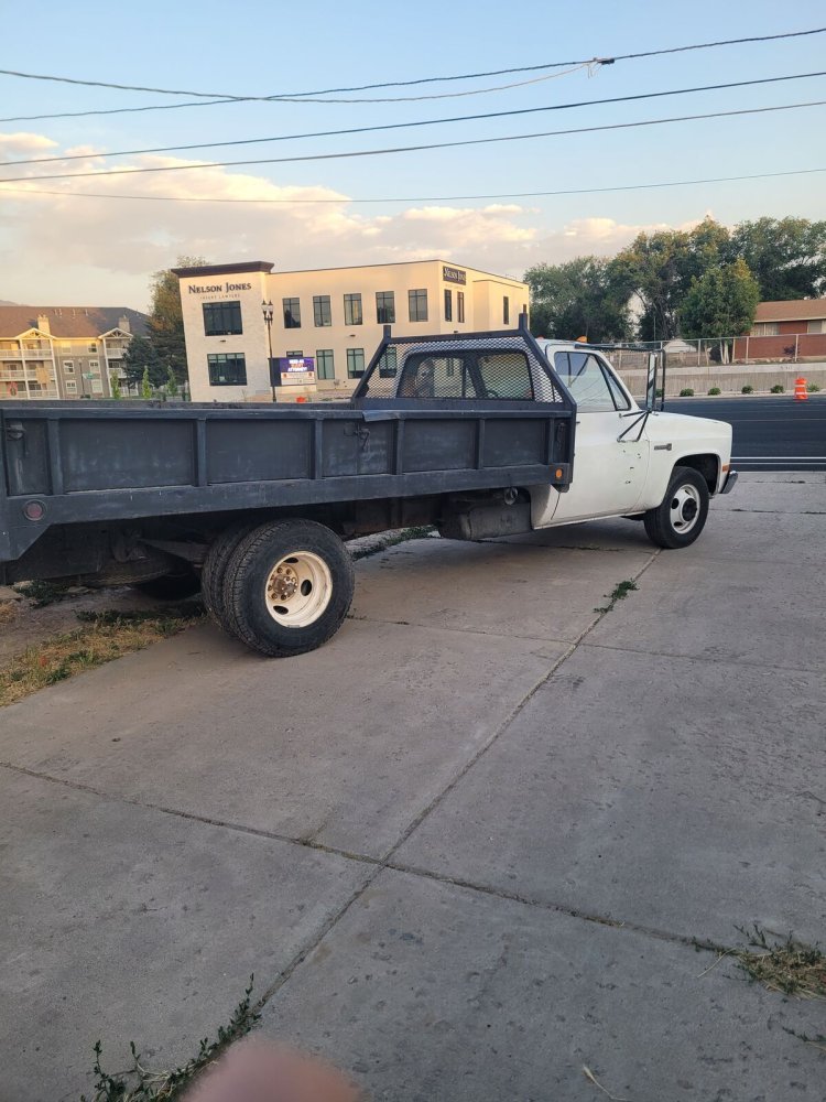

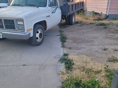

I just bought a 1988 R3500 Dually. With 350 engine and 4 speed manual tranny. This is the square body style. I want to put in a tilt wheel steering column as the current wheel cuts into my gut when I'm in the truck. (I'm 6'0 and 305 lbs). I also want to replace the seat as it has a large divot in the foam that reaches to the springs.
Ultimately I will build a 6.2 that I have, add a turbo and auto trans, and swap out the 350 SBC...
Anyway, what years of seats will fit into this with little or no modification. Finding seats from a square body is like the proverbial needle in a hay stack.
What things have the rest of you done for seats in a square body?
