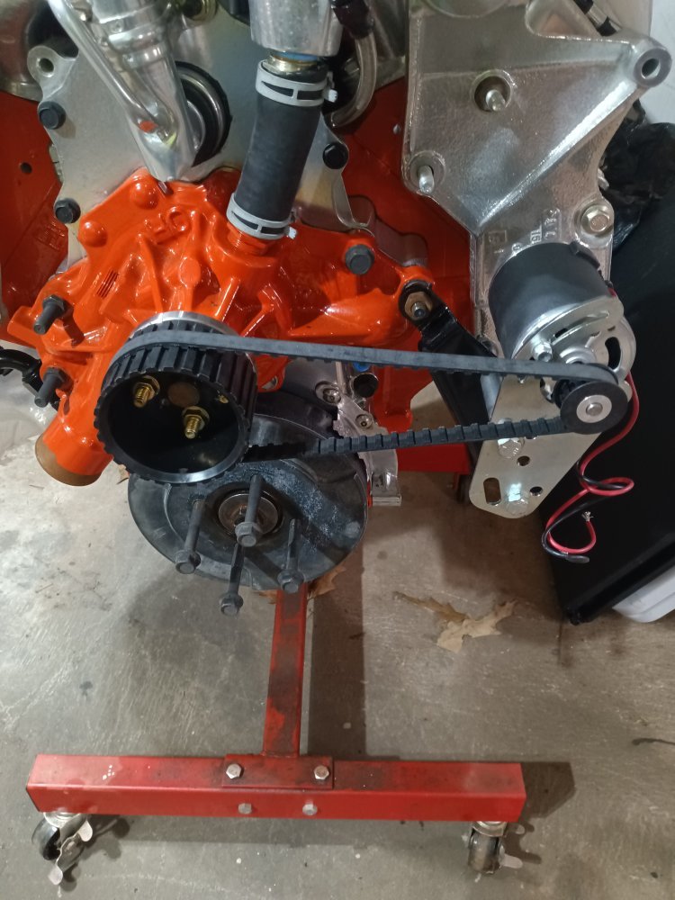

Anyone know the thread size for the big nut that screws on the w/p for the newer pumps? I'm going to thread a plastic pulley for my electric w/p drive on my run stand.
I have a fan clutch that utilizes the large nut onto the coolant pump, I’ll go out and measure that up for You.Anyone know the thread size for the big nut that screws on the w/p for the newer pumps? I'm going to thread a plastic pulley for my electric w/p drive on my run stand.
Thank You very much. That takes the guessing right away from it.I looked up a fan clutch for a 99 C3500 6.5 diesel and found the Hayden 2840 shows a M36x2.0 thread. I went through this when I installed the electro-viscous clutch on mine. the threads are the same for a 2010 Express van 3500 6.6 diesel
