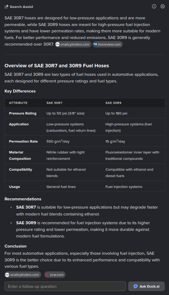

Is this a high enough rating to withstand extended periods of diesel fuel return hose ?
According to what I read on the specs it lists diesel and bio fuels too.
Just checking before jumping is all.

Sae7 works but will fail in a decade, sae9 will withstand 30 years. The 9 is barely more expensive and ever so slightly stiffer so imo is the automatic go to.

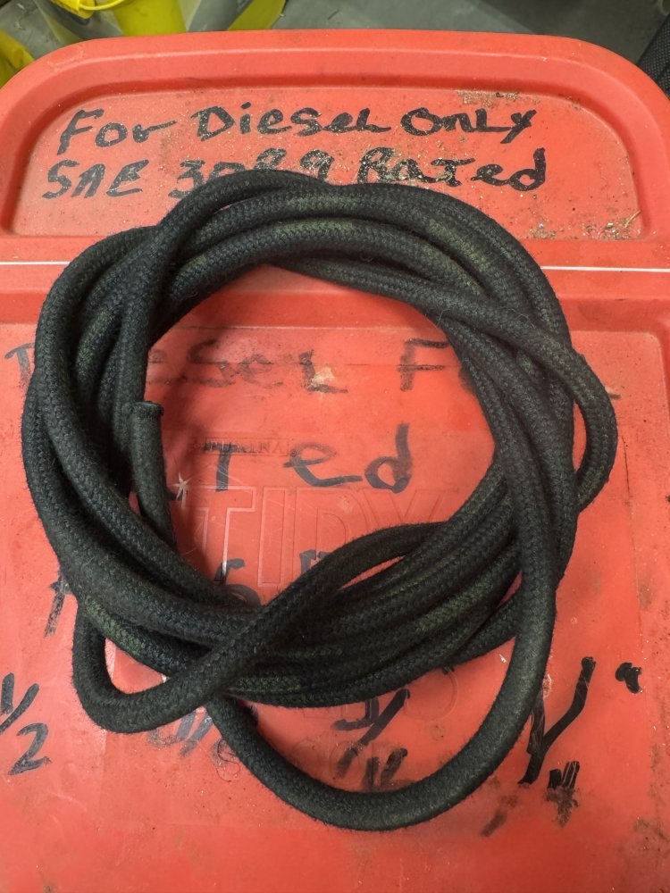

IDK why that fabric coated hose from Leroy cracked at the nipple the way it did.
Guess it dont matter now cause its all going by the way and getting replaced with a 9. Left side will be right away.
There is no 1/8th inch 30R9 hose, none.
