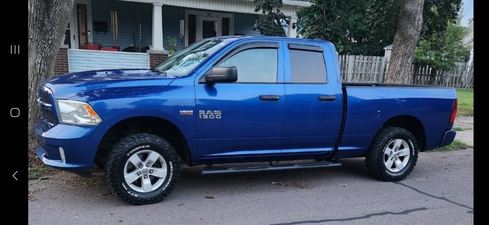

So, who's do I buy? NAPA, Auto Zone or maybe Power Stop?
As mentioned you need to lube the caliper pins often on a RAM. All 4! I did the rear pins on mine even though I was just doing the front pads. Some were dry already.
