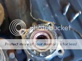

Front wheels started squeaking so I assumed brake pads were done. While pulling the first wheel/tire I noticed I could easily rock the top of the tire 1-2". #&*@ that's not good!
Grabbed up my 2 old wheel bearing assemblies from my 06 and went to work. Currently have one side done and side 2 50% apart but wife picked me up for lunch.
I have a video of me rocking the bearing but I will have to load through photobucket later.
I think this might have something to do with the chitty mpg. We can always hope.
