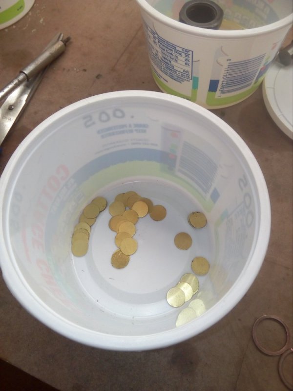

I have 100 +- shims I got at local picknpull yard. They had lots of ooold MB diesels, real junkers. Nozzles pitted badly. Took apart for shims. MB turbo, non t, 240's 300's, 6.2 chev, all the same diameters, holes in the middle slightly diff sizes. All bosch nozzles, all work. A few I had to stack shims, <- not a problem.

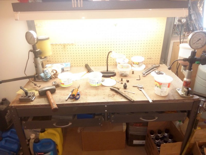

(edit: I got a Bacharach (?) nozzle tester at a yard sale for $5 years ago, I think Navy surplus from WWII, took a while to find a filter for it.)
