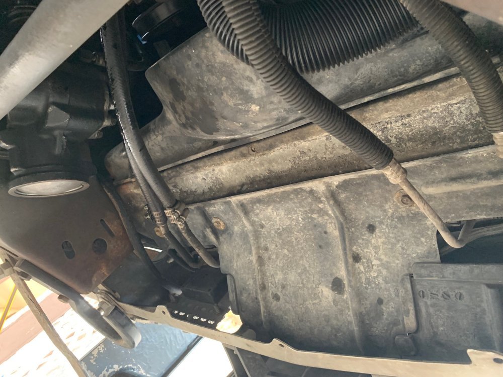

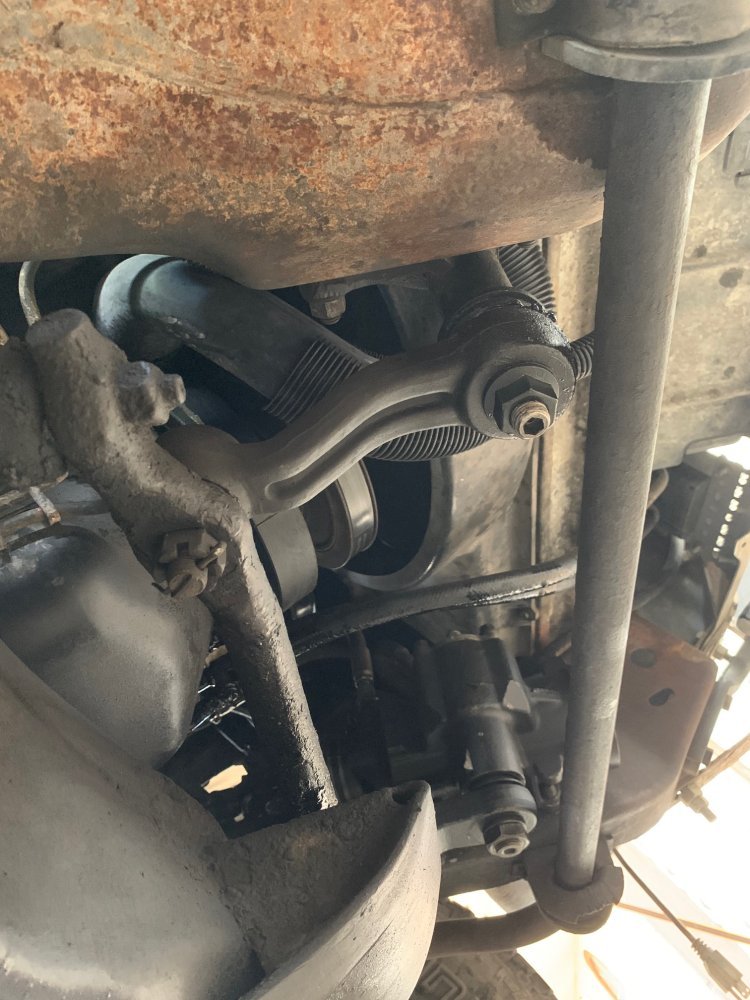

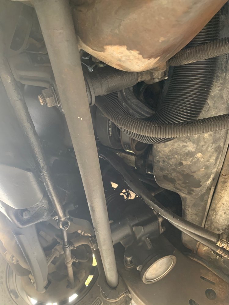

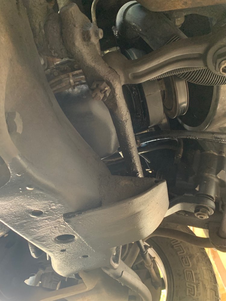

@SnowDrift you need a pic of the area on the 01 burb I have tore down for the skid plate? I will try to remember to get out there this weekend and get some closeup's there is a cross member that runs across just behind the radiator support along the steering center link that has some threaded holes in it, also up in front of the lower radiator support there are some more threaded holes for the skid plate. Then there is another plate that covers the bottom of the front diff but I have all that area torn out with having the oil pan removed.
@SnowDrift Sorry it took me so long to post. This weekend was a busy one! I took these pics eariler today just before finding some time to pull out the power washer to give the truck a bath seeing that I have an oil leak from the valve covers. was cleaning the front yard power washing the front porch.
I tried to get everything from behind the front bumper back to the frame cross over under the pan.
