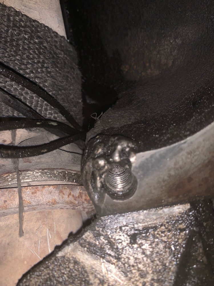

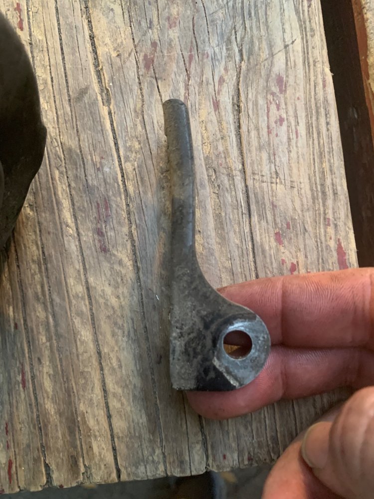

Tonight I got a chance to pull off the starter and take some pics of the carnage. Now take note of the pics below, when I did the flex plate and reinstalled the starter, I used GM bolts with nord locks to keep them from backing out. also installed a new bracket. The way the block was repaired with the thread insert, I had to cut some extra threads on the outer bolt for it to fully seat on the starter to tighten up. also the bracket was new when installed.

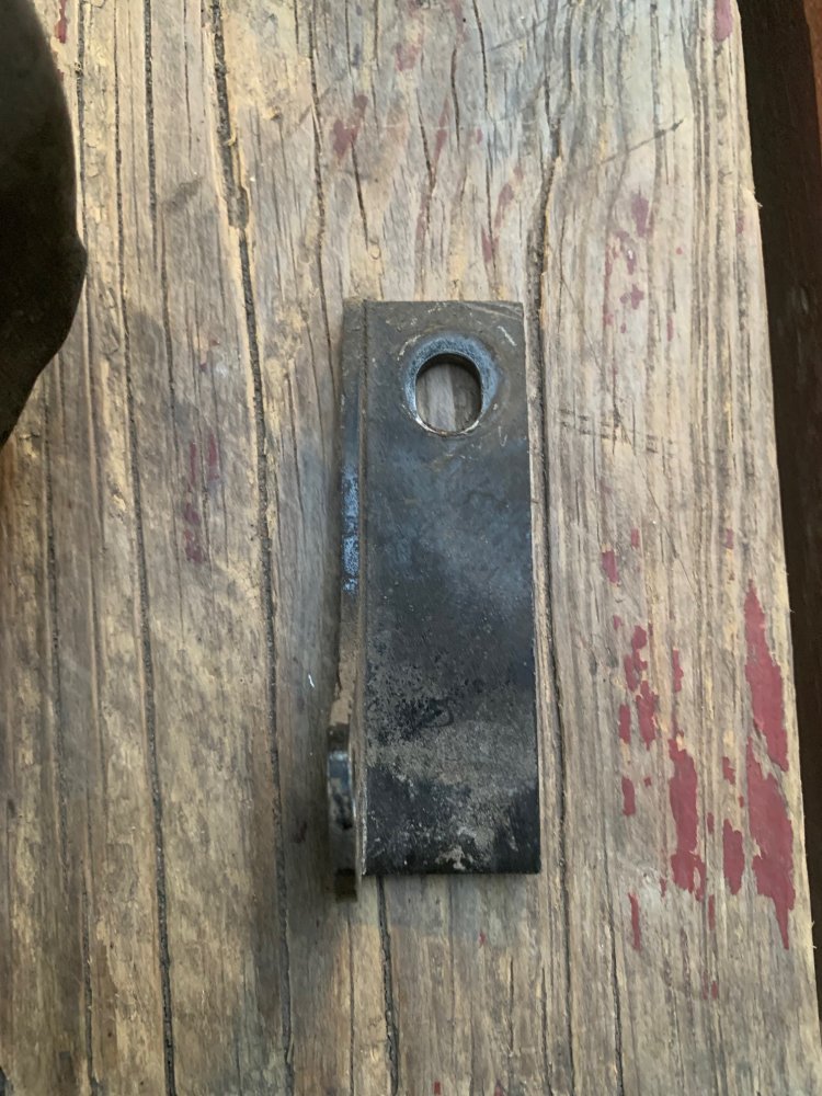

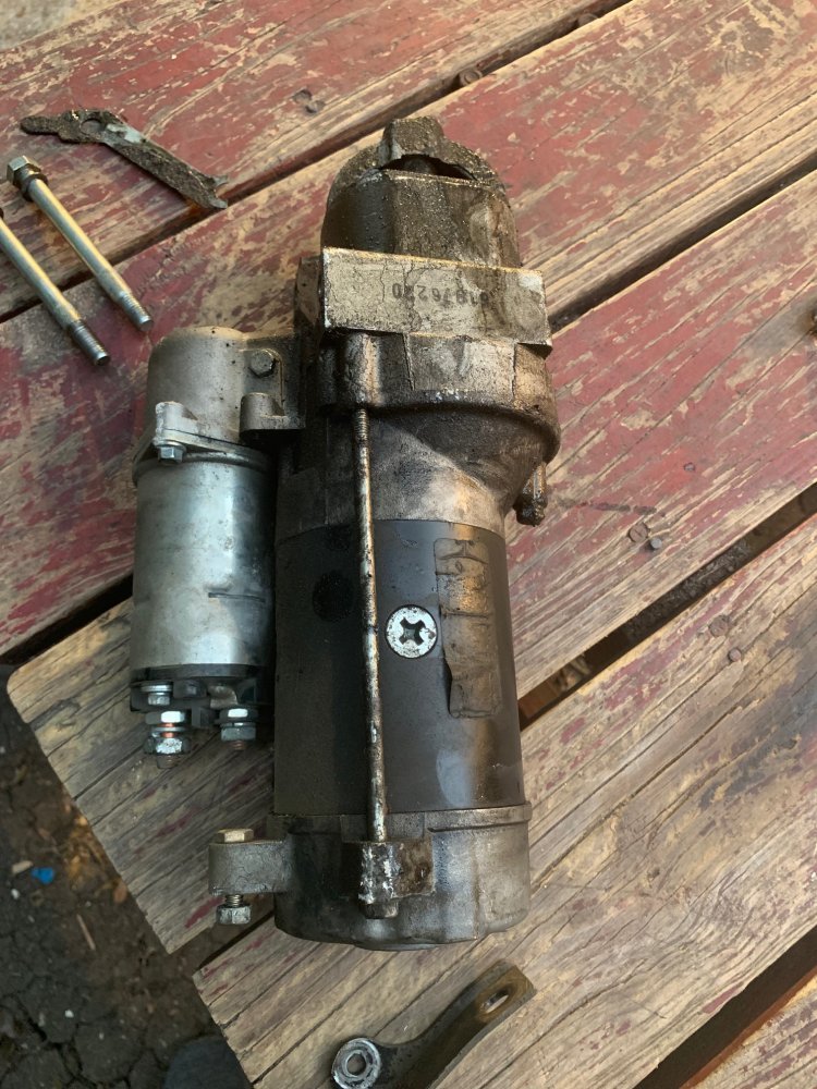

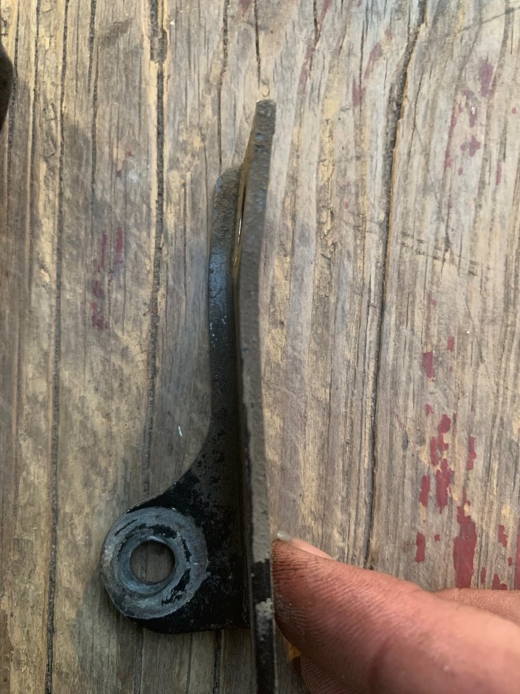

when I removed it all, I noticed real quick that the bracket was bent severely but the bolts were still tight and not bent. I also noticed looking at the starter real good, you can tell that the rear housing with the stud for the bracket has twisted a slight amount (look at the long body bolts on the starter for the angle)
Here is the bracket...
The starter...

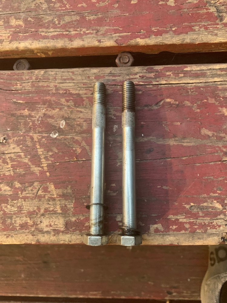

And the GM bolts I used with the nord locks... (notice the extra threads I cut for the bolt to fully seat)

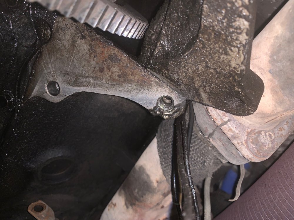

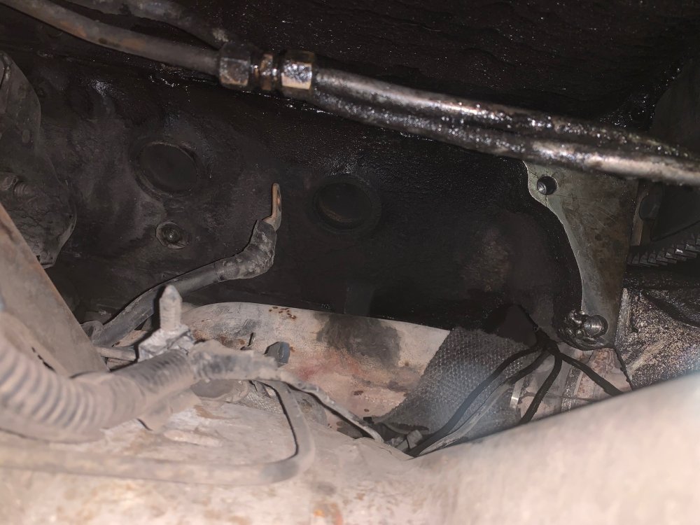

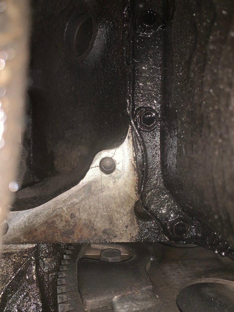

Now for the Carnage..

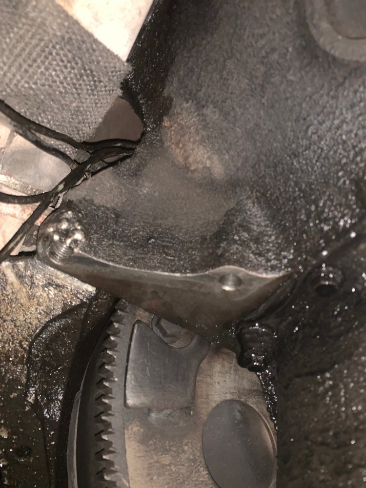

Yes the other bolt hole had two cracks in it too! sad, very sad. I also see I have a valve cover leaking, what joy!!

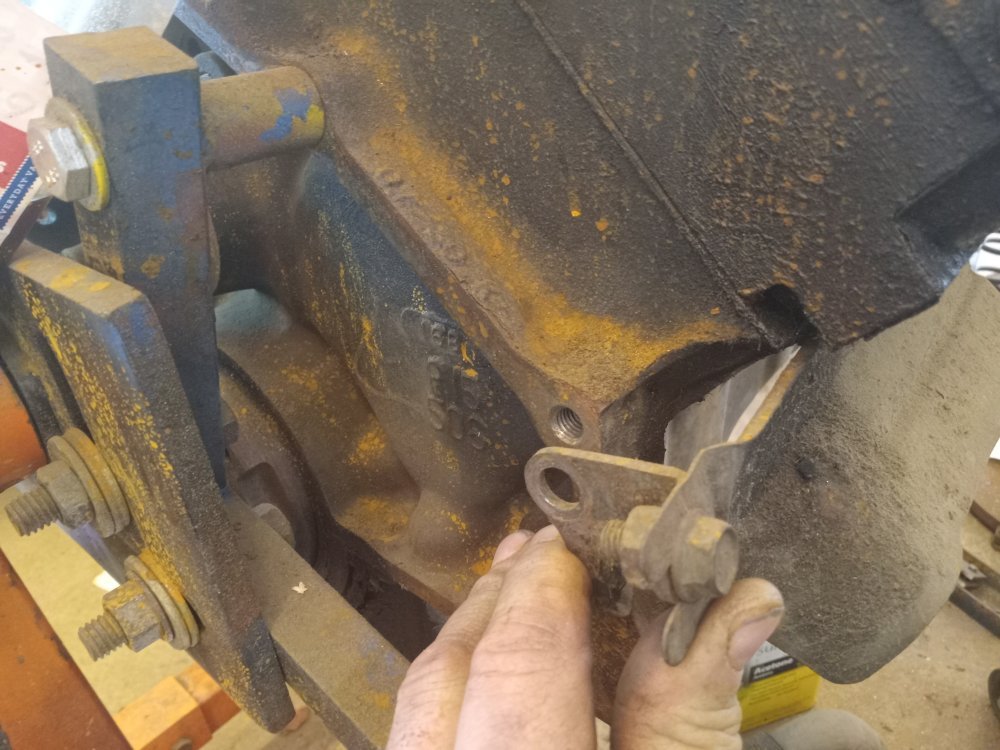

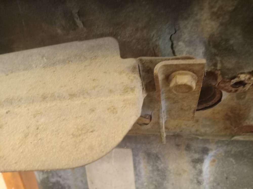

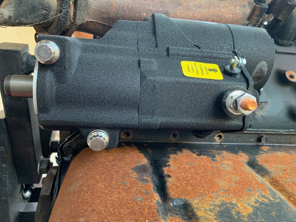

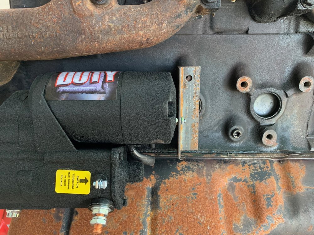

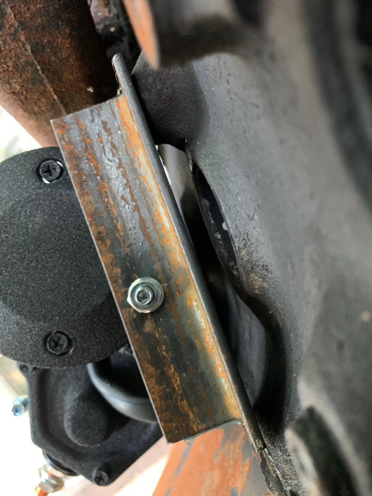

I had test fitted the new starter to a donor 6.2 block I have just to visually see what my options were. I came up with using a piece of angle iron slightly longer than the original bracket so that the end would rest against the block just above where the oil pan face is. other that that, I really can't see anything else I can do here. Maybe some of you all might have some suggestions and ideas. Here are a couple of pics of the mock up fitment on the 6.2 block.
One thing I noticed was when fitting the factory bracket, it has to be slightly tilted for the bolt hole to line up. Not sure if that is an issue, I still have work to do on the angle iron like making the bolt hole ether larger or slotted like the factory bracket. what are yall's thoughts on this?
Note: this factory bracket is another one I had in my tool box, it's not the one I just pulled off my engine that was bent and twisted.
If it was me I'd make a copper bolt and then vee out the cracks pretty good install the bolt and preheat pretty good then mig weld it and then post heat it to let it cool down slowly. Unscrew the copper bolt and you'd be good
unfortunately no, I don't know anyone who can weld cast near me. those two cracks were there back when I did the flex plate.
Leroy diesel sells a kit that has a bellhousing adapter plate that goes between the engine and transmission with custom starter if you really want the problem resolved.Probably isn’t cheap but looks like a great product that’s been developed.

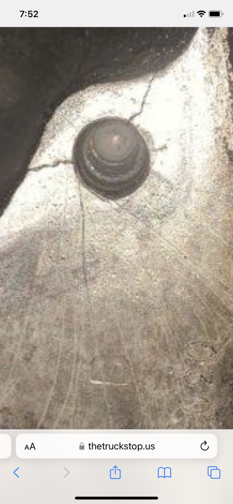

That ear is going to fail. How long is anyone’s guess. It isn’t just a couple cracks- I zoomed in so the bolt hole cracks are easer to see- the hole thing has spider web cracks throughout.
I don’t know how well welding that would work without repeated grinding a V, welding it, grind flat. Then V the area next to it, weld, grind flat.
Then after doing it everywhere- those fractures are still so deep it might still fail.
But might be worth a try. The other option is crossing fingers and when it goes, get the kit from Leroy, saving the Powermaster for the 6.2
I noticed on the pic with the old bolts, you had 1 washer on each. When using Nordlocks: the way they work is the two together interacting with each other. You don’t use them with any other washer of any kind. The two nordlocks are blue in the picture to demonstrate.
on t he old bolts the washer is the nordlock, one on each bolt. I didn't know it took two together for each bolt! on the ARP bolts, they came with some sort of thick spacer. not sure what the spacers are for though.

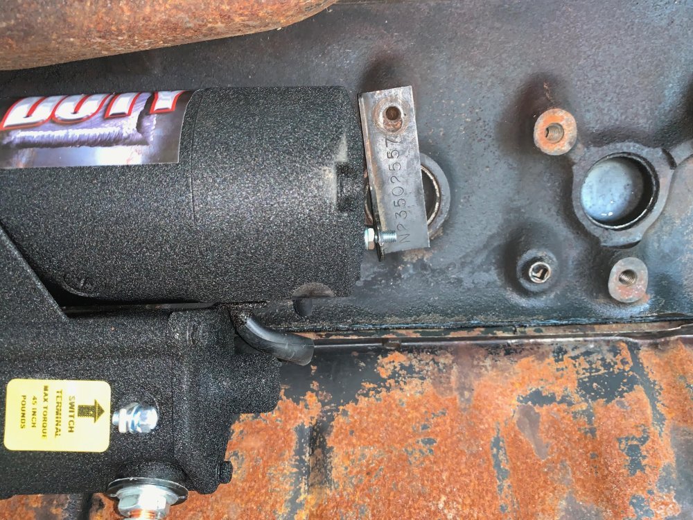

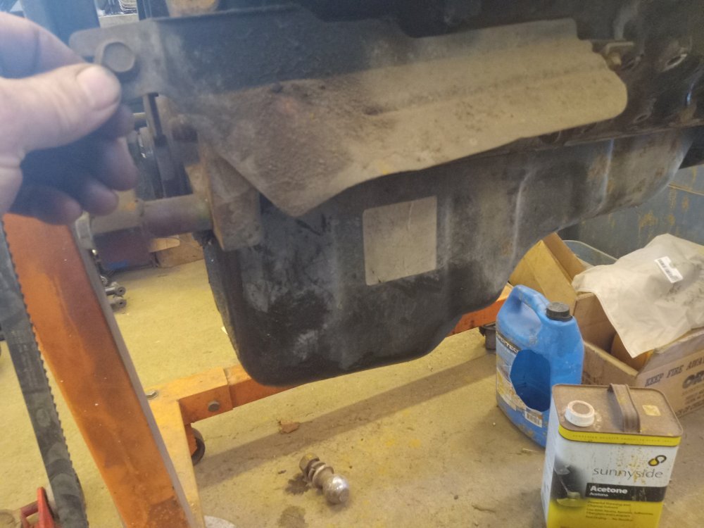

I also ordered a starter wrap off amazon to help protect it from the manifold heat. it was the simplest thing I could find. seems it encases the entire starter. Not sure that is such a good idea though, it can trap heat in the starter as well.

looking at the pic you posted of the heat shield, I looked on ebay and found this one. it looks a bit different, looks like the one end used the factory solenoid to secure it. how does the one your posted get secured on the one end. I can tell the other end uses the bolt from the bracket.
