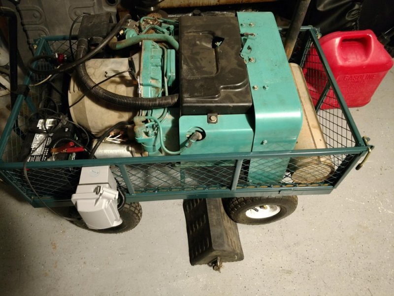

Got tired of looking for a Unicorn: A Travel Trailer with a built in Generator. No use for a toy hauler. For RV camping with no hookups out west in US Forrest service, BLM, Park Service type of places.

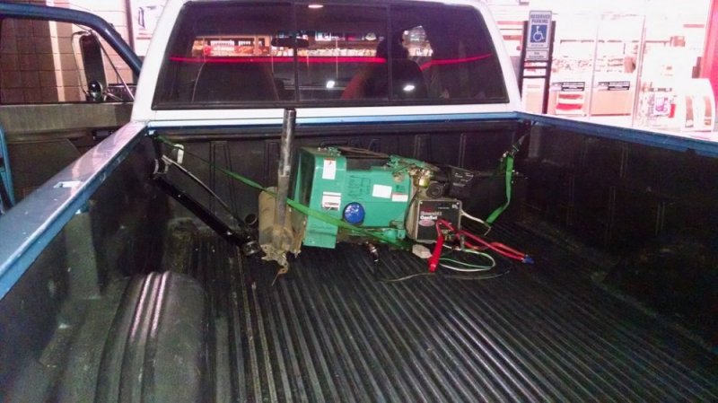

So when a 4KW Onan 1800 RPM genset showed up on the list for under five bills I went out to have a look.
Ran badly spitting and sputtering. Smoking blue out the exhaust. Can we say "discount?" It will fit right in! Genset was free, but, the large AGM starting battery cost me four bills.

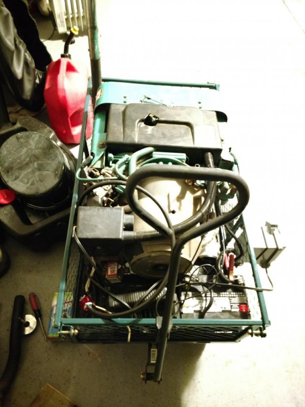

Back home sitting in front of the 1992 project with good gas it cleared up and started running perfectly w/o smoke. ($2.00 of bad gas cost someone $100.00.) Ran an air conditioning load on it. Held a conversation standing in front of it as it is so quiet. I am happy it has an older adjustable carb rather than the electronic controlled one. I was surprised to see it had points. Not sure if I should get a electronic conversion kit rather than just new and spare points.
Needs an air filter to carb plastic intake assembly, fuel tank, fuel filter, shelter to keep the rain off, and a way to mount it.
Best off all this heavy SOB won't be walking off easily like the light inverter units.

Anyway nearly in time for the power outage yesterday I had all the old gas burned out of the Homelite with a can of fresh gas and new fuel filter. But more important: has the Onan ready to go. Just adjusted the carb for full load to stop it's hunting. Need a gas tank for it though. Or propane conversion...
This 1800 RPM and large muffler is way quieter than the 3600 RPM Homelite!

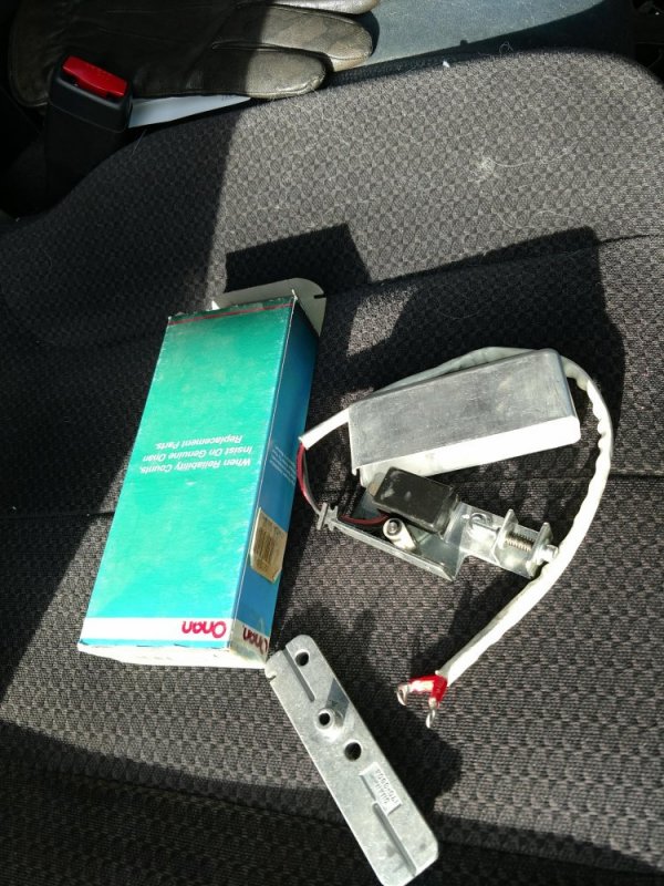

And when no one was looking, including myself, a long discontinued Magna Arc 160-1376 electronic ignition conversion showed up on a online clearance section for under $100.00. Just listed as Magna Arc.
I got one of the last 3. Now I will have a spare set of new points with less than 4 hours on them. (There are other cheaper aftermarket conversions out there to make a transistorized switch from the points.)
