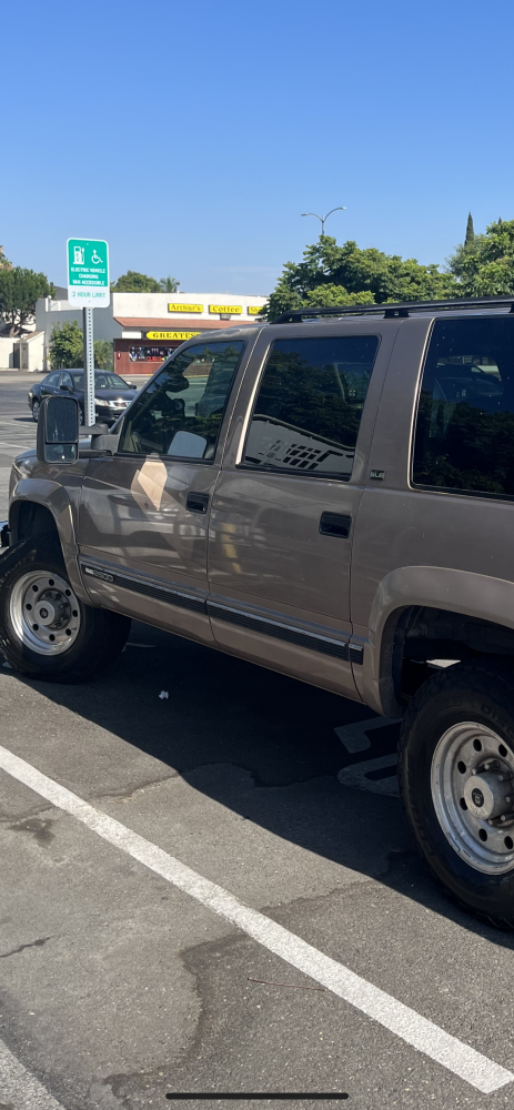

Looking to order paint for the ‘94 Suburban and need the paint code. Here’s some pics of the Suburban showing the color:

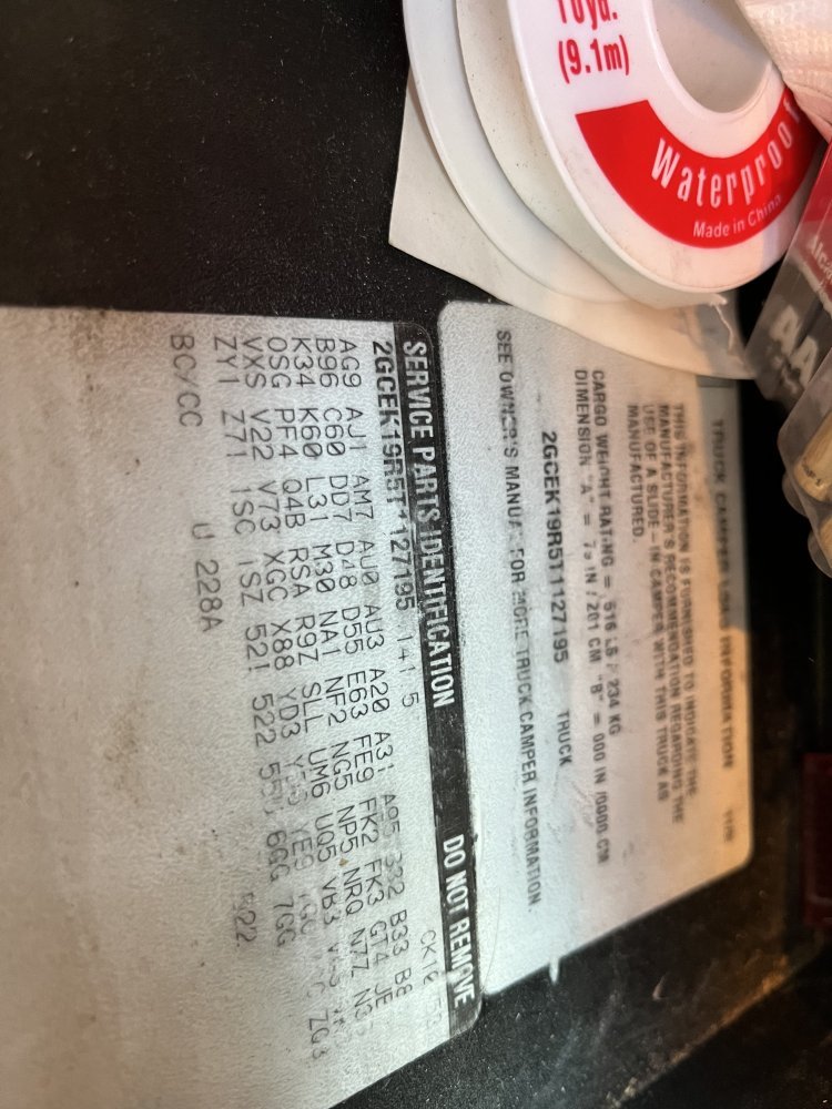

Suburban is not with me in Montana, but her is a pic of the RPO codes from a similarly painted 1995 GMC truck:
Which one is the paint code?
I think it is the U 228A, which would be called a Light Autumnwood Metallic? Am I correct in the assumption that your vehicle is not really a gray or silver?

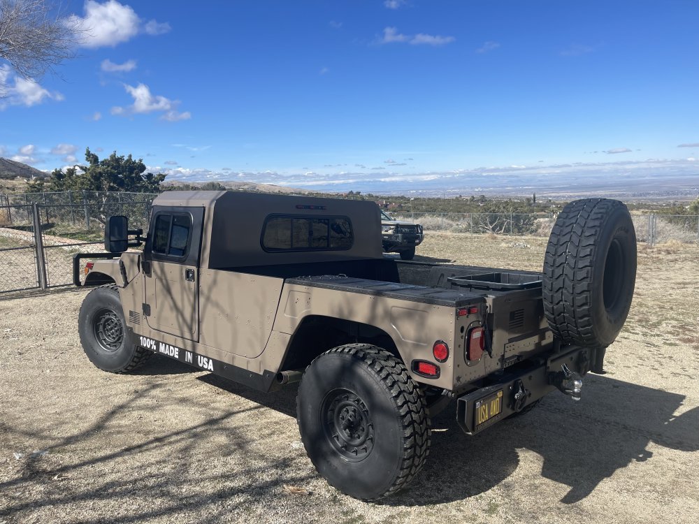

I used 2 qts of paint to finish the hummer.

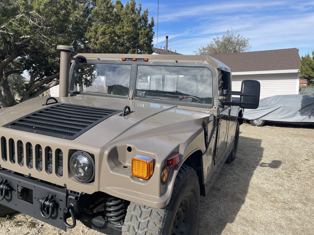

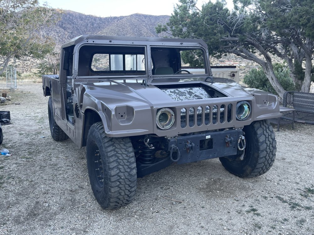

View attachment 86821View attachment 86822View attachment 86823
Turbine HVLP system. Same color. Whole body eventually.

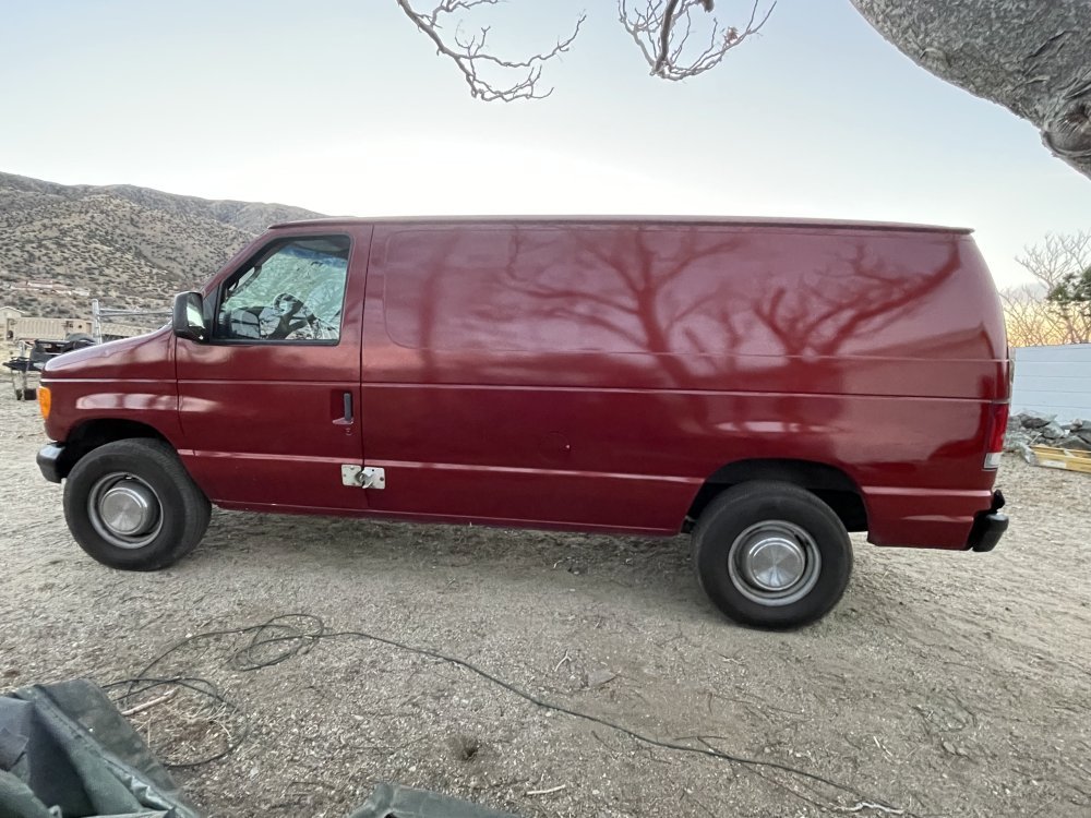

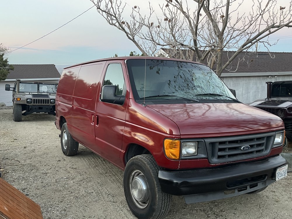

I will give you a little dirty experienced painters trick secret
that I did on this van.
this van was in bad shape, it needed full paint job,
but it’s a work van, the paint code on this van is very expensive, 190 dollar a qt, it needed over 1.5 gallons to finish the job after primer.
so I went to Home Depot and bought few spray cans that was as close to its original color,
I used that spray can to cover all the primer repair locations, then i sprayed the original color over it,
It took only 2 passes to cover everything,
I used 2qts of automotive paint instead of 1.5 gallon,
