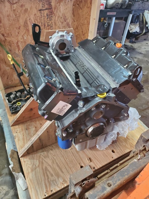

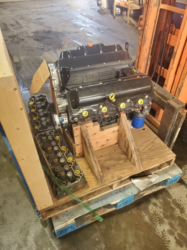

Here is another pic, with the truck heads.
Long story, short...
I provide 6.5 parts & service, engine swaps, diagnosis etc. They're my hobby
This engine belongs to a buddy of mine, I've been tasked with installing it in his 99 Tahoe. He's aware of the oil pan issue, says it won't be a problem after the front diff is removed and reinstalled after the 6" lift. I'm skeptical... But we'll see

So is he selling the hummer p400 heads?
I hope he bought the p400 heads instead of another one. If not have him return them and get the p400 ones!
