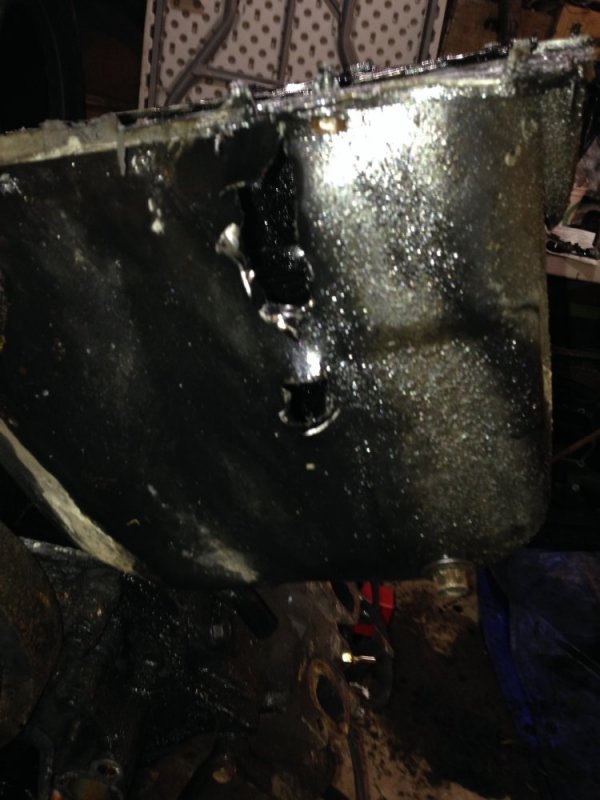

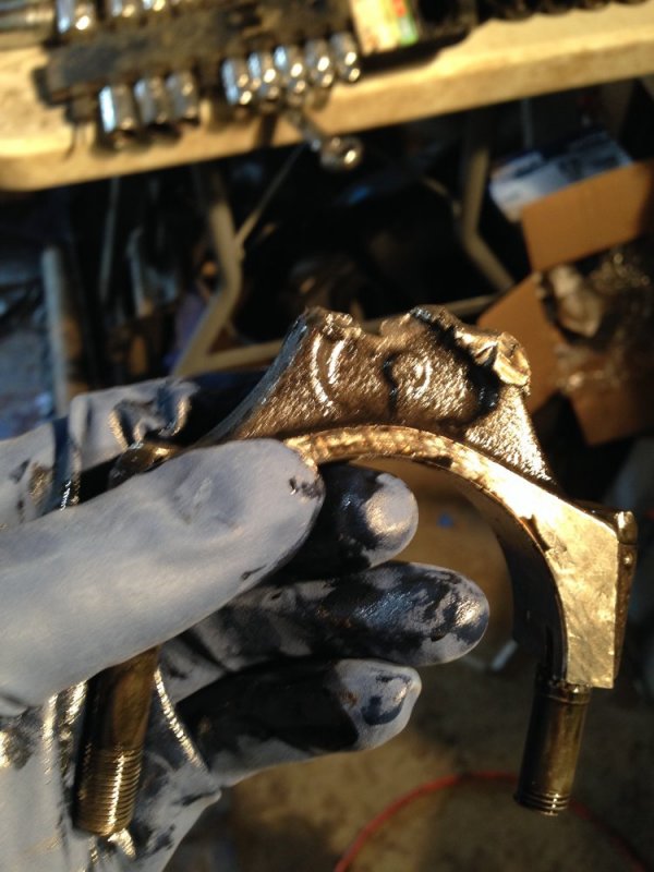

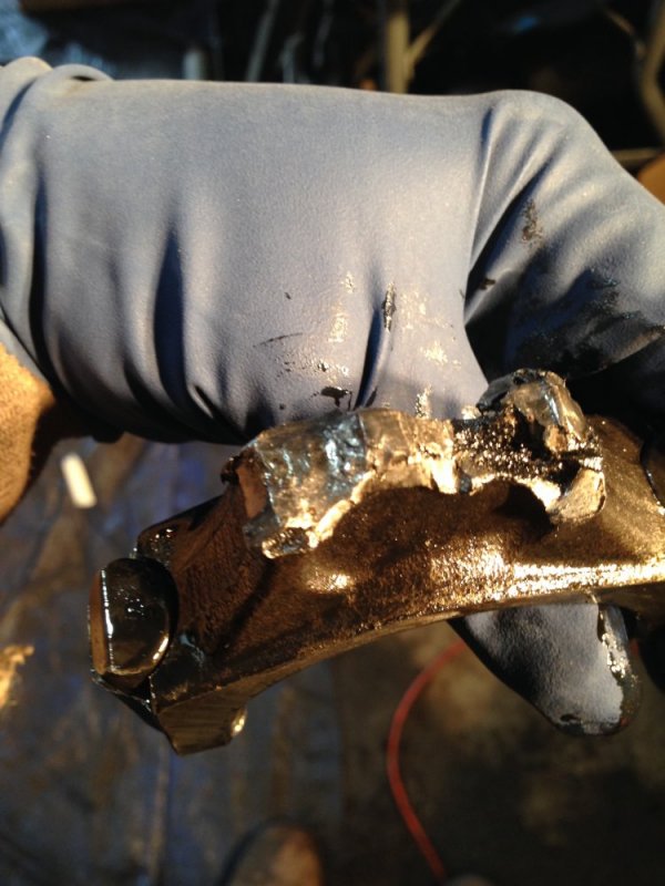

The adventure begins back in November 2018, when the connecting rod in cylinder #8 literally left the building. I had driven down to southern PA the day before to pick up an equipment trailer and tow it home. The very next day I was driving back from town when BAM! something let loose under the truck. I initially thought it was a u- joint. Pulled over and oil leaking everywhere, starter blown in pieces. There's pictures somewhere in the carnage thread, but here they are again. Connecting rod snapped & disintegrated, blowing holes in both sides of the oil pan, and breaking the casting where the starter threaded into the block, giving me a nice 6.5 boat anchor
all that was left of the #8 rod on the crankshaft
Rod took the emergency exit through the oil pan
Block officially trashed
Not sure if the pitting seen in the rod on the right side of the picture is indicative of anything wrong in the metal, but here's one more carnage pic

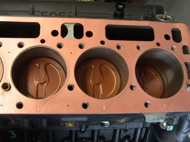

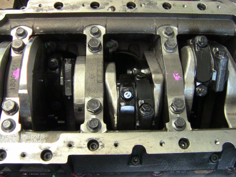

The P400 was purchased in May/ June of that year. I was thinking it would sit in the shop for several years until I needed it, but clearly the truck had other plans. I knew I wanted to have some upgrades done to the engine, such as porting the heads, timing gears, and head studs to name a few. Once I looked at the cost of shipping individual heads, it was clear to me the better option was to ship the entire engine to Chris. For only $230, the engine was shipped from western NY to @Twisted Steel Performance in S.C. to get what would be some serious upgrades.

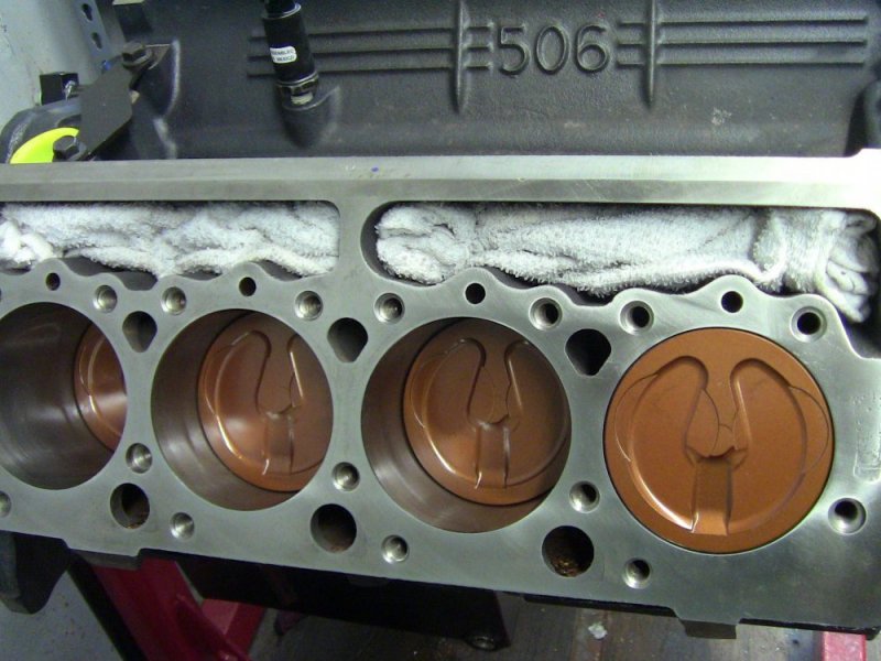

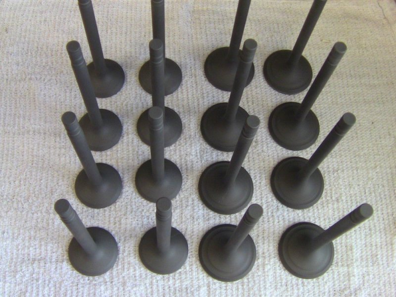

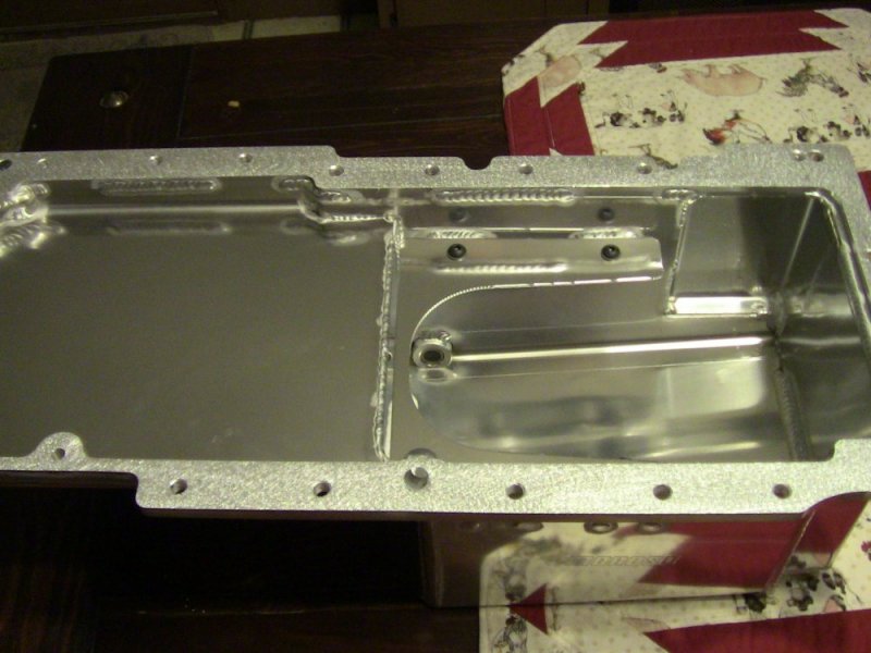

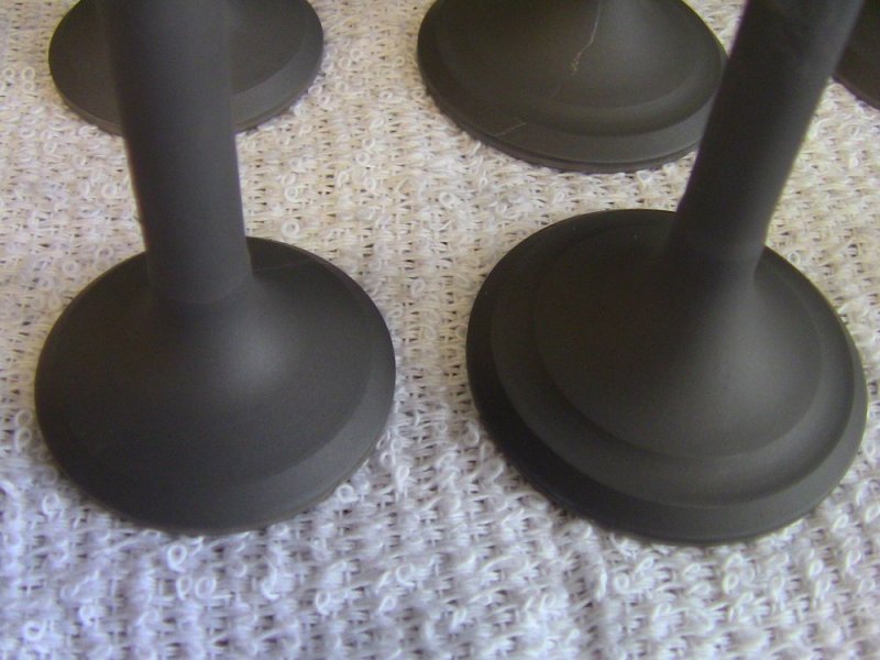

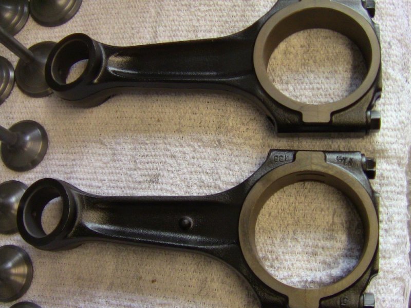

With the engine in good hands, it was time to make some decisions on what exactly to do upgrade and performance wise. Perhaps still a bit traumatized from the connecting rod blowing up, I decided to have almost everything that could be taken out coated with the applicable thermal dispersant/ wear resistant coating. The following parts that were coated are as follows:

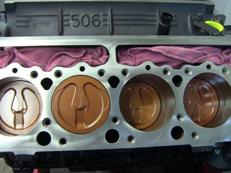

Piston tops, skirts, undersides, wrist pins, connecting rods, rod bearings
Oil pump
Timing gears (DS4)

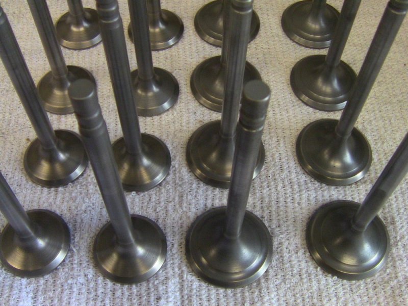

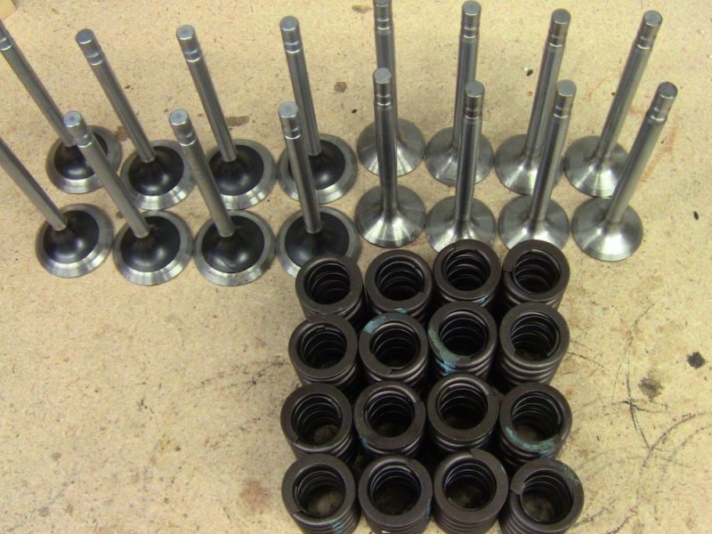

Cylinder head intake/ runners & valves
IP drive gear

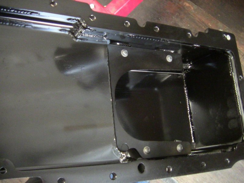

Oil pan (inside & outside)

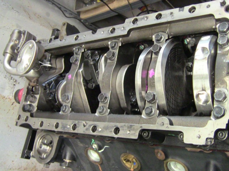

Pretty much everything in the crankcase was coated, save the camshaft. Had I known at the time that cam bearings are a weak point in the 6.5, I would have included that too. But I told myself I had to draw the line somewhere.

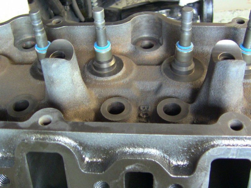

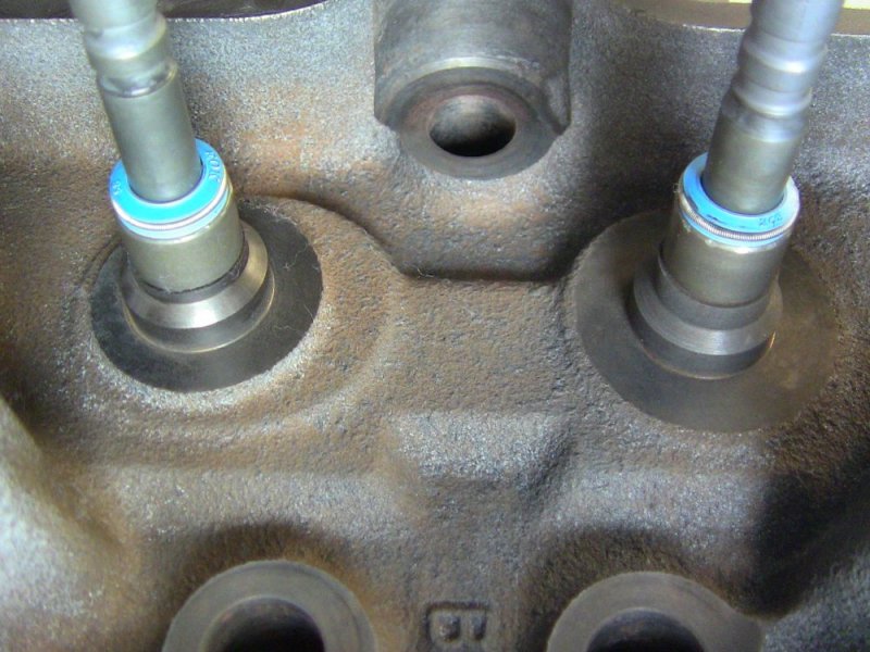

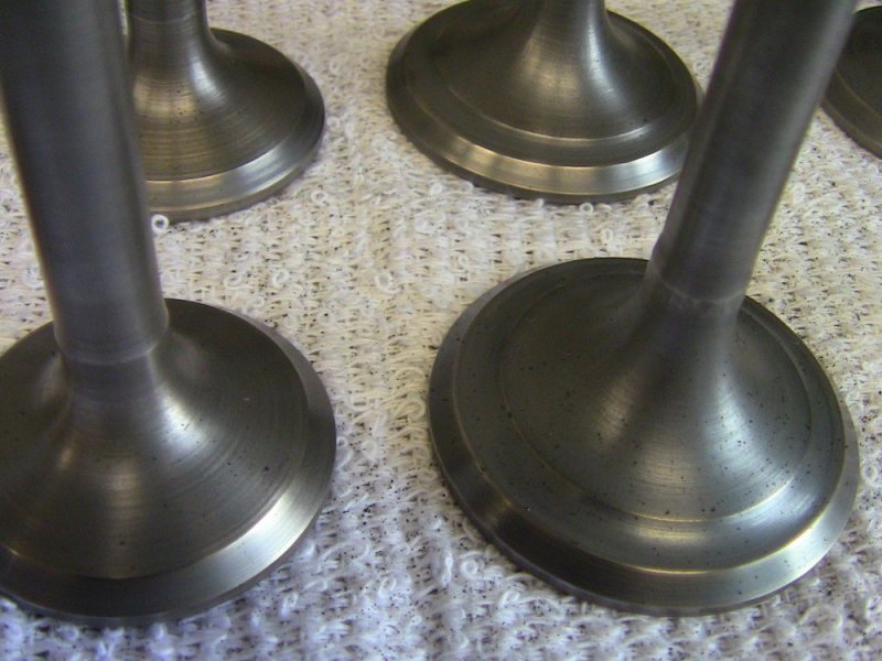

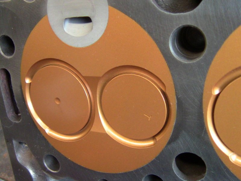

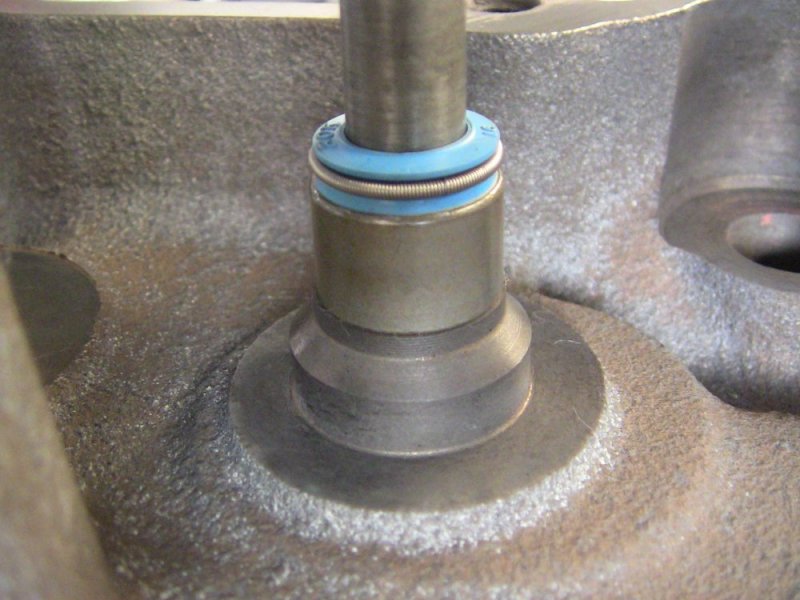

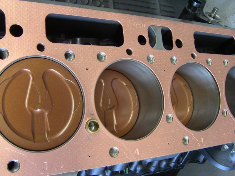

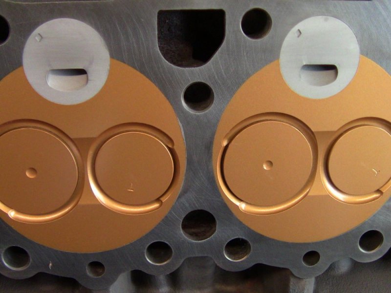

In addition to being coated, the heads were also ported, and the valves were unshrouded
Pistons were machined down to 18:1 before coating, and gapless 2nd rings were installed too

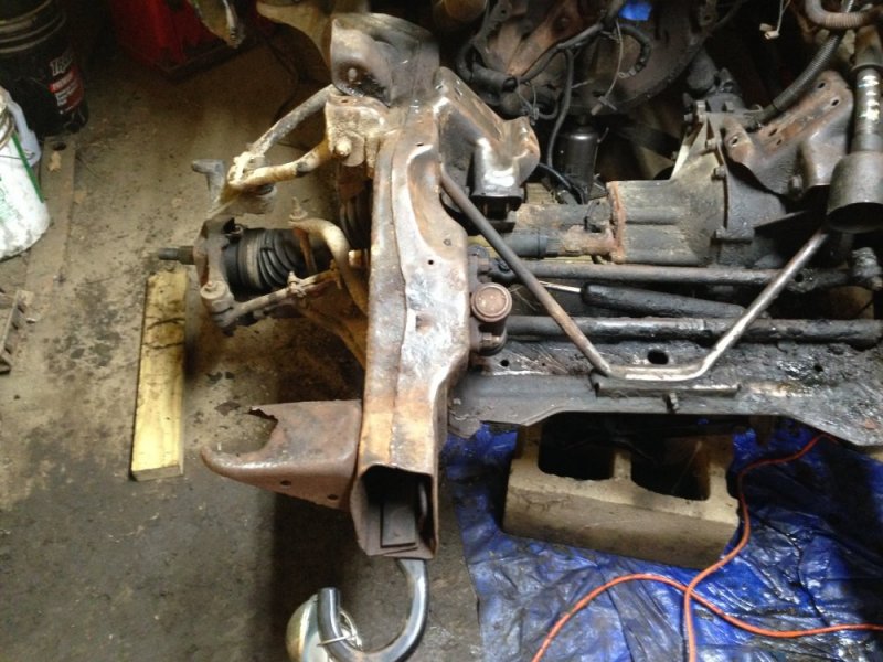

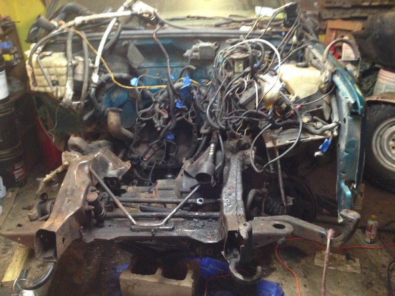

With all the work being done on the engine over the span of a few months, I decided to do some cleanup/ restoration on the front clip/ engine bay of the truck. The truck is really clean for a 1995, it came from Maryland originally and I purchased it in 2016. With the engine bay empty, the truck was pushed into the shop (doesn't fit in all the way, had to nail a tarp around the opening to somewhat keep out the winter weather) and I proceeded to tear the truck down to the frame as much as felt comfortable for my amateur rank.

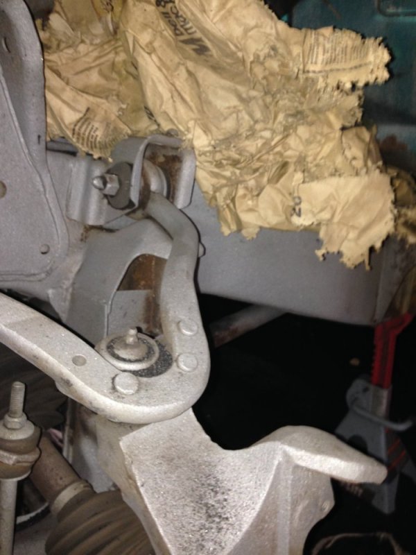

Removing the whole front clip and passenger inner & outer fenders is pretty easy. I left the driver side outer fender on as it was easier to have it there keeping the fuse block and some wiring out of my way

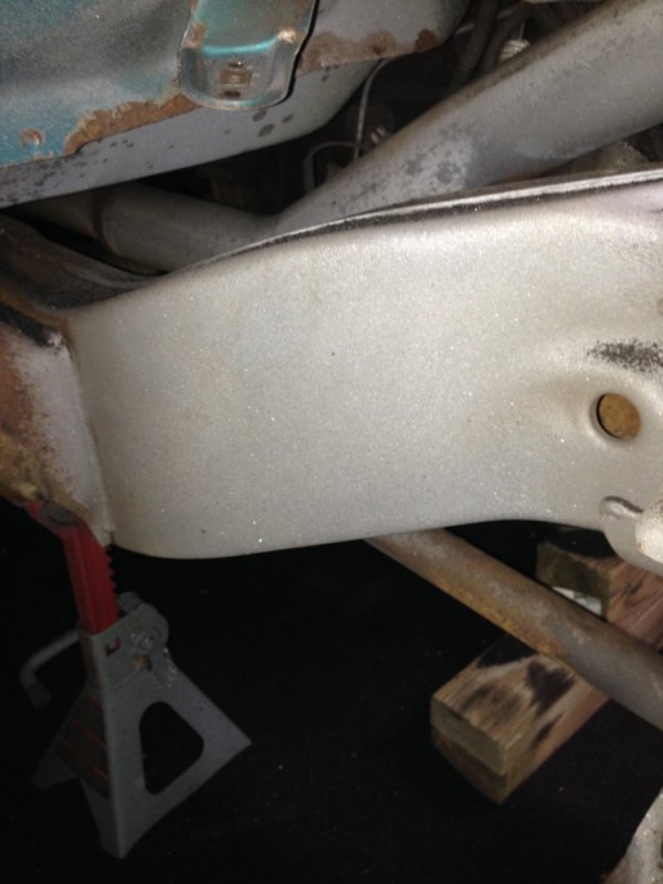

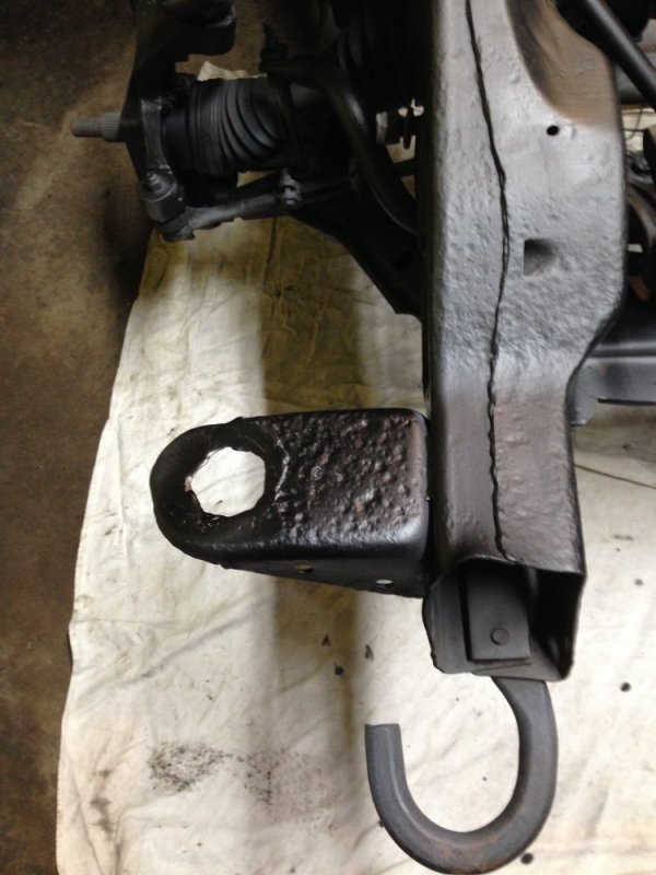

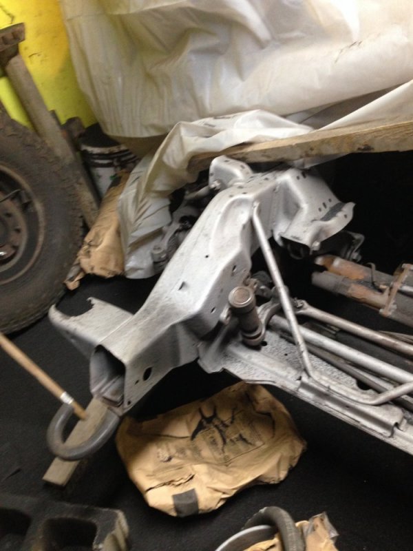

The frame was somewhat greasy and dirty, but in pretty good shape for the year. The only thing really needing attention was the passenger side core support mount

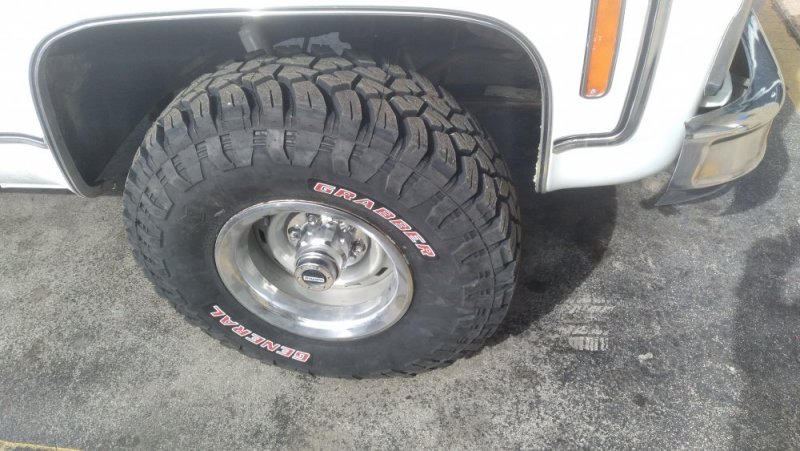

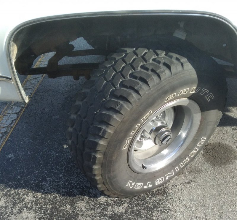

Did get new shoes put on the mule yesterday...rides like new money. Had 17 y.o. murders on it. The suspension is working much better with these...33×10.5 - 15 General Grabber X3
Old crappy mudders....

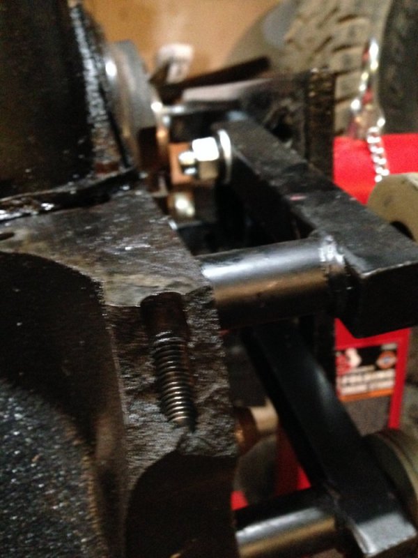

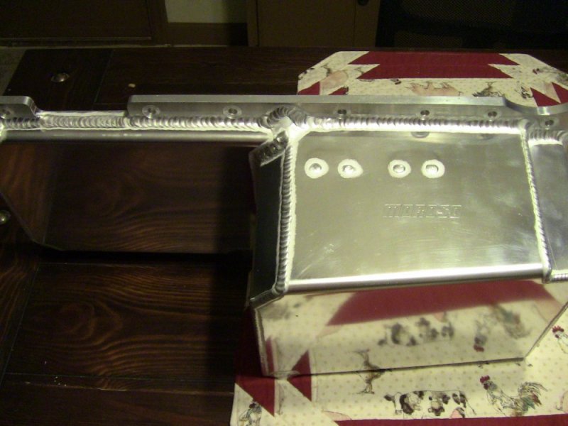

@WarWagon yes one of the rod bolts snapped off, I think it was from the broken rod smacking it off on its way out of the oil pan. I think I scrapped the rod bearings and caps long ago, although I still have the pistons and blown oil pan in the scrap pile. Engine is still on the stand, I'll actually be putting the pan and heads back on there as a mock up engine so I can maybe one day get around to making the custom front crossover using the Banks sidewinder exhaust
I'll snap a pic of the inside of the block and the #8 piston, there is only a nub of the rod left connected to the piston. When things broke loose it absolutely trashed the bottom of the cylinder. To this day I have no idea why things grenaded like it did. The engine didn't have much blowby, but did leak some oil at the IP. Upon tear- down I discovered the IP was held in by only one stud, the other two were back in the valley! I have no idea how the thing ran as well as it did, let alone stayed in time. Aside from #8 being a known weak spot in these engines, I don't think I'll ever know the cause. I had towed the trailer back from PA the day before and with 4.11 gears at the time was running close to 3k RPMs to keep pace with traffic, but aside from that I got nuthin 🤷‍♂️

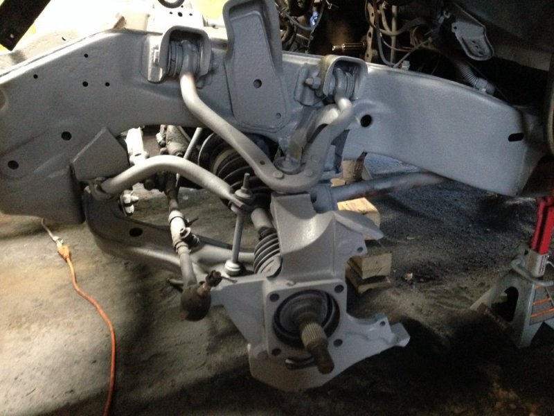

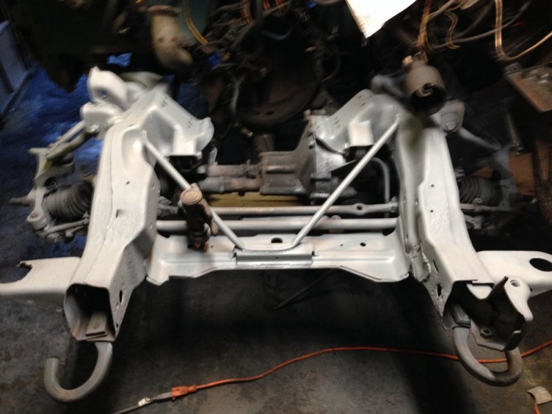

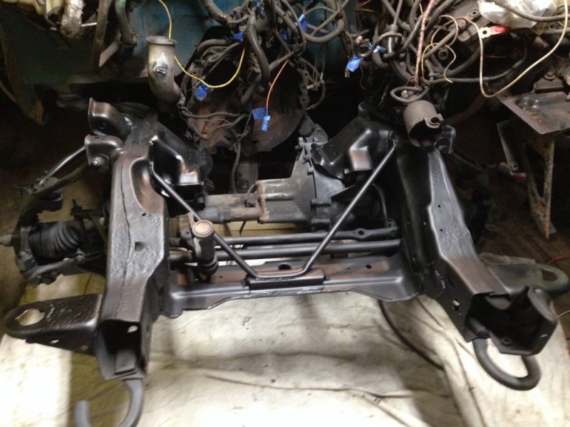

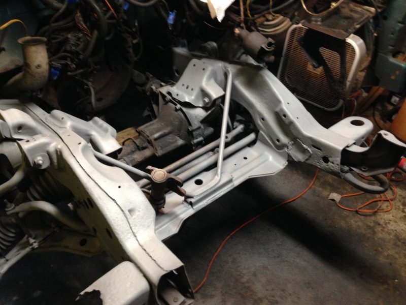

Anywho so after sandblasting the frame I got it all primed and painted. Had I known at the time about Por15, Durabak or was sponsored by KBS like @n8in8or, I would have elected to use any of the aforementioned superior products. However, I didn't know then what I know now, so the frame got 2 coats of rust preventive sandable primer, followed by several coats of Duplicolor low gloss engine enamel
little blurry but all primed up
Painted in all black

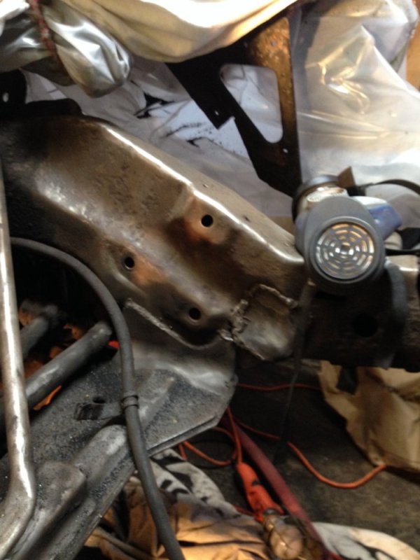

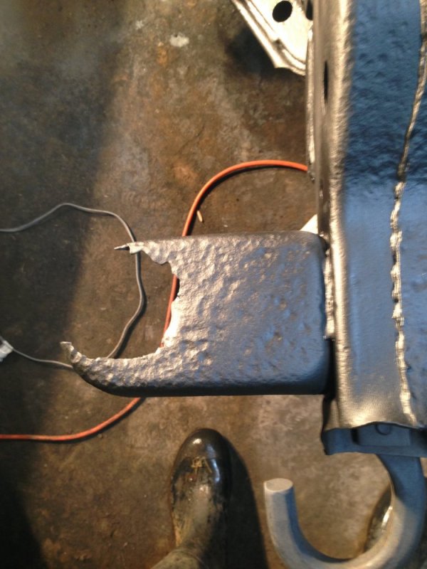

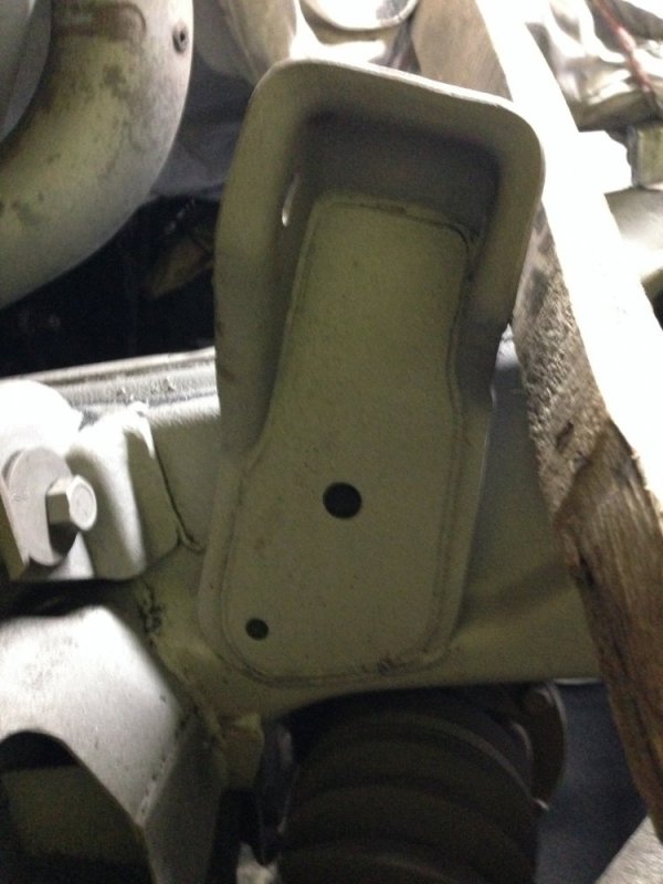

Did a little repair on the rusted core support too:
before
After

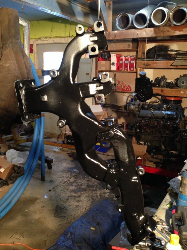

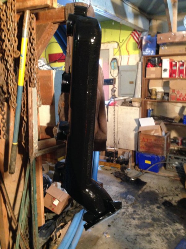

I also got new exhaust manifolds, as the ones on the truck were rusty and I wanted new mannies on a new engine. I also painted and primed the manifolds, but it ended up being a waste of time as the paint was falling off within the first few weeks. Future manifolds might get sprayed with KBS exhaust paint before getting exhaust wrap. Again didn't know nearly as much then as I know now, this was my first solo engine swap.
But at least the manifolds looked nice all painted up
