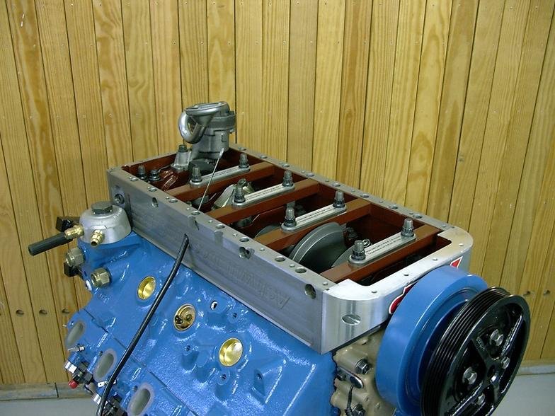

If one already had a 2001+ optimizer 6500 longblock, could they refit it to be on par with a p400? From what I know, you would need:
Most importantly, would the retrofit described above have 98-100% of the durability and power potential of a virgin p400?
I'm particularly interested in the structural/metallurgical differences between a bare optimizer block and a bare p400 block and if machining and/or cryo treatment could make up the difference.
- A bedplate, custom CNC'd from scratch to fit a vanilla GM/optimizer 6.5.
 - Custom oil pan
 - Forged crank
 - p400 rods and rod bearings,
 - p400 pistons
 - Complete p400 heads
