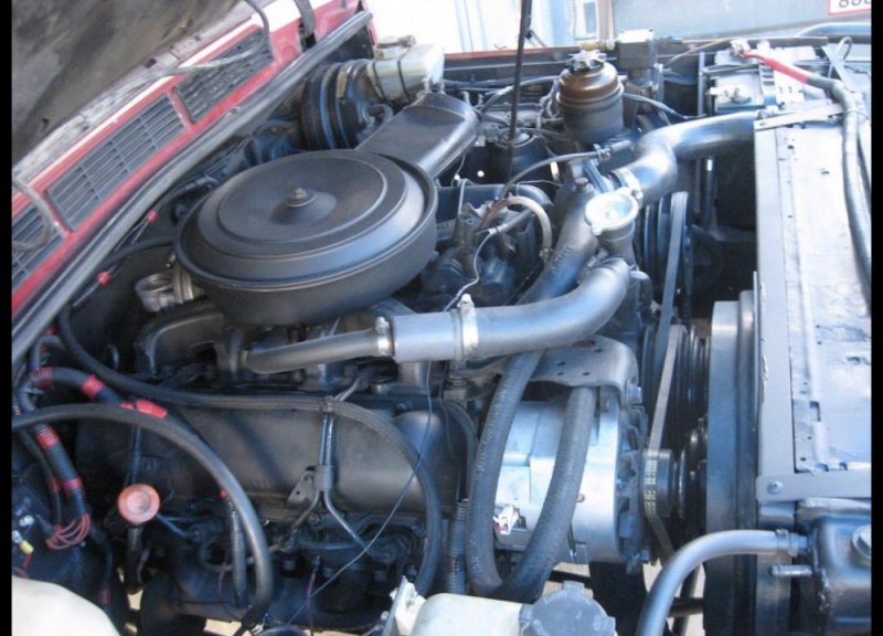

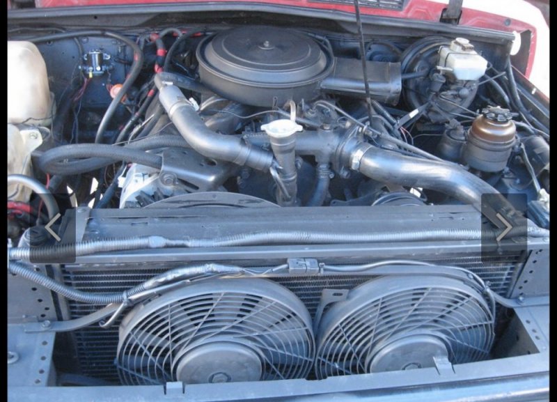

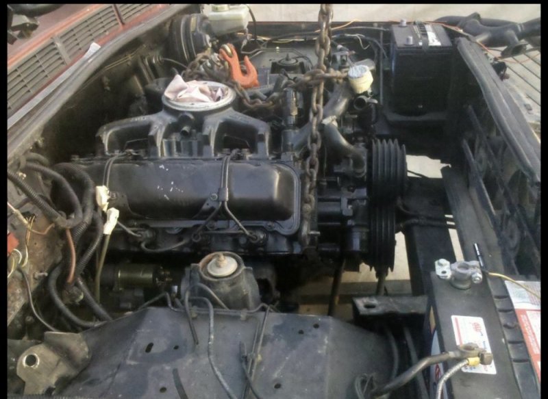

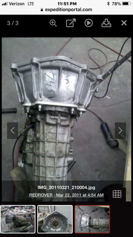

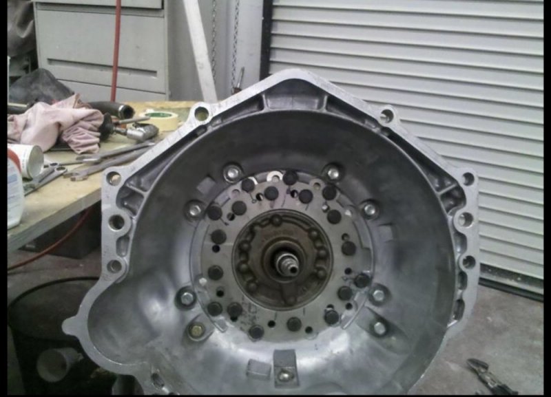

Pics below are from my previous swap,
if u see I made an adapter using NV4500 bellhousing to bolt ZF225725857259572605726157262

Seeing as the early responders are not really answering any questions . . . ;)
I can take care of a couple of items:
- Yes, there are two possibilities for gear ranges and IIRC the difference is in 1'st. I had all the details at one time, but apparently deleted it when I did a data purge.
- From a best year approach, am not aware of one year any better than the other. The only notable thing I found was that for some reason the ones that went into a Dodge had issues with the 5'th gear retainer nut. There are fixes for the Dodge issue.
At the risk of insulting, there are 2WD and 4WD versions where the internals are the same.
There are differences in the GM bellhousings due to the hydraulics, so you will probably need to source the matching hydraulics to go with the bellhousing. IIRC, the date ranges for interoperability are 94 and earlier, 95 is a stand-alone year, and 96+. Seeing as this is not for a GM build, it might not apply though.
