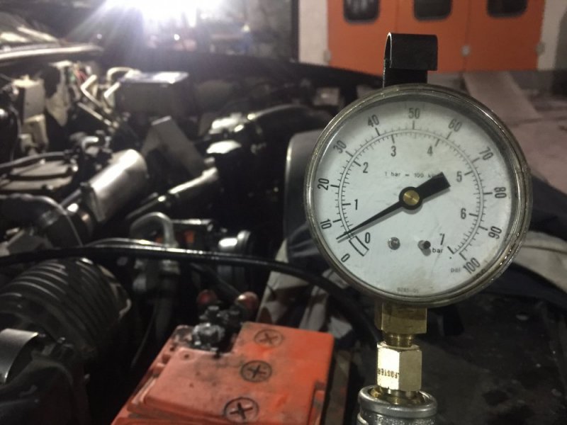

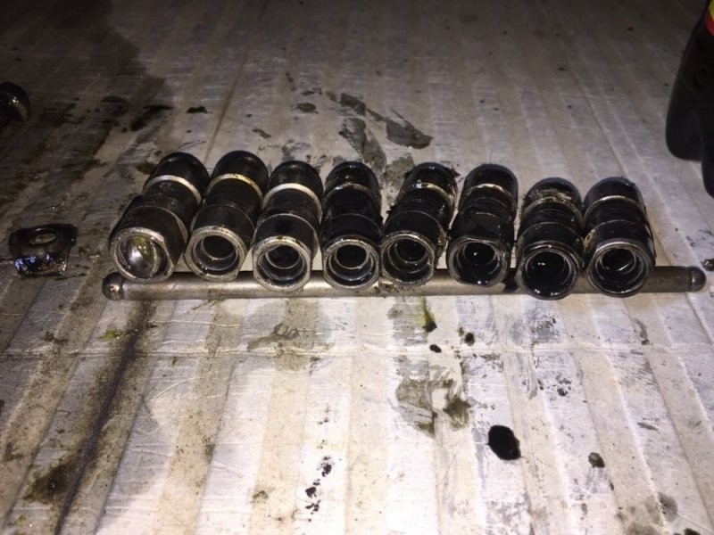

It is hard to hear exactly like we would in real life. But I think I am hearing noise in the valve train.
Are the lifters holding their pressure? Is there any freeplay in the rocker arms?
You need to put something on to test the timing to verify.
Today I adjusted the timing of the injection. I used a stroboscope for a diesel engine. Now the diesel is a little smoke at the start. I think that one glow does not work. Thank you everybody!
Today the diesel litle smoked and shook again. I disconnected the connector from the optosensor and the smoke disappeared and the diesel working good. After I connected it and diesel smoke again. Tomorrow I'll replacement the optosensor and camshaftsensor. Oil pressure is OK.
