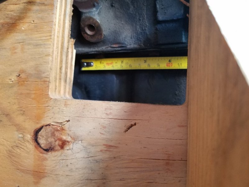

This is the best I could do. Same side as the starter but a little bit forward of it. The motor is sitting on a wooden crate that my new GEP came on so I couldn't get to the exact location of the starter. I imagine the spacing is uniform. If someone has a oil pan gasket that might be better.

I couldn't make out where the threadded bolt holes are in the pic, but I hadn't thought of using the pan gasket until you mentioned it. I may run down to the local auto parts house and see if they have a gasket in stock. I can possibly take a pencil tracing between two holes and use as a template pattern. I'm just hoping that this idea of a support brace will help things. as the moment, with the new flywheel installed it cranks and starts perfectly :) but then again it worked flawlessly before for about a month until things started moving! I've gone through two bent rear brackets and two sets of starter bolts in the past 5 months. Only this time it was more severe. Thank the man above that the block repair didn't break!

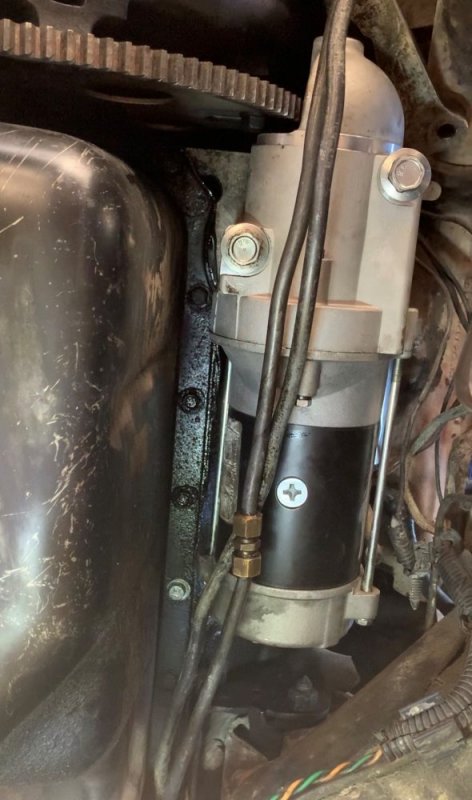

Here's a photo of the starter mounted after I got the flywheel replaced. I'm wanting to use the two bolts on the oil pan where the silver bolt is on the pan and the next one between the pan and the starter to mount. there is maybe an 1/8" to 3/16" or so clearance between the side of the starter motor and the block (pan mounting surface) where I would wedge the angle to keep this from happening if that makes better sense.

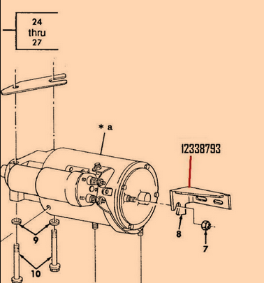

The bracket for the Hummers might be a better option instead of the flimsy one GM had. it just doesn't look like it's well designed to take much force. you wouldn't happen to have a pic of one or a part number would you? even one of those baby high torque starters might be an option too.
Just googling online I found this photo. Would this be the starter bracket for the Hummers? this one looks as if it mounts to the block. Looks like a much stronger design compared to the GM bracket. maybe I could engineer this to work better vs my crazy idea I came up with!

You wont be able to use the hummer one. The starter is like 4” longer. Also incase anyone tries- the hmmwv/hummer starter bolts are different also, like 1/4” longer for shimming. NEVER reuse shim-able starter bolts (even old 6.2) with the new high torque starters. It is a pile of hurt coming over a $10 cost.
