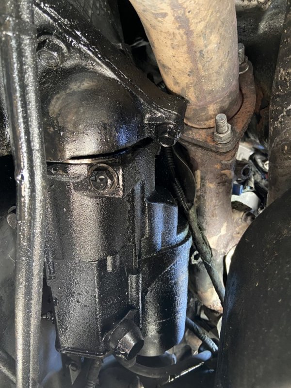

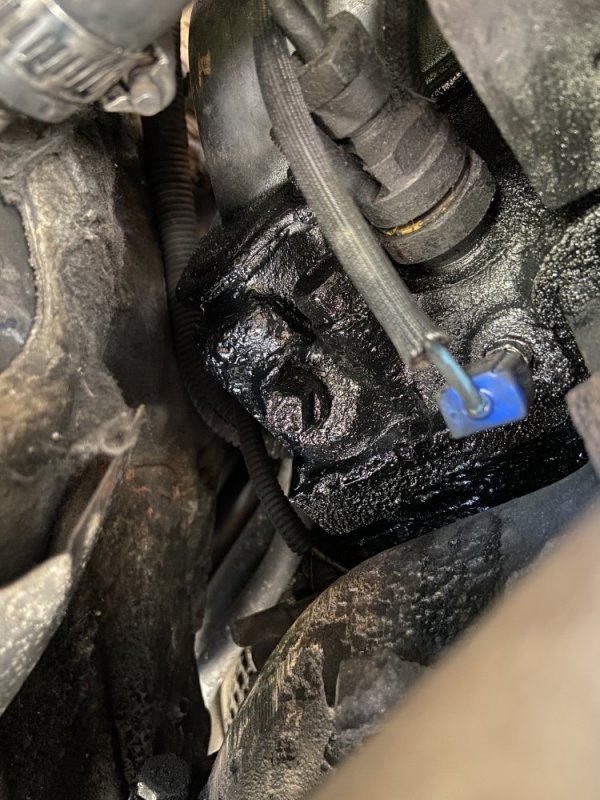

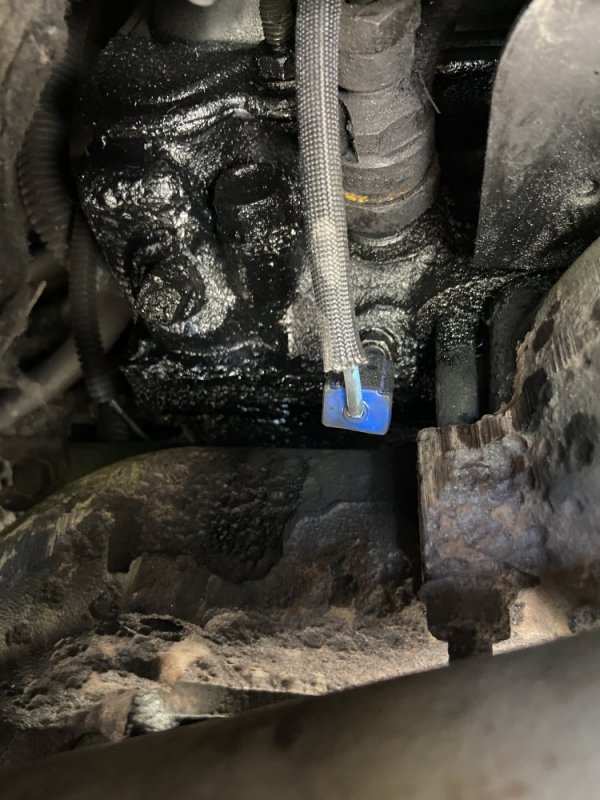

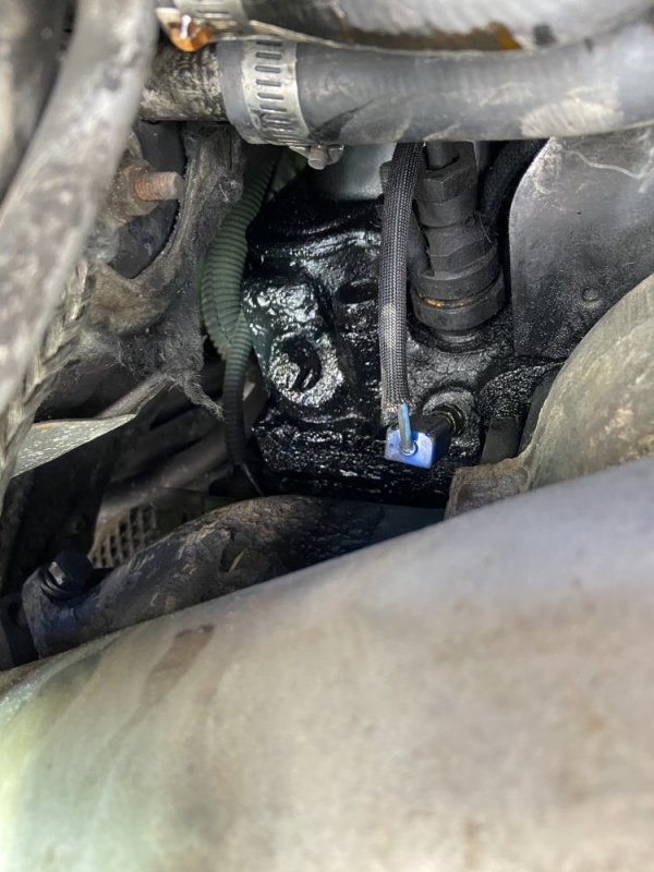

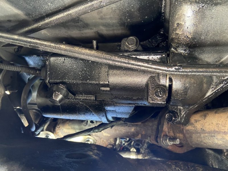

Decided to post a new thread on this oil leak on my ‘99 K2500 Suburban. Oil leaking down onto the starter. Have ruled out the turbo oil drain to the block as the source. It’s definitely coming from above the starter and really from above the rear fuel injector. I suspect that this is pointing to valve cover. Hope not, as they are a PITA to deal with. I might as well order the injectors and replace those while I’m in there.

Yup. Not much else to rule out except the CDR gasket into the valve cover.

Current injectors are Bosch Marine from Heath. I will just order the Bosch (India) injectors from Leroy Diesel. Not much I can do at this point.

Drop that starter while you doing it and clean it really well with a pressure washer.
Then hit it with some electrical contract cleaner and let it dry.
Hope it didn’t soak into the brushes and windings. If it is in the windings- use a plastic bristle brush, tooth brush is good, and electrical contract cleaner. If the brushes are soaked try cleaning them with tooth brush but expect a shortened life.
At first signs of problem, send it back for rebuild at powermaster. Doing that before extra parts gets damaged is worth the hassle. Could be a $75 fix instead of entire thing ruined.
Clean the flexplate too, it’s most likely soaked and will re oil when it runs again.
Check the battery cable and again contact cleaner if needed.

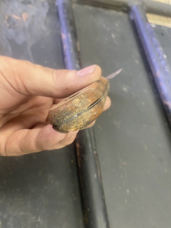

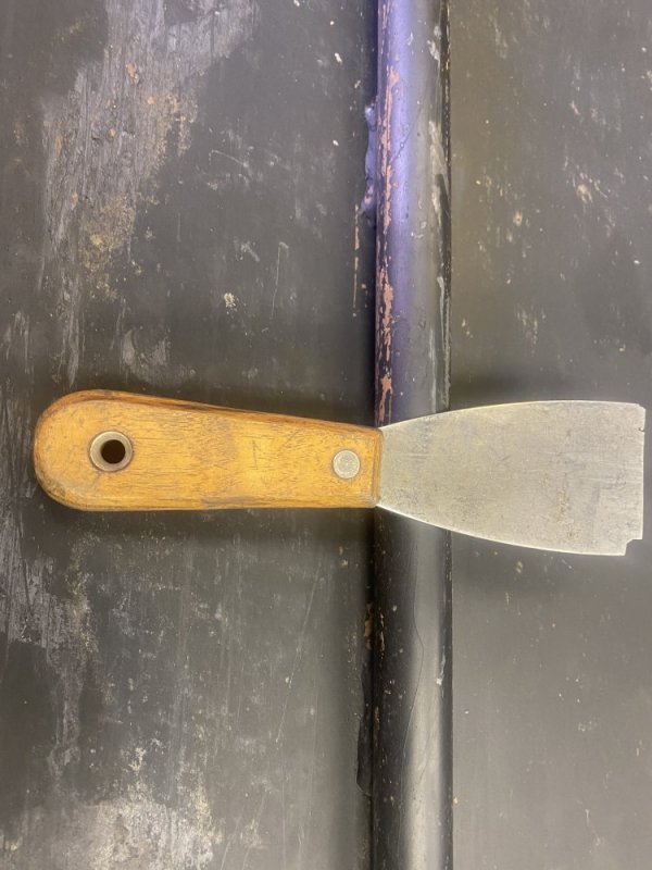

There is a trick to removing valve covers , oil pan, etc. without ruining them. Use this style scraper and hit with hammer driving around the valve cover to separate from head. As you see the broken corners (this one has done probably 3 dozen covers) it will ruin the corners. Just cut it off and keep going. Seems 2” wide blade is beat for me.
Note the metal goes all the way through handle. This is critical.
You can get about 95% of it all, then the rest will pop off with tiny prybar (aka cheap screwdriver).

Known as "full tang" making it strong...

Grind away some of the handle from the end of that scraper. If the hammer peens the end of that steel shank, it will split the wood handle. That Mine friends is spoken frum duh voice of experience. 😳😵‍💫😩😹😹😹🤺💨
Full tang!! That’s what I was trying to remember.
The wood is two different pieces riveted to each side. It won’t split Marty.
