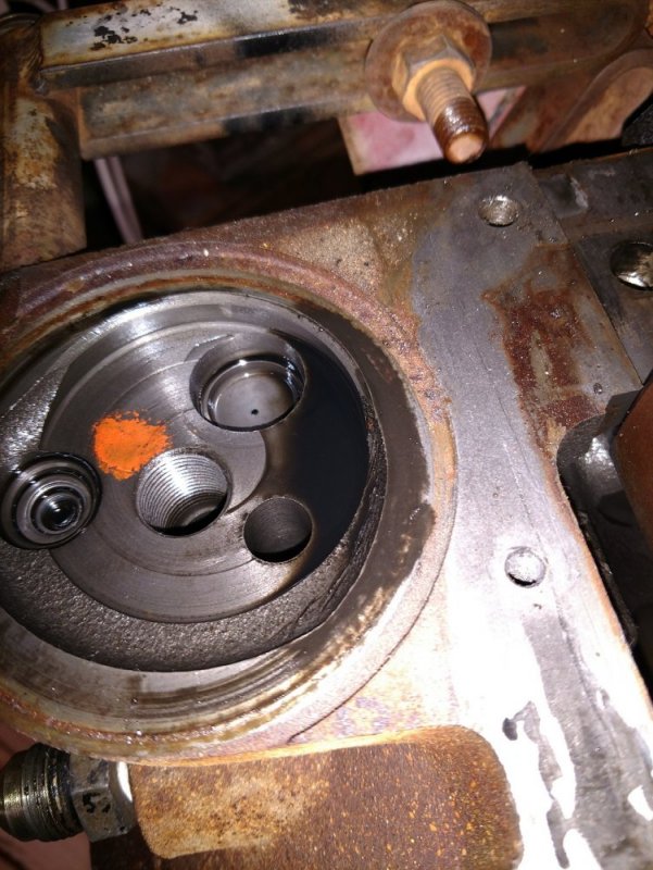

I have mine blocked,with a tiny hole drilled in it. Without a bleed hole , sometimes after an oil change,it would loose prime,no psi untill I would loosen the filter and bleed it.
So you suggest the bypass helps the system prime? Are you running a bypass valve equipped filter?

I have ran both ,my favorite is the 1060R . On this motor the cooler is deleted ,and freeze out plugs in some of the holes in the block. I didn't decide yet on this 506 build ,but probably will use the 7202,and plug off the stock bypass.
@6.2 turbo so the 1060R shows no bypass valve.
But you said sometimes it bleeds off-thats a bad anti drain back valve.
As for having your bypass valve blocked then a hole drilled in it- please explain.
Blocking it so it cant open forcing 100% filter or starvation, right?
Has anyone looked or done: remove the bypass completely?
I would think that would allow more flow, then with a non bypass filter- you would have your same results but more flow.
Before I figured out that it needed a bleed hole, I was just using a regular 1060. If you would leave the bypass open totally, then lots of dirty oil would get to the bearings.
I assume you know there are 2 bypass valves, the hidden one is for the cooler,and removing the freeze out plug that forces oil through there will majorly increase oil psi. But then the cooler is deleted.
So is that, oil psi increase trick, what I am looking at on my 'replacement' engine? 6.2 Hummer engine...
56079
Yea, if you don't need the cooler.
So I need to plug this small drilled hole? I literally live in Hell so bypassing a cooler would be good for this here coldest winter on 'Hell froze over' 40-year cold winter record. Summer would fry things. :banghead:
I think that little hole in the cup is just to keep the oil cooler bypass valve from hydro-locking??? When it bypasses doesn't it flow through the same entry hole to the outer area of the filter media.
The cooler bypass should work nearly the same as the oil filter bypass. As in it will create a certain psi differential across the cooler. I have never heard what that differential is. There is no thermostatic control of the flow through the cooler its just simulated control with the bypass resistance differential.
