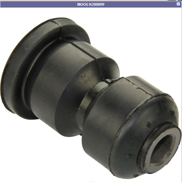

Here's what the rear bushing looks like for the forged LCA:

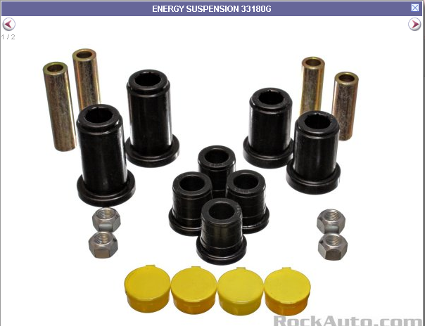

Compare that to the Energy Suspension kit:
I see that the kit includes bushings for the upper and lower LCAs. Maybe the instructions are referring to the upper LCA bushings which do have outer steel shells?

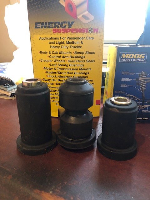

Revisited the ES bushings and it looks like I don't use the shells. I tested them in the LCA and they are a snug fit. The rubber Moogs are a bit wider, but look like they're designed to compress when pressed in. Guess I'll use the ES.
