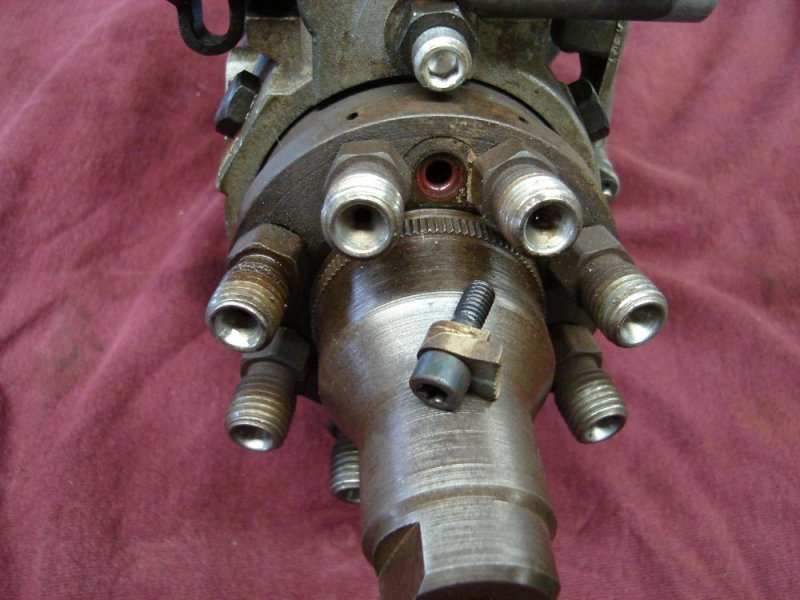

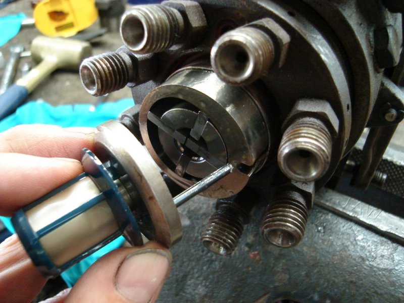

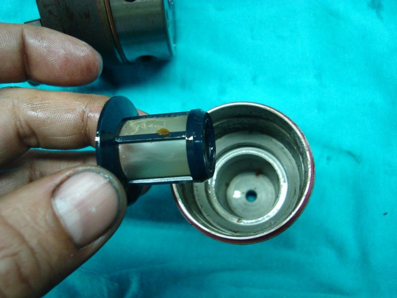

The solenoid swings an arm that pushes a wire spring that spins a pilot valve in a bore to open/close main fuel flow.
There is also a very fine screen in the cone on the front of the IP that could plug, tho that's rare.
Screen:
Screen:
