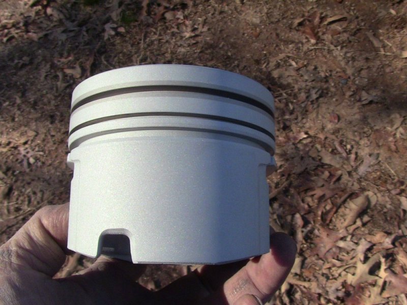

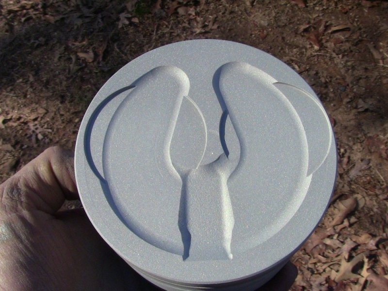

I have my set of pistons prepped to send off and get a fairly new treatment process done. DiamonDyze is a treatment used by ALL top fuel teams and most big HP builders. This is a treatment not a coating, it provides much greater Thermal & wear protection than hard anodizing alone and treats the entire piston not just the top. I will have them leave the "sealing" process off and I will apply my coatings when they return, added coatings aren't necessary but will add another layer of protection. This will provide added benefits while making these pistons indestructible for life. No more worries about galling or scuffing.. This allows a bit tighter clearances without the worries mentioned and is very affordable considering the whole picture.
Here are before pics with the pistons prepped, all factory coatings half to be removed first. Once they get back I will post those pics.
