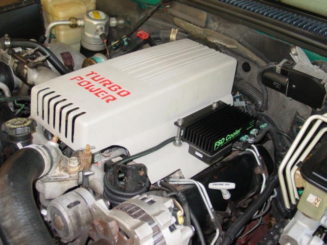

I have a 1995 GMC 1500 with a 6.5 turbo. It had 110,000 on it when I bought it from my father in law and now has 265,000 on it. GM replaced the pump just before I got it under warranty and I replaced that one two years ago. I have replaced the injectors, couple of vacuum pumps, water pump, radiator, heads, (blew a gasket), and had intermittent problem with truck going into limp mode after I replaced the pump. "FINALLY" mechanic friend removed the extender filter to the optical sensor and have not had the problem come back yet,
