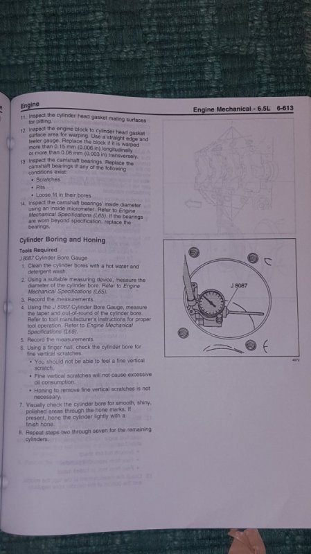

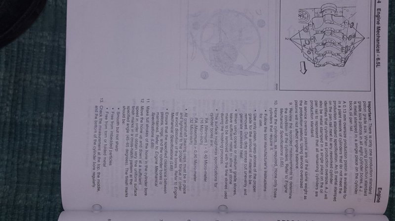

@Corvette502 Here are photos straight out of the GM Factory Service Manual for '98 P/U and Suburban, all engines and drivetrains. The don't list actual grits, just refer to coarse, medium and fine depending on the amount of metal to be removed and if it's a finish honing. I wonder of the dealerships have a standard factory honing kit where the stones are marked as "coarse", "medium", and "fine"? I wonder if a person could call a stealership service department and get the answer? Of note, they do recommend that the hatchmark pattern be intersecting at 45° to 65° angles
