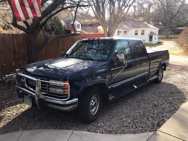

A super clean 1996 GMC 3500 2 wheel drive, 5sp manual. I have owned since 2004. I am the 2nd owner. Has 230K miles I have had the transmission re-built at 210K after having a re-man installed. Injection pump replaced after factory recall at about 120K. I have recently upgraded the water pump and a 9 blade Duramax fan. (from LeRoy Diesel) Amazing the difference in the running temp. Re-located the PMD (also from LeRoy Diesel) to the front bumper after having a couple of intermittent stalls. Have completely re-built the front end, tough job. Now I understand why the high labor cost! Current issue is bad vibration from the gear shift/drive train. Have narrowed it down to a cracked bell housing. Waiting on the transmission shop to finish that repair, hoping it takes care of the issue. Anyone else have/had that problem? They tell me it is quite common.

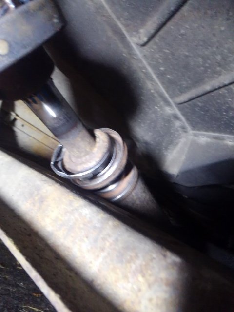

You should check the mid shaft bearing, it will cause a vibration and it will add to the stress on the bell...
Honestly if you have it apart anyhow, change the carrier bearing. It's like 15-20 bucks. And the tranny seal where the shaft goes in . I think that's like 25 or 30. And the rubber mount was 10 I think..if it's already apart even if they weren't being a problem, just get it over with. 60 bucks to save future head aches..that bearing will shake the truck to hell when it goes. Mine completely descintegrated a couple weeks ago..that was a fun ride home.IMG_20201022_190407.jpg
