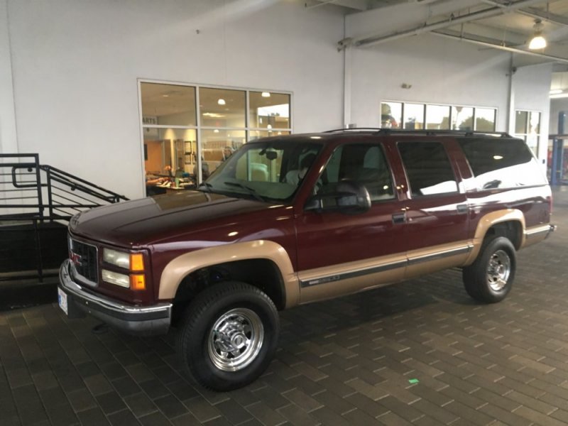

New to the forum, hello, this is my ride.
