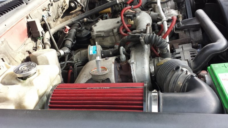

Pic of turbo master and air filter I have plugged the hole in the intake tube.

Did it smoke on acceleration before you modified into the turbomaster? Smoke at start up isn't abnormal. Where's your compression and what blow by? Video?
Do not start "playing" with ip, until you know everything else is like it should be. Compounding problems is an easy way to burn through money and add headaches.

On a budget I suggest going back to stock by removing the homemade TM and going back to the vac system. Without a boost gauge and ECM tune it's going to cause you more trouble than it's worth via turbo over/underspeed, ECM defuel to save the engine, smoke, MPG loss, etc.
At 65 MPH I can run 0 boost so cranking up the boost just to have it is not required and sucks fuel to spin the turbo and heat up the intake air.
To be clear: you got to pay to play. Only a larger turbo with tune will give you better MPG and power and is the exception to this rule.
Otherwise to get more power that you appear to want a tune is the cheapest start on stock or little more money with a 'engineered' Turbo Master and boost gauge. These engines are capable of pulling hard to the redline vs. the anemic power they have from the factory. Not a high power modern diesel, but, they can get out of their own way.
