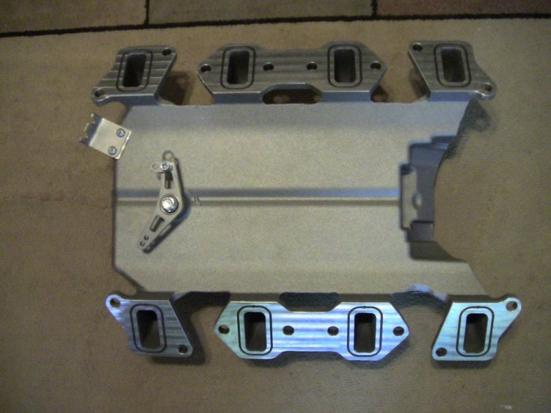

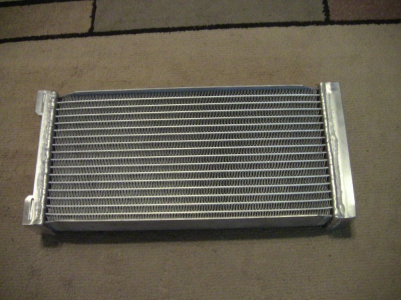

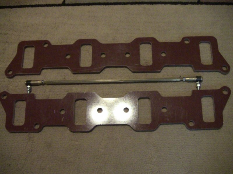

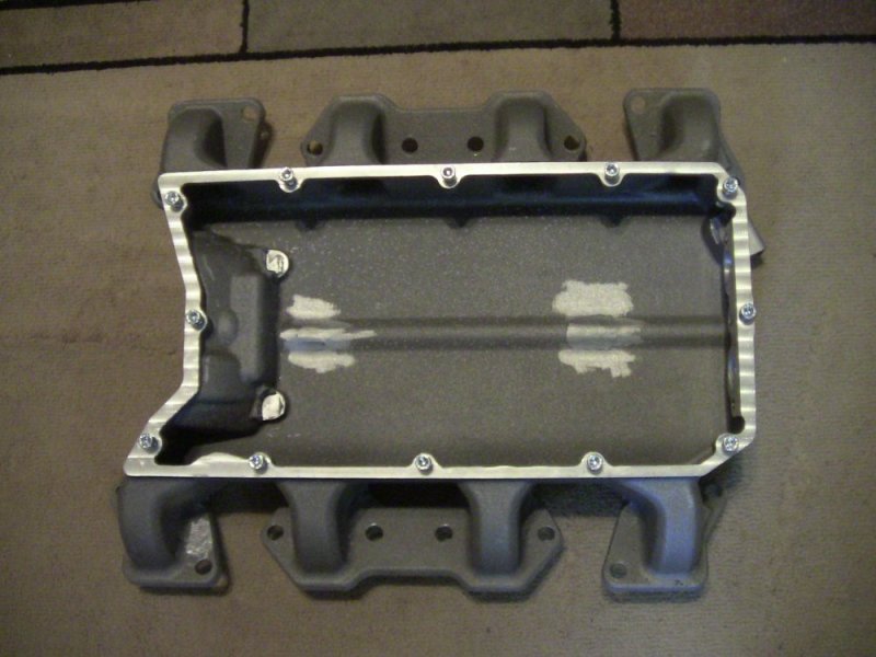

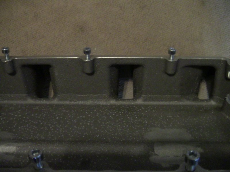

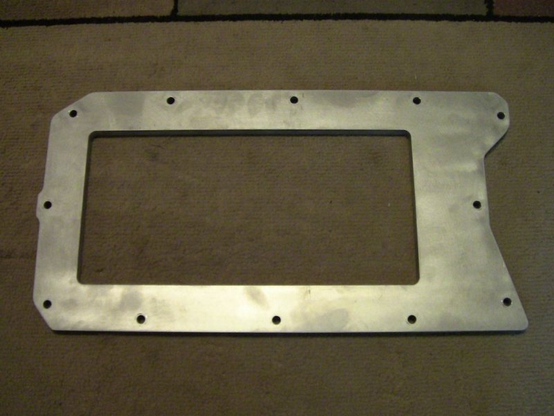

My new Bullet intake arrived, it's a nice casting and well though out. Water/Air cooler fits inside, o-ring flanges, phenoilc spacers, and the throttle cable can be run under the intake..
I'm working with a engineer at work on a turbo top, I will post pics of that once the cad drawings are done..

Nice!
Forgive me for asking, but is this cooler meant for fresh cool water from a add-on tank or from the engine coolant to run through?
I'm guessing it could be work for ether or depending on the climate maybe?
Just a thought on having colder than ambient temp water for the cooler. placement on the water tank would be better in an area under the truck away from the sun. and maybe having a small radiator with a mounted fan under the bed to circulate and cool the water before it's run through the cooler in the intake. honestly depending on the flow rate and size of the cooling radiator, you might not need a tank to hold water.
but that was just me thinking outside the box lol.
Just another thought... though I might be barking at the wrong tree again.
this is something you'd have to experiment with, but I was reading up on the idea of liquids passing through an orifice similar to how our air conditioners work to raise and lower temps. it's called the Joule-Thomson effect. it only works at high pressures for water to change temps but what if you were to somehow aireate the water flowing through the cooler at low pressure using a pump like the ones used on the WMI systems or an AG sprayer, having some sort of orifice before the cooler. Adding things like alcohol to the water making sure to keep it non flammable and non corrosive for the cooler. you might be able to drop the temp of the liquid an extra few degrees more than what an external radiator with a fan can do alone.
That is exactly an air conditioning system. The orifice would be an a/c orifice or txv. If the ‘water mix’ is say r134a or whatever r12 replacement he is running- that way they are the same. It would make the little heat exchanger in the manifold an evaporator and the outside radiator into a condenser. Then only the compressor is missing in place of the little water pump.
To actually make it work- using a suburban with rear air set up in the pickup, only the ‘rear air’ pwrt would be the evaporator in the intake manifold. And using the rest of the existing a/c system like normal.
You would only want colder water, always. Even freezing temperatures outside and a cold start, the ambient temperature water wouldnt make it any colder starting than just straight air.
Now if only that was an evaporator.... haha

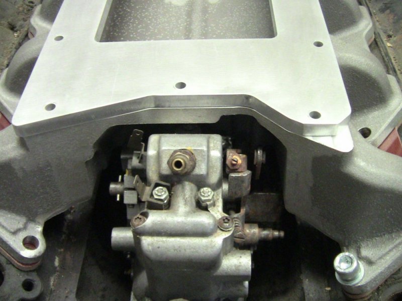

Wow, that is snug. I remember them saying the spacer is phenolic so it stops a lot of the heat transfer from the heads to the intake- toral genius move there imo.

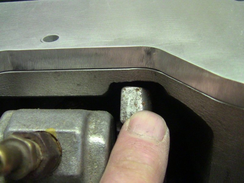

If the db2 had an aneroid, do you think it would clear the intake?
DieselAmateur has one of my pumps that had the aneroid, but I doubt it would, there isn't room, and this was all designed to use the spacers, it won't fit without them.. And look at the room without the cooler and the runner design, I would bet it flows very well over the stock stuff...
