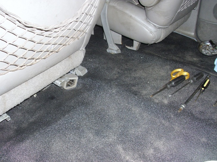

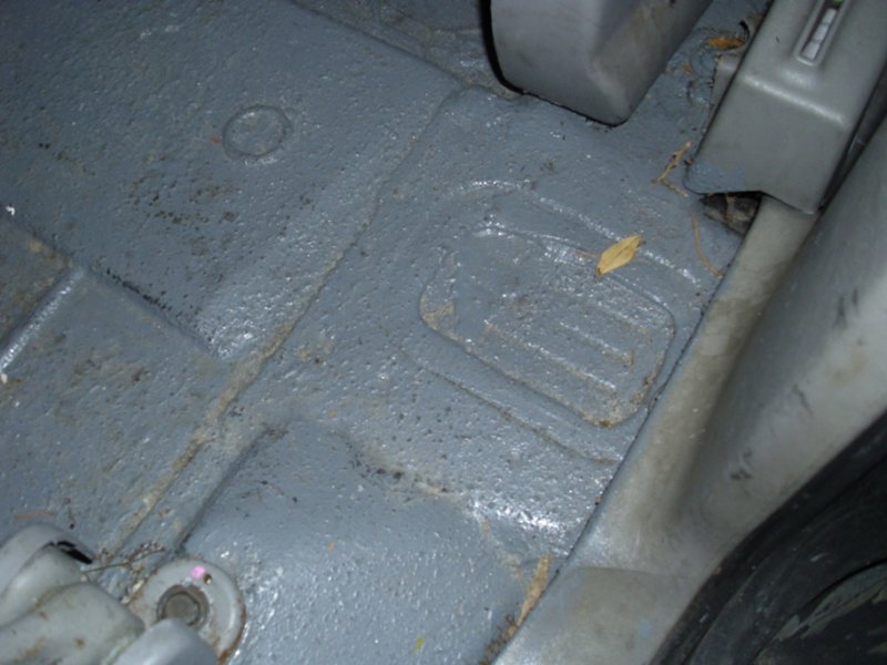

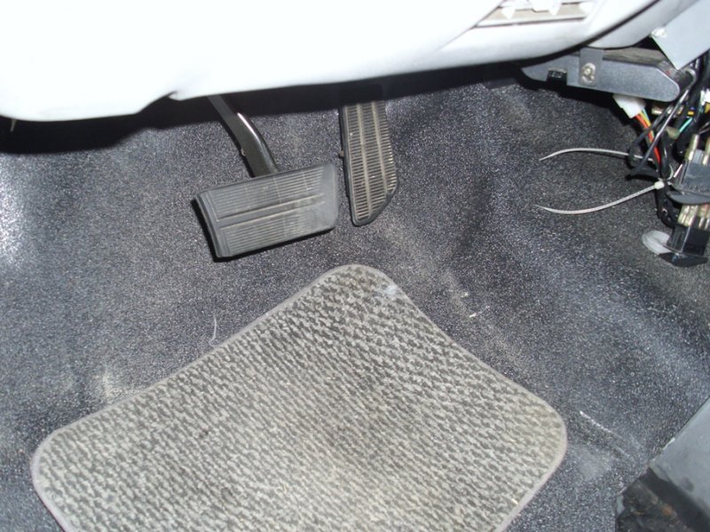

Out in the cold say below 70 deg f is a bi__h. I recently did my Burb flooring w/polyvinal after about 2 years w/just DuraBac install on floor. The DuraBac is MILSPEC naval deck coating with UV protection and non skid surface.

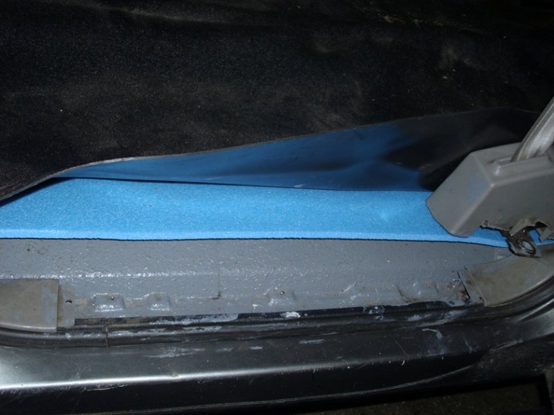

The heat load from the diesel exhaust required I used a good quality heat barrier so DEI tunnel shield "1.750 deg f direct heat rejection" was installed in front footwells and under seats then down passenger side followed by seal cell sleeping mats 6 all toll then the polyvinal flooring over that. I did not use the jute as it absorbs water and causes all kinds of issues from mold to rust if water does get into the mix then I just remove the door opening floor sills and laet blower sit on for awhile to dry it up!

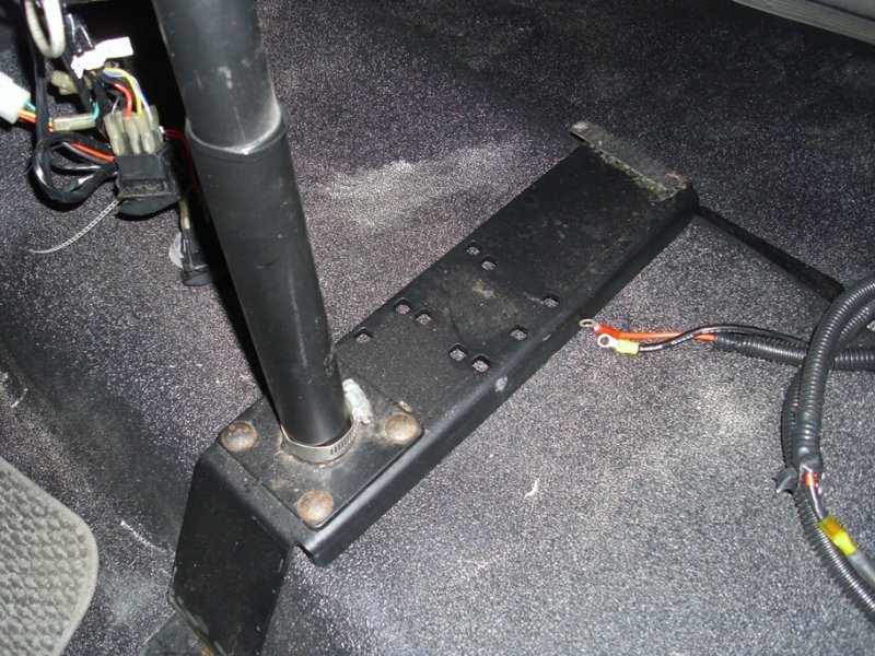

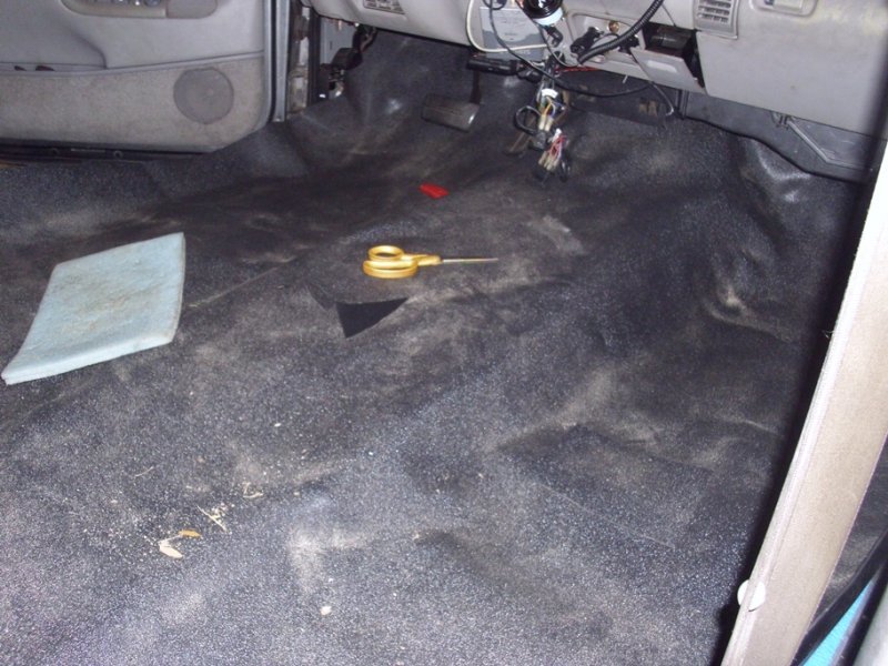

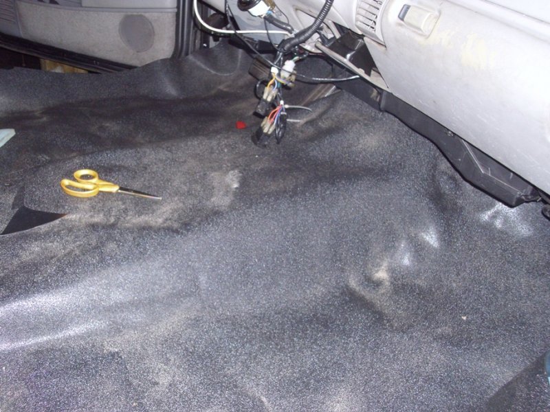

Carpet replaced with polyvinal 99 k2500 burb 001.JPG Carpet replaced with polyvinal 99 k2500 burb 002.JPG Carpet replaced with polyvinal 99 k2500 burb 003.JPG Carpet replaced with polyvinal 99 k2500 burb 004.JPG Carpet replaced with polyvinal 99 k2500 burb 005.JPG Carpet replaced with polyvinal 99 k2500 burb 006.JPG Carpet replaced with polyvinal 99 k2500 burb 007.JPG Carpet replaced with polyvinal 99 k2500 burb 008.JPG

The closed cell sleeping pads come in a variety of thickness and insulate much better! As the metal panels go do it right and don't look back. I find using salt neutralizer is the best defense against rust it can be had through marine supply and even eastwood.

If foam is not closed cell it will act like a sponge and rot everything around it. A good barrier like DuraBac or other bed-liner will increase quality of repair and complement the closed cell foam insulation or whatever else you decide on.
