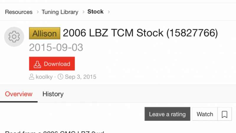

I have noticed that there is a bunch of files on the front/home page. Scrolling all the way, almost to the bottom. Latest resources.
Are those files for a tune ? Something that could be loaded into an ECM ?
I think one of them says for 2004 LLY without EGR or some such.

Okay. That is what I was thinking.
I see there is a factory tune for the 2006 GM diesel. One for the van and one for the trucks.
@rmlbzduramax might be able to download that file, clear out his ECM then load in the factory files.
If he has an autocal, that is a negative. The autocal can only flash what is sent to it by the V2 or V3 it is linked to sends it. Think of it as a handheld tuner, but it loads custom tunes from a tuner instead of canned tunes from the manufacturer.
