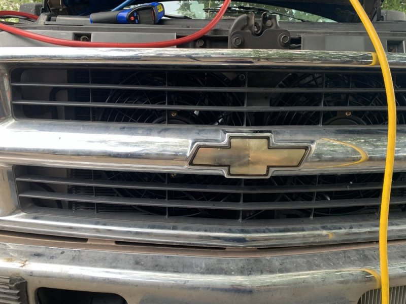

this weekend I pulled the front grill and installed a couple of 12” condenser fans despite having very limited space with the trans and engine oil coolers in there I was able to make it work! There wired in with a relay to the clutch cycle switch so there only on with the compressor. Photo attached with them behind the grill.

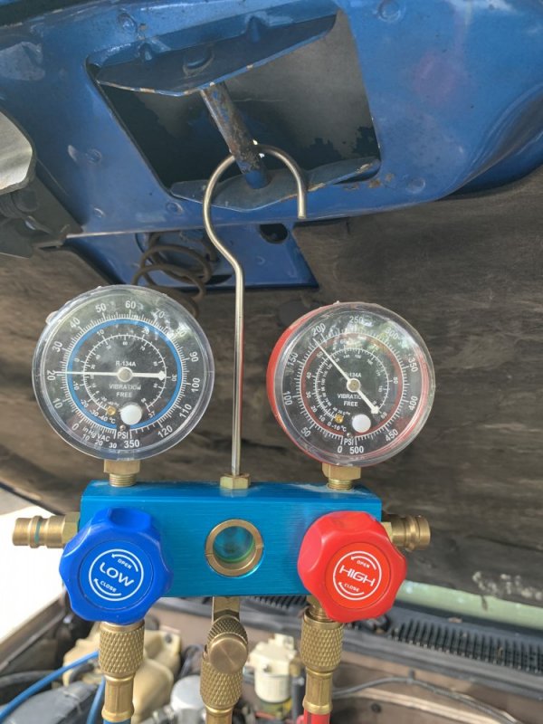

Today I ran the truck at idle for about an hour watching vent temps, pressures, and condenser temps. My recirculating door motor is broken so I wedged something in there to keep the door shut to circulate air in the cab and not draw in outside air. Now I have a evaporator freeze issue! It’s almost 90 degrees outside and humid today too.
Before I did all this. My low pressures were always about 35 with the high side at close to 200. Vent temps stayed at about 60 unless it was really hot outside then it was up to 65-70 degrees. After I got the fans installed in front of the condenser pressures stayed about the same but vent temps were at 55 or so. Now that I’ve wedged the recirculating door shut I’m seeing 32 degree vent temps. Pressures have dropped to 25 low and 175 high. Condenser temps and now equal across at 125 degrees and the evap water drain has stopped drain due to the evap beginning to freeze up! Oh and all this with the blower fan on high.
One tap of the throttle and the compressor cycles so I added a little less that half a can of 134 and no change in pressures or temps!

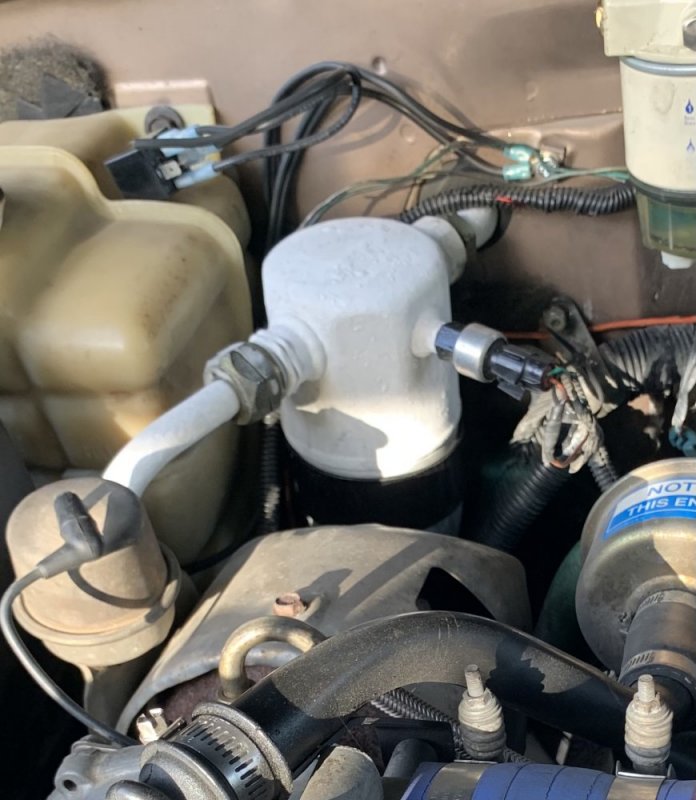

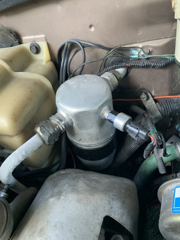

Quick and dirty: does the inlet and outlet of the evaporator by the cab feel about the same cold temperature? Is the accumulator sweating?
If the lines are not the same temperature it's low on refrigerant. Evac and recharge the system. Have a local shop do it real quick if you don't have the tools. Check the R4 compressor for any signs of a leak at the body o-rings.
If the lines are both cold: Likely replace the low side switch on the accumulator esp if it's not a R134a part.
Evac and recharge because unlike the engine there isn't a dipstick to tell you how much refrigerant is in the system. Low on oil the engine locks up. Too much oil and you likewise have problems with the engine.
Too low on refrigerant and the ( oil needy 2 stroke engine style ) R4 will debris glitter bomb the system from no oil return with the refrigerant. Too much and the system tries to boil the excess out of the accumulator till it liquid slugs the compressor. The actual "oil level" in the system is another level of voodoo: generally if it didn't loose any you don't add any say with a slow leak.
The low side switch should be for 134a. The truck is factory with 134. The evap “was” sweating its ace off before I shoved the recirculating door shut. Then it froze! I have my gauge set and a vacuum pump but not a scale to charge by weight. I know it’s not the proper way but I had charged it by quantity adding up the ounces on the can and the sticker that was in the old dryer, also watching the gauges. I’ve done that on many different vehicles and not really had issues when there wasn’t a restriction or what not

I connected my laptop to bump the idle to a grand while I watched the system. The compressor began to cycle off and on about every 30 seconds but while running the high side never went over 200. Then I noticed the lines from the evap to the dryer and out from the dryer began to freeze. No air restriction in the vents yet but damn it’s cold inside the cab!FF4D1E32-4898-4B42-87FD-D38810A7D8F6.jpeg08CDE830-9995-4540-BC4D-FCF933AEEE6B.jpeg

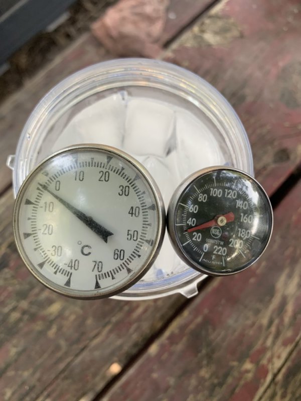

Just to make sure I wasn’t shooting myself in the foot. I grabbed a kitchen thermometer and a glass of ice water. Well the one I was using in the dash reading Celsius was off by about 3 or so degrees. I’m rechecking vent temps nowD4B86233-506E-4B48-9B79-8B6E60A303FE.jpeg
Using the kitchen thermometer and recalibrated mine. I’m at 40 degree vent temps. Me like this! Hope my wife doesn’t jump on the truck with wet hair!! She’s gonna have icicles on her head 😂
Leave it alone at this point! The ice on the outlet of the evaporator indicates it has enough charge. If and only if the airflow stops from ice build up then replace the low side switch on the accumulator.
Ok I need to back up a minute. I turned the blower speed down to low and watched the vent temps. It slowly crept down to 38 degrees and now my entire dryer has iced up so has the line to the compressor but not all the way to the compressor yet.
I had to stop and think about what I’ve done up to this point. Blow out condenser and radiator, installed two condenser fans, then it started acting like it was low on Freon. So I added 1/2 a can.
Oh and forced the recirculating door closed.
I let it run a little while longer and finally the compressor cycles at 20 psi. I did this making sure my relay wasn’t back feeding into the compressor keeping it on.
With the dryer freezing over. Is this a problem?

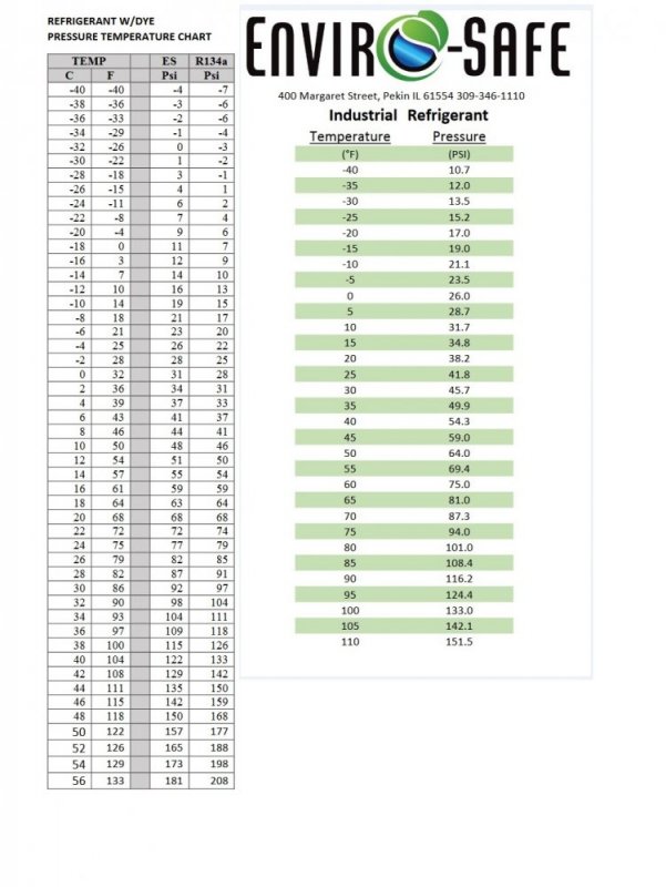

@Will L. Not much difference in refrigerants at -5C see "propane" R134a comparison chart below. We have lots of fan going on, engine RPM, and a questionable charge level. Clearly the evap is not a low charge as the outlet is also icing up. I have seen this ice up before on a perfect system when conditions are just right esp. "high idle of 1200+ RPM".
