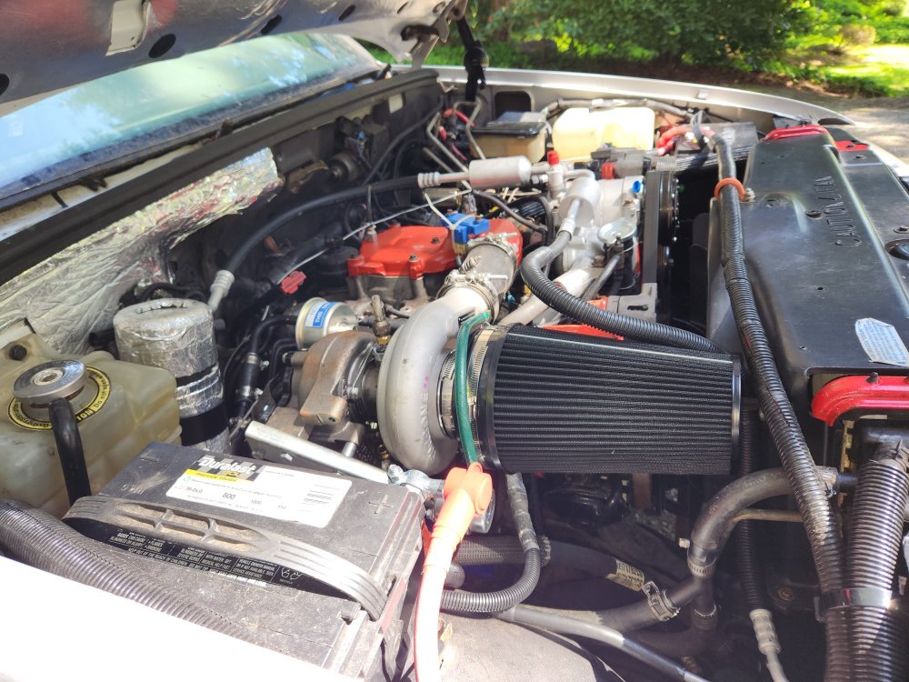

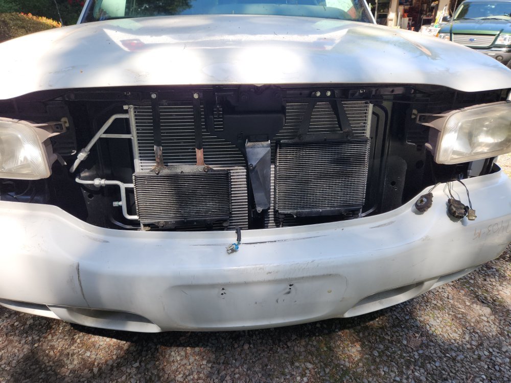

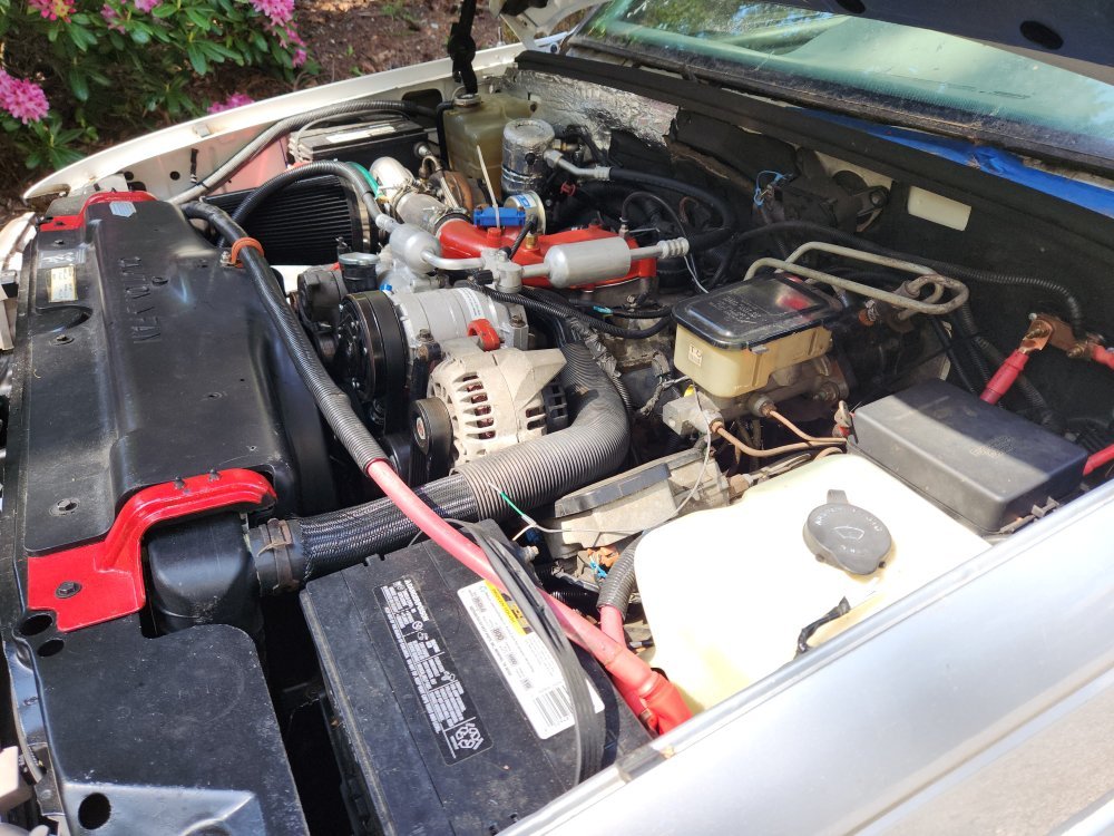

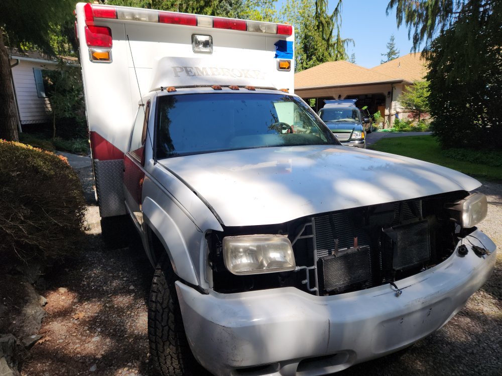

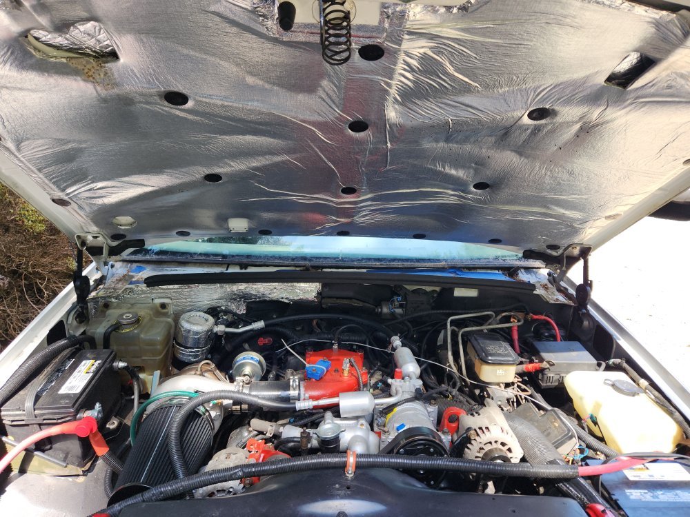

Here it is. There's more work to do but I don't have enough time to finish it. We are selling the house and moving and I won't take Rachet with me.
