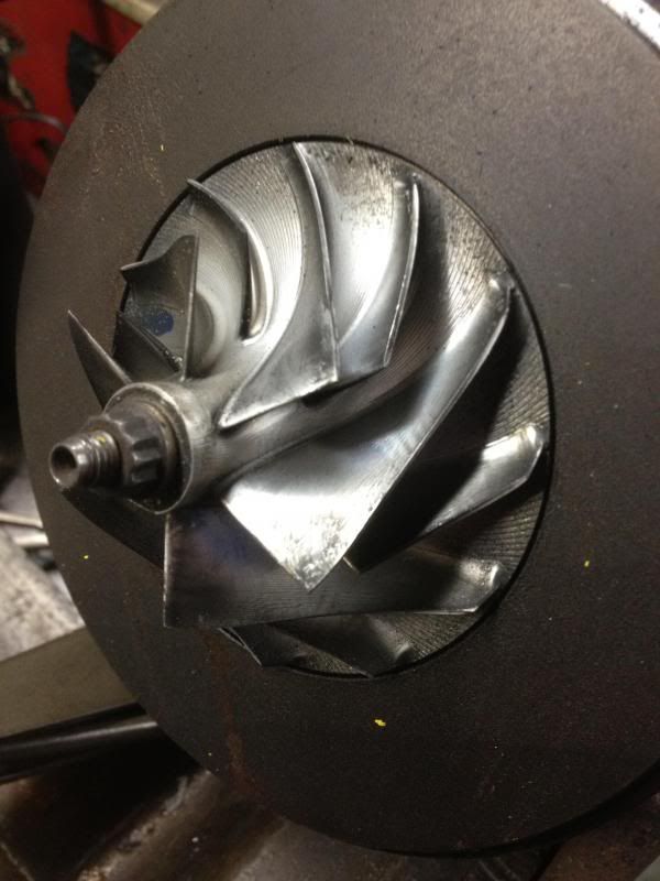

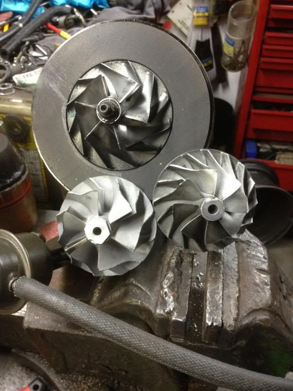

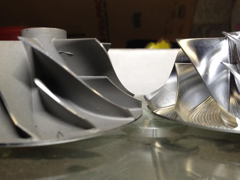

I already have a factory billet 6 blade 56mm wheel but always wanted a billet 60mm wheel so I treated myself and bought this. I started off with a 7 blade HX35 wheel, then put the 6 blade on, made a noticeable difference in spool, more peak boost, lower IAT'S, lower cruising boost and lower drive pressures without touching the fuel, so I'll note the difference with this one.

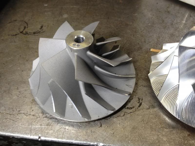

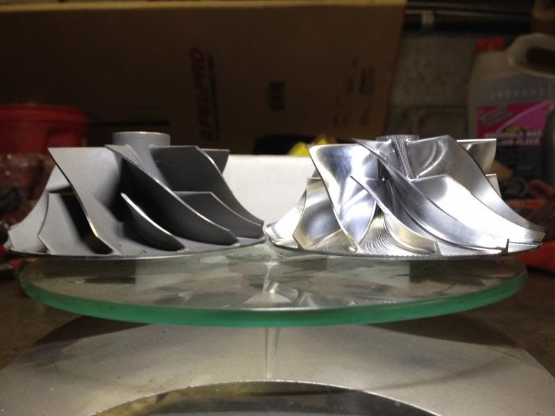

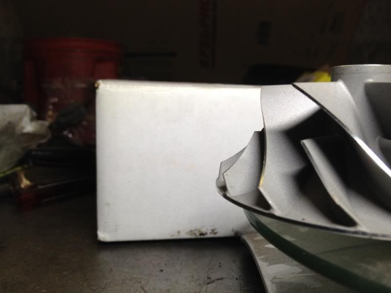

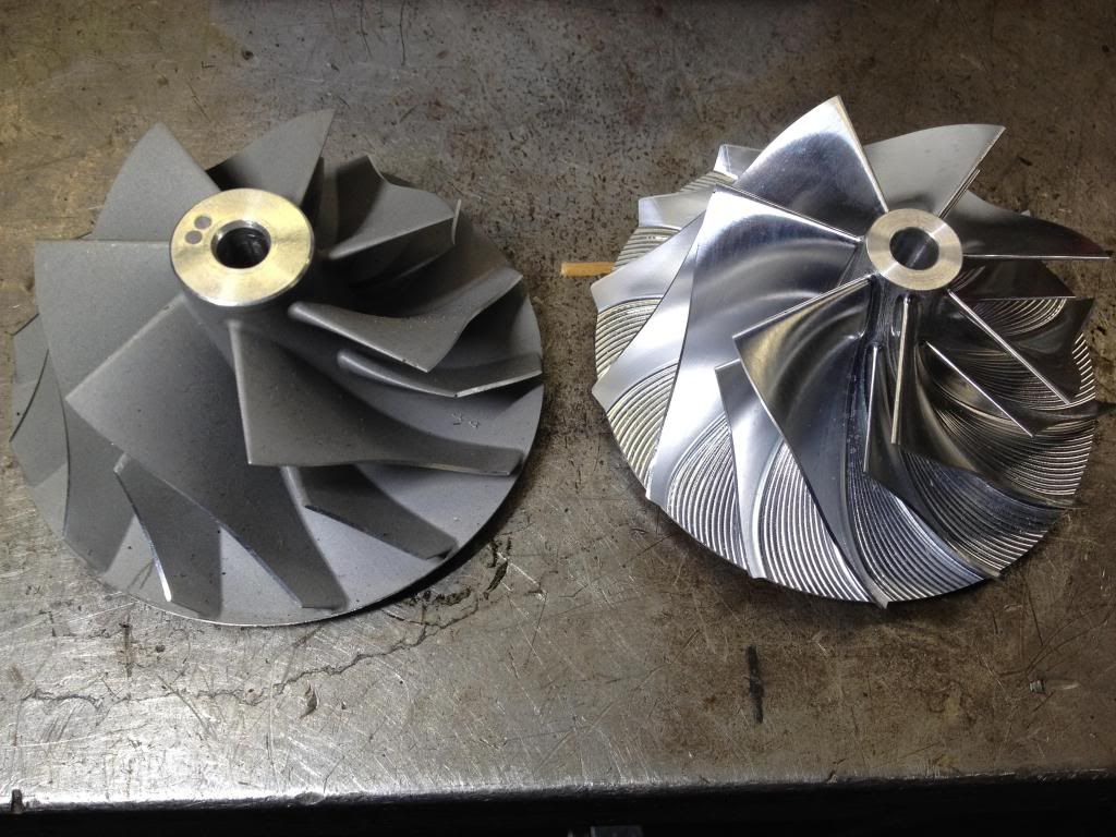

I bought a cast 60mm wheel, I was going to put that on but this came up. Compared to the cast wheel, they are both 60mm inducers, the exducer on the cast is 84.6mm, the billet is an extended tip at 90.2 mm, total height is higher on the billet and weight wise, 14.2 vs 12.5.
