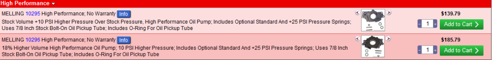

Ok guys, I am putting together a parts list for it, I was looking on RA for oil pumps. as @Rockabillyrat was saying about a high pressure pump I see there is a couple of different options available. I am curious which is the best one to go with here. I am assuming to go with the Melling 10296 pump.

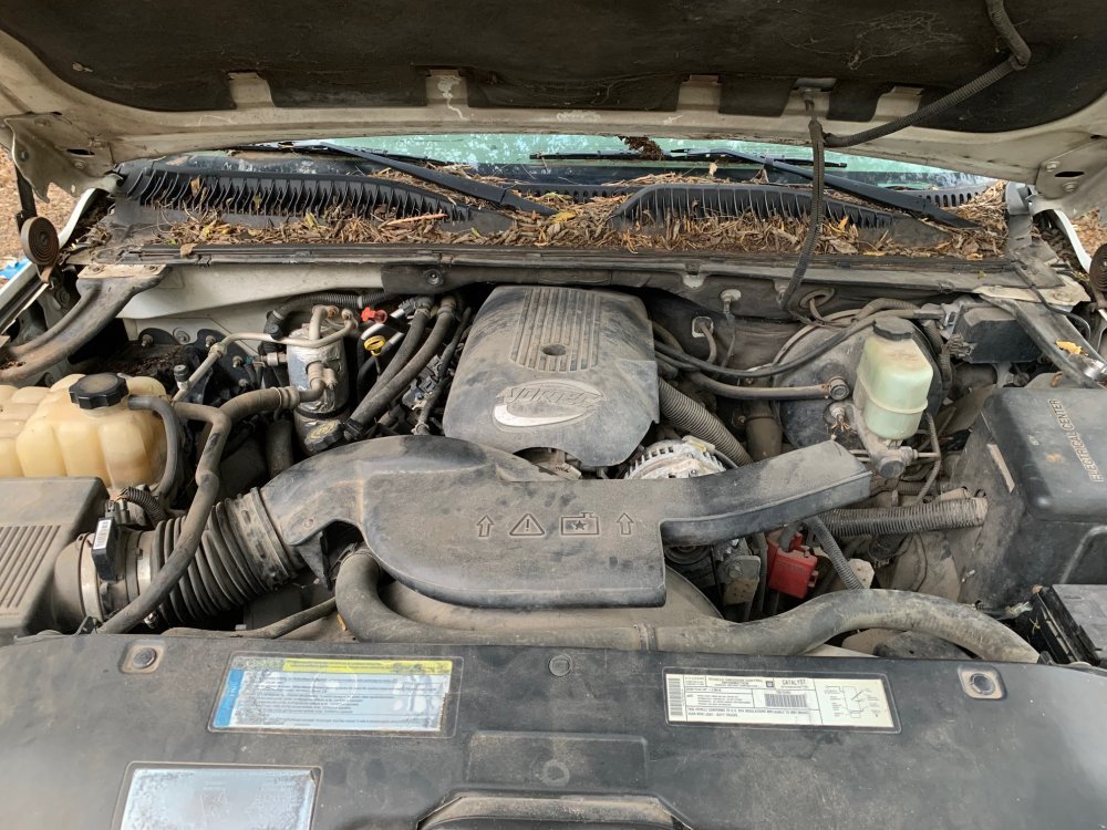

Today I went out and gave it a good look. the whole engine looked really clean other than I can see the end caps on both sides of the fuel rail that connects the fuel injectors are leaking fuel. not sure what to do there.

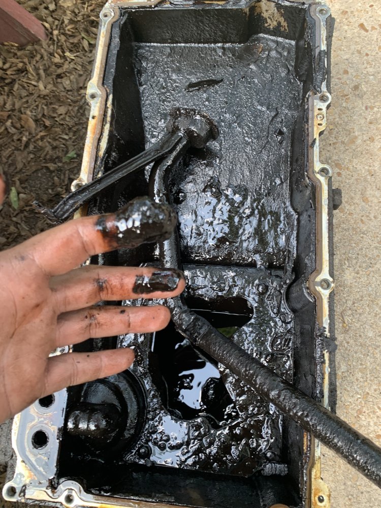

now I will attempt to tackle the pan removal. One thing I noticed is that the oil filter is attached to the pan! I went in to take a break and look up a photo of the pan gasket just to make sure there were no bolts behind the trans bell housing. from the looks if it, there isn't any.
curiosity got me thinking and wondering if the pan gasket could also be a cause of the oil pressure drop outs since the oil runs though into the pan to the filter and back into the engine. anyhoo I will find out soon enough. About to try removing the pan to get a look inside for some inspection tonight.
that sludge was over an inch thick in the bottom of the pan! we called the previous owner (distant friend of the family) and asked her where she had her service work done. she informed us that she always took it to Bradzoil on a regular basis. they use Pennzoil exclusively. Well this is another look at what Pennzoil does to an engine even with regular changes!
Sad.... I know this thing has seen it better days already but he wants to try to push a little more forward. we talked a bit and discussed the cost of putting another engine spending up around 2k for a decent used one or a rebuild spending up around 4k or more. given the fact that it's paid for and all. also taking into account what it will take at the bare minimum to get it registered and on the road. needing new tires, shocks (one blew up sitting here oil leaking all over) also finding that the fuel rails are leaking. I figured at minimum if this engine runs again it's gonna take at least 1k to 1200 to put it on the road.
So the plan is now to clean out the pan, and pickup tube (if that can be cleaned) also clean out the cover that is between the pan and the crank, put it back together with fresh oil and see what the engine does. I mentioned that for this engine the best thing is to pull it out, open it up top to bottom and clean out everything. new bearings, pump, timing chain and all but I couldn't guarantee it would work or be worth it in the long run.

I'm not sure what to do on the fuel rails though. I need to see if there is a fix for them or if this is also a common problem leaking fuel out the end caps.
