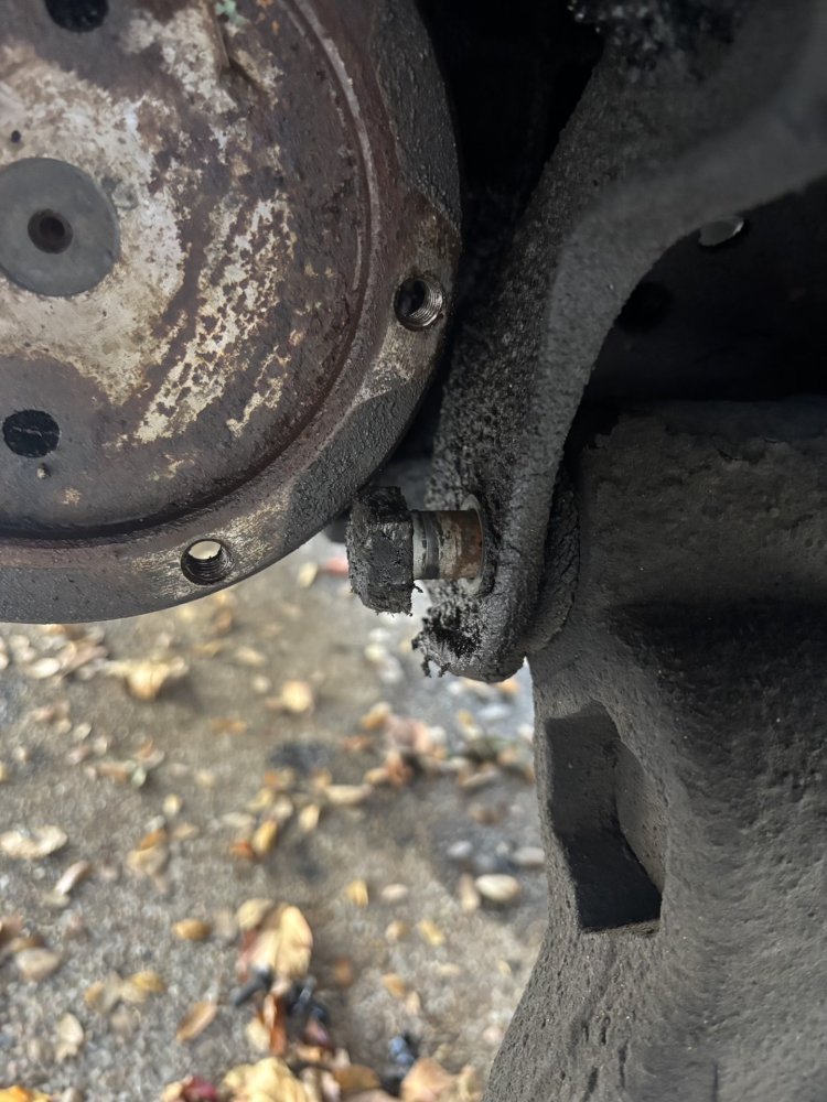

I undo and drop/lower the front diff until you have enough clearance to pry the diff towards the passenger side which gives the clearance to remove the bolt. Reverse the bolt direction when you reinstall.
Yes, it is not going back that way. I did not feel like messing with the front diff, yet! It does need to come out for leaks.
