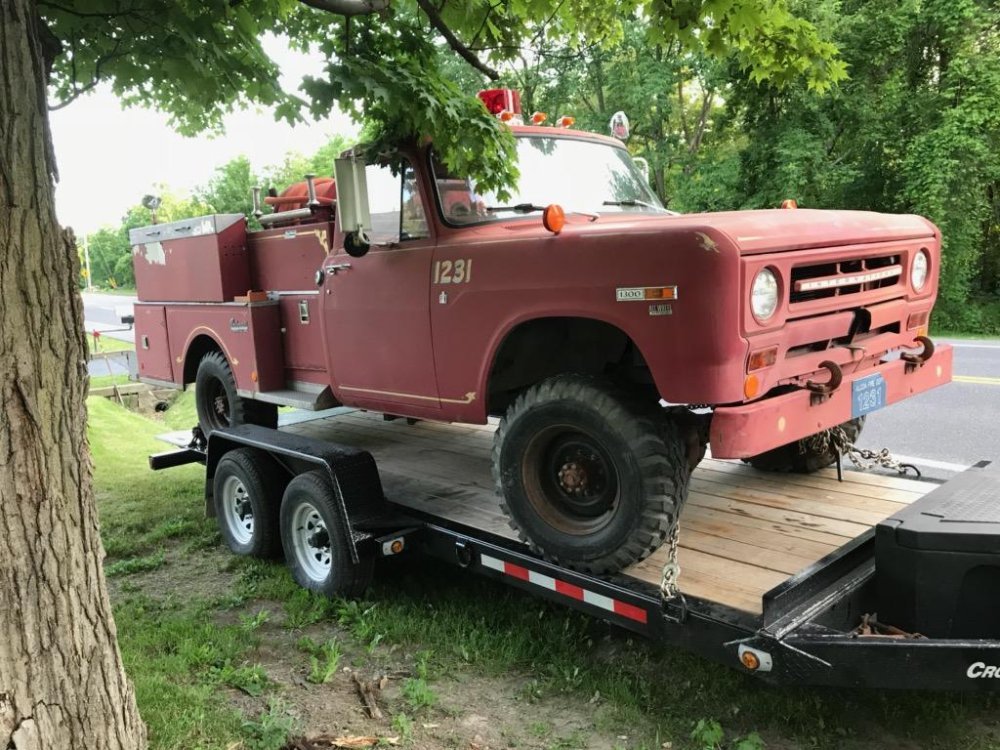

I assume your truck has a goose neck option, even talking 16-foot that is short for the truck, you will be hanging over and chaining down will be a pain (I put my 69 IH 1300D on our work tilt deck thats 18'). Boy was that ugly.....
You need at least a 20-foot utility/equipment trailer. Goose or bumper. Some options to think of is deck overs are easier to not deal with fender wells, but its also that much tougher to drag a dud truck up that high. Tilt decks and fendered trailers are much lower but you need to make sure your narrow enough to fit through the fenders. Looking at the truck with stock tires and being 2wd, you will be narrow enough. That truck needs to run long enough to drive onto the trailer, that will save you tons of headache. Otherwise you need a winch on that trailer. Make sure you bring 4 good car tie down straps or sets of chains and binders.
Total gross weight will be around 8K for your truck, 3K for trailer, and 8K lbs for the other truck, still under the 26K by far so I wouldn't worry (that's the law here too, but I have a CDL so I can go to 80K with proper trucks)

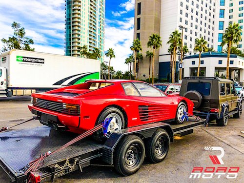

Completely agree that the trailer's safety chains need to criss-cross. But that is not the focus for securing the load.
Am talking about the tie-down straps (the ones from either the wheel or suspension to the trailer) which hold the load (in this case, the vehicle).
Here is an example of the correct way to run the tie-down straps (red / black stripe in photo) where they attach to the same side of the vehicle and trailer.
The incorrect way secure a load is to criss-cross the tie-down straps so that they are on opposite sides of the vehicle and trailer. While the criss-cross method is popular, it can add to the misery in the event that one of the straps fails from stress.
Oh, one more thought if the decision is to go with a flatbed trailer. Check the tire stance on the vehicle, and distance between fenders on the trailer. If it is the GMT400 SRW, best is to load rear-first as the rear axle is shorter than the front. Where this effects loading is that a trailer's fenders might not have enough room for the front axle, but will for the rear. As a real world example, I have a trailer similar to the above photo. When I bought the Burb, I had to drive over one of the fenders as the tires simply would not squeeze between the fenders. 4WD Lo came in handy that day. Had I known at the time about the axle length difference, I would have backed the Burb on to the trailer.
